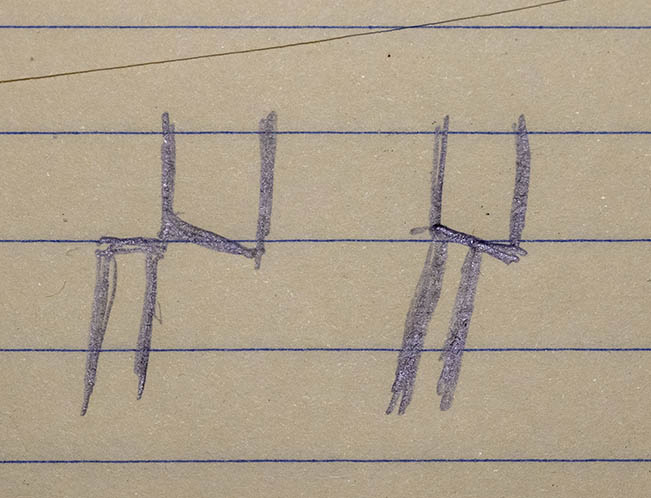

I posted picture after I worked on the liner in post #17. You don't read and you just BS. Yes, I answer my question that the diagram (b) is the correct way.

I can tell you I look at the liner lock of a few knives that have not been touched, they all have the angle like in (b) of the first post. Do it the opposite way at your own risk. Don't cry if the blade collapse on your finger.
Frame lock is better if you hold your knife tight as it WILL push the liner lock towards the right more and further secure the blade. I don't think you get this simple idea because you NEVER even think of this.

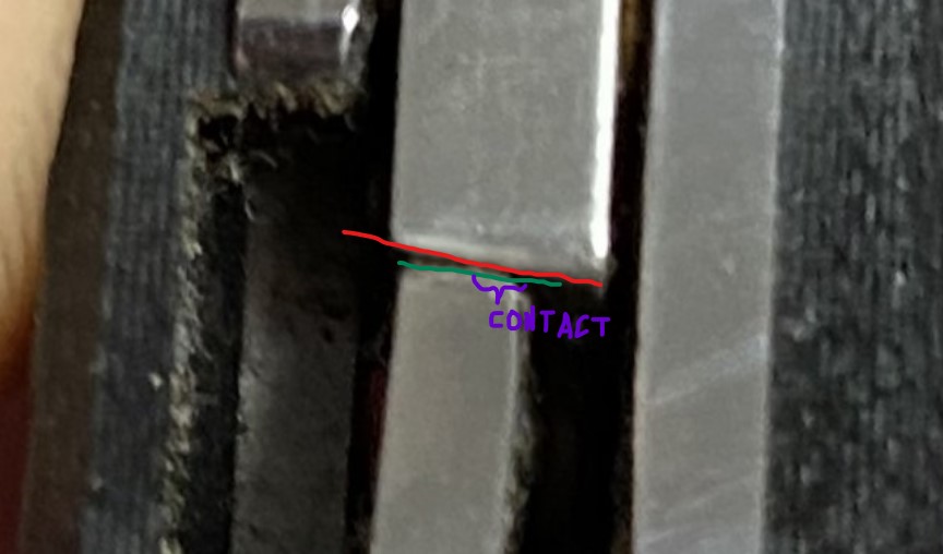

Actually I looked at you pictures carefully. Two of your pictures agree with my finding. The angle of the liner is not extreme as my drawing in (b) of the first post. BUT the idea is in agreement.......That the contact is on the left side and you can see a tiny gap on the right as shown:
You can see I draw the line of the Tank in RED, the surface of the liner in GREEN and contact point in PURPLE. The contact is on the RIGHT side like my conclusion.
It is good that the whole width of the liner is under the tank. I saw some knives it's only like 3/4 way in. The more important thing is NOT the position AFTER you deploy the blade in normal way. Try moving the liner to the RIGHT and let it go and see where it stop. You'd be surprise it does NOT return as deep under the tank as if you just deploy the blade. That is one thing I have not yet talked about so far before getting into all the argument. That's also I spend the time to work on. Mostly by bending the liner out a little. It's a balance between how strong the liner push to the right vs ease of deploying the blade. If you bend too much, it's harder to flip the blade open because of the stop build into the knife that you need to push the flipper tap much harder to deploy the blade.
I did examine two knives after I initially posted the thread. I looked at the wear mark on the surface of the liner lock. The wear area is on the left EXACTLY at the part shown in PURPLE on the left of the liner lock. That's why I know that's the correct way.
If you grind the the liner to follow the angle of the tank or even more slanted to the LEFT, imagine something sliding down on a slope, it's easier to slide. You want to make the contact point smaller so you get more pressure in the small area(under PURPLE) and create more friction. This is how I look at it and decide to grind it like (b). Of cause the drawing of (b) is EXAGGERATED. In the real liner, it's just very slightly slanted.

You can see I draw the line of the Tank in RED, the surface of the liner in GREEN and contact point in PURPLE. The contact is on the left side like my conclusion.
It is good that the whole width of the liner is under the tank. I saw some knives it's only like 3/4 way in. The more important thing is NOT the position AFTER you deploy the blade in normal way. Try moving the liner to the RIGHT and let it go and see where it stop. You'd be surprise it does NOT return as deep under the tank as if you just deploy the blade. That is one thing I have not yet talked about so far before getting into all the argument. That's also I spend the time to work on. Mostly by bending the liner out a little. It's a balance between how strong the liner push to the left vs ease of deploying the blade. If you bend too much, it's harder to flip the blade open because of the stop build into the knife that you need to push the flipper tap much harder to deploy the blade.

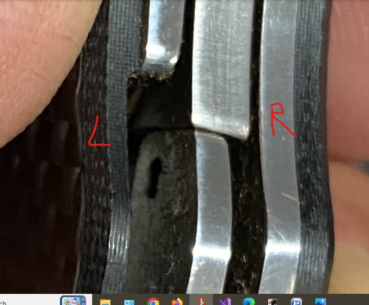

Also, I need a bit of help understanding what is right and left by your definition. I see contact on the right and the small gap on the left.78F3E850-68D3-43FB-A2A9-BA4A3A5D6B5B.jpeg

Also, I need a bit of help understanding what is right and left by your definition. I see contact on the right and the small gap on the left.View attachment 1994635
Ha ha, it is literally the left of the picture or the right side of the picture. Here is the picture I labeled L for left and R for right.

Yes, that's how it should be, The liner is cut straight and the bottom of the blade is slanted down from LEFT to RIGHT in the drawing. So if a straight level liner touching the slanted bottom of the blade, the left side of the liner surface it the point of touching the bottom of the blade like what I've been talking. Drawing (b) in my first post is greatly exaggerated. The idea is the same.
