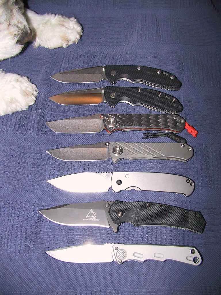

Anyway, here are the semi-finalists...
I hired a relatively inexpensive local consultant to assist, and she is pointing to her (and my) top 3 picks in the shootout:
But then she got bored with the project and started slacking... motivated help is hard to find, especially on carpet in the A/C:
