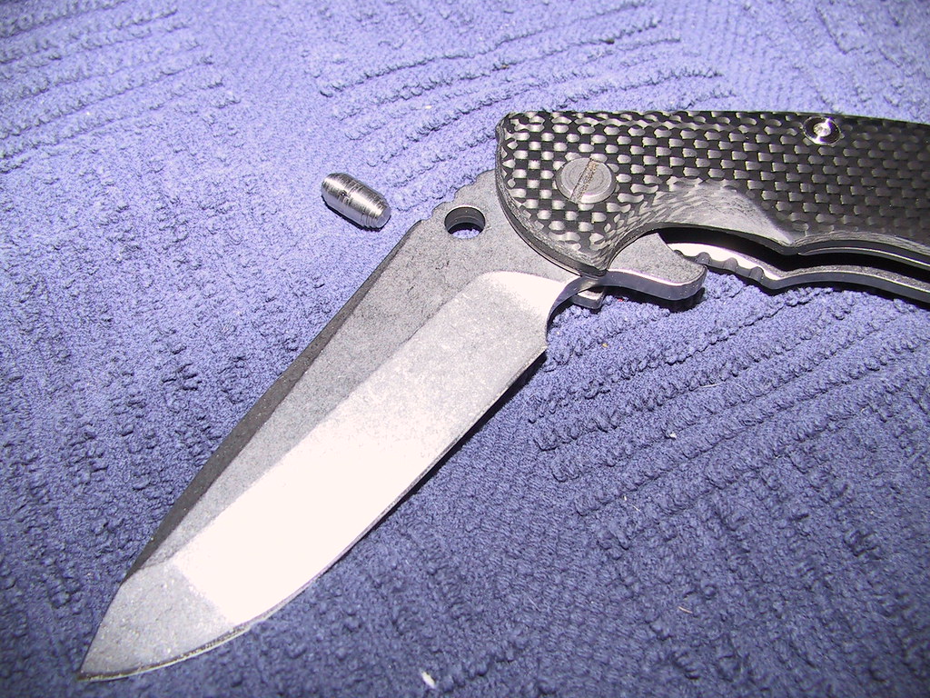

Uh oh... looks like one of my "hard use" folders has a press-fit thumb stud. I discovered this while... wait for it... slicing open the back of a pill blister pack. The thumb stud just popped out. Not exactly hard use.
I kinda assumed these were threaded pieces... male one side, female the other, and threaded into place on a shoulder, w/ threads slightly locked down w/ e.g. Loctite. Not so. Press fit. And I didn't even press hard, ever. It is a "new-to-me" knife.
I guess I'll have to find a good metal-to-metal adhesive to keep the Hinderer thumb stud in place. Expensive little machined part to lose in the field... and the resulting "Spyder hole" isn't exactly large enough to use for blade opening.

yikes! never seen that happen before, and more importantly it is the stop pin.
dig the homer simpson!
yikes! never seen that happen before, and more importantly it is the stop pin. dig the homer simpson!
Indeed... it is a stop pin, and w/o, the blade has a huge amount of play. Makes me wonder how the CRK Umnumzaan and Strider's are secured.
That was how I first noticed... I thought "man, what happened... a bunch of play in the blade... is the pivot loose"... then I see the hole... WTF?... then see the stop pin laying on counter.
Anyway... not a killer, just a surprise. I suspect all of his semi-production pieces are this way. Maybe the "custom" ones too. I'll dig into a metal-to-metal adhesive suitable for the task, and post here once I figure something out. It's remedy-able (izzat a wurd?) but a surprise.
the strider stop pins are press fit and i think an adhesive is applied.
i had one of those fall out of an smf that was basically brand new.

Just PM Rob or Rick and drop a few bucks on the postage and get it fixed right. I thought the stop pin was the pin that is inside the knife handle toward the front? Anyway, send them a link to your post. Just sayin...:)
For the OP: Strider, Hinderer, Demko Custom and what about the ZT 0551 and ZT 0550 (coming) and the available ZT 0301
Some knives don't have a stop pin in the handle. Examples would be DDR Maxx, Microtech Socom manual, and ZT300.
I've heard of the pin I'm referring to as a blade stop. It rests against the finger choil on the blade. I thought it might be a stop pin. I don't know for sure though. The XM-24 has it straight across and going into both side of the Ti liners. :confused:
I think he should send it to Rick for fixing though. I would, pricey little devils. :)
that little pin inside is to prevent the blade from closing too far and the edge from contacting the stand offs.
the stop pin on the blade hits the scales when opened, and also acts as a thumbstud. without the stop pins, the blade would swing freely beyond 180 degrees.
