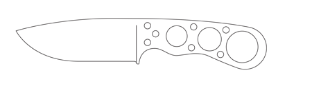

Here's my entry.The Tool!(I got the name from Proturist,he once described JK knives as working tools for working tools.Thanks for the inspiration Mack,very fitting IMO.)
1/8" stock.
Saber grind with or without heat scale left on the flats.(I like it myself)
9 1/2" OAL,W/ 4 1/2" handle & 5" blade.(I went with a 5" blade for a little more room for a baton or extra penetration in a defensive situation.)
Jimping for the thumb.
3) 1/4" pins(brass please)
Exposed tang with a 3/16" lanyard hole.
Divot in tang for striking a fire steel.
7/8" thick handle tapering towards the front to say 5/8" & 1 1/8" high at the butt to 3/4" at the lowest point in the belly.
Good luck everybody,so far I've seen some designs I wouldn't mind having myself so if mine doesn't win I still win,hehe.

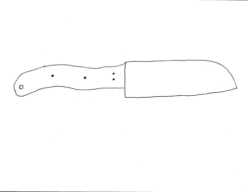

ok guys...i wanted to switch it up a bit. but, with that said....i REALLY want a set of JK Steak Knives! Forgive the "sketchy entry." (Get it!?!?) Yikes. time to get a drink and watch the bruins.
Whoops. i see i made a mistake. the rosewood handle was supposed to say ironwood in the drawing (i would be ok with any dark, dense wood with reddish hues).
