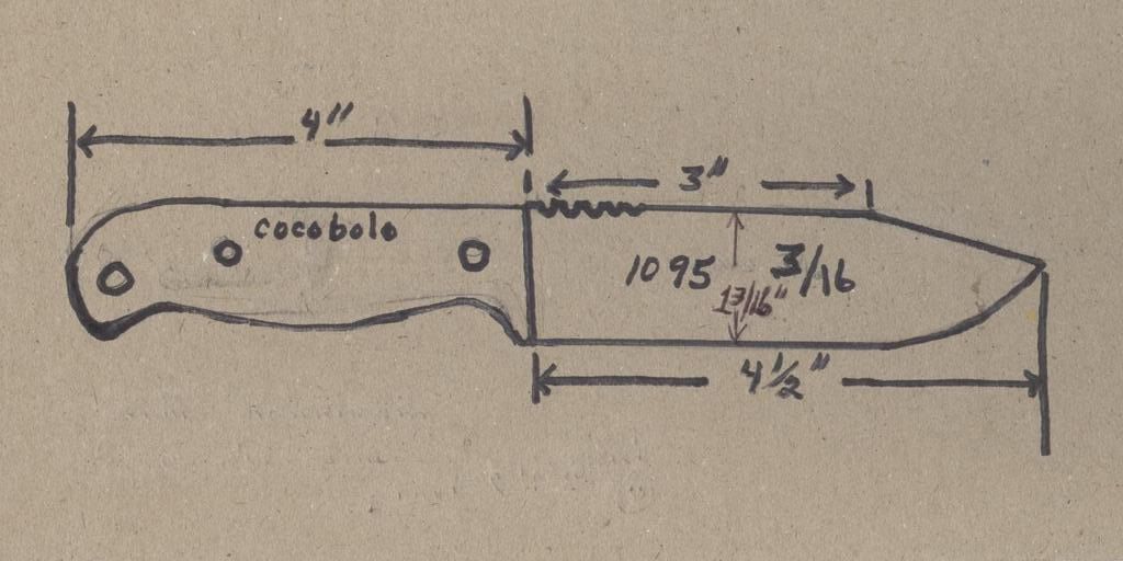

Great! Here's what I came up with. I believe that most designs are derivitive of other designs, and this is no exception. It's a blend of a number of knives I like. Many could probably see a Skookum, Aurora, Stomper Bushcrafter, Stomper Straight Back Hunter and maybe a touch of Laconico in for good measure. I imagine that it would be great for bushcraft, hunting or most anything you would throw at it. It's pointier than your Tank and Hiker but there's a bit of those thrown in as well.
	I'd prefer it in 1/8" 01 with a convex edge, thumb grooves, hollow pins and some sort of hard exotic wood, maybe wenge, contoured just a bit, but not too much to dictate how it must be held.
Finally, I think it would fit in well within your designs. It's not revolutionary, but practical, good-looking (if I do say so myself) and somewhat of a hybrid of your existing designs. Hope you like it!
