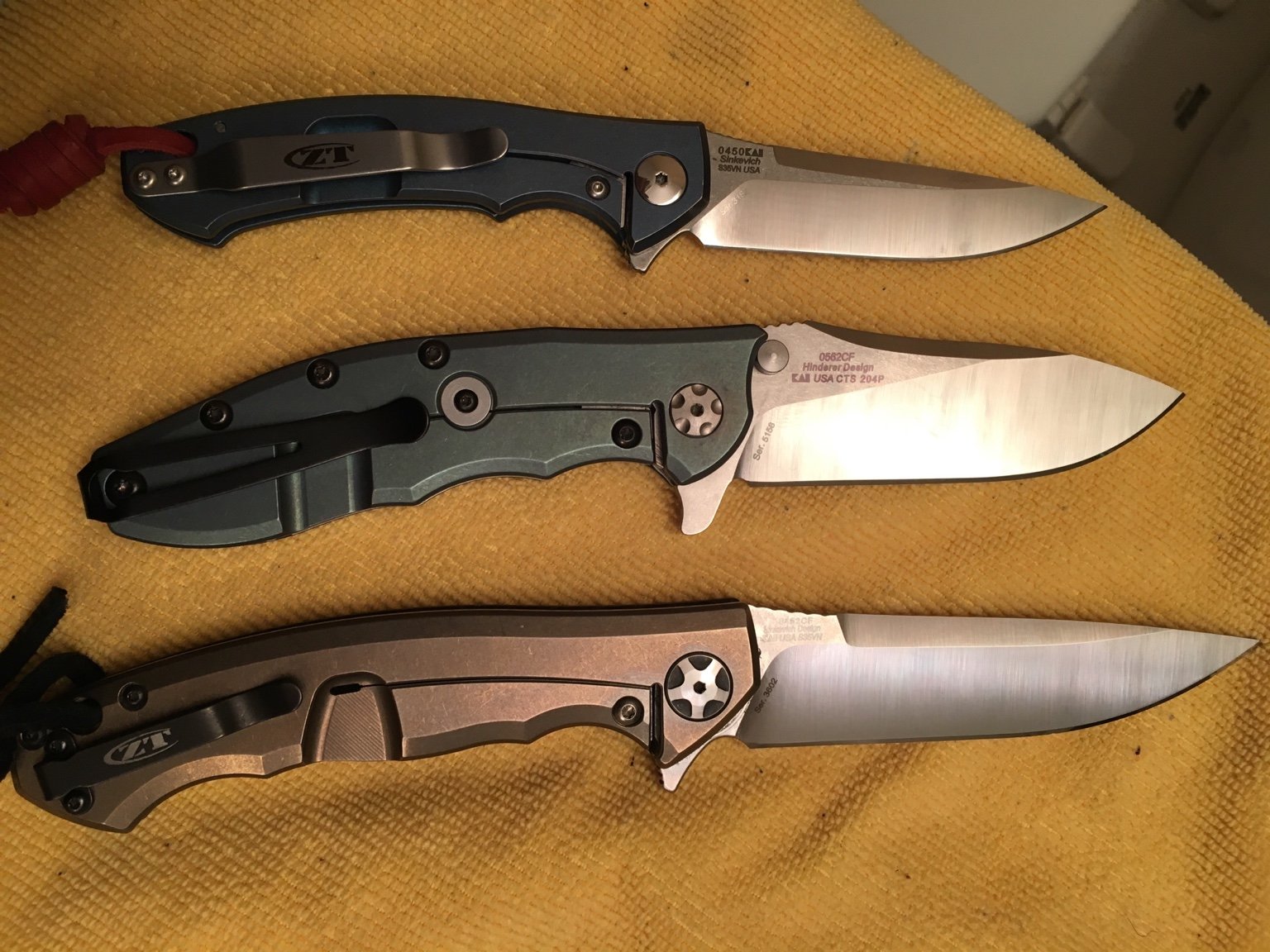

I really like it, when it's done well.
Scott from USAmadeblade did my 3 ZTs bout a year ago. Have carried all of them plenty and they still look great!!
Joe
Better pic of the 450.
Those DO look great. Very nice.

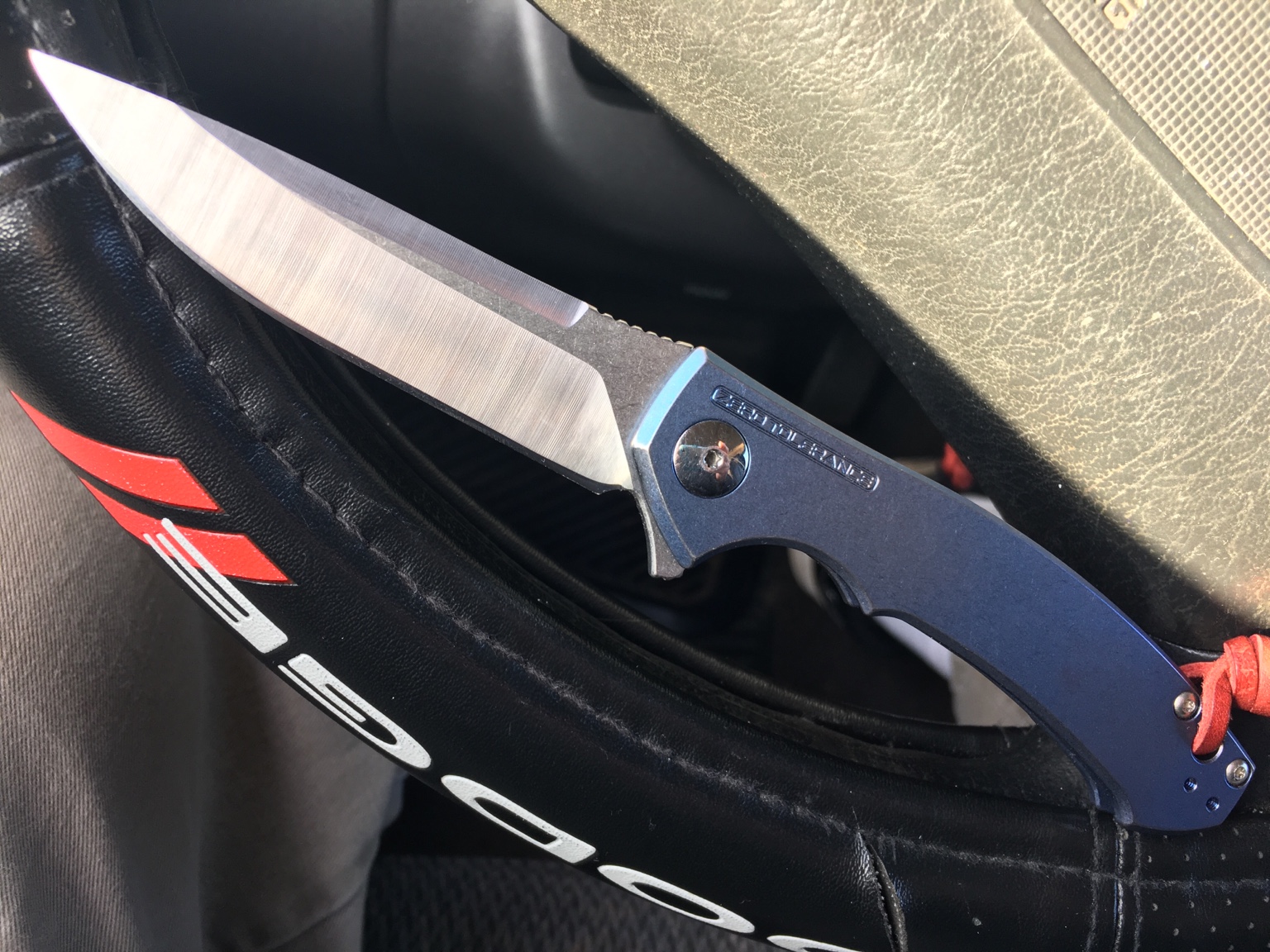

My first black titanium.
The finish is pretty frickin sweet. I think the whole knife is titanium coated, maybe even the really awkward and weak clip. Pretty amazing finish. It's just so black.
