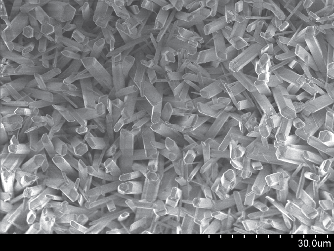

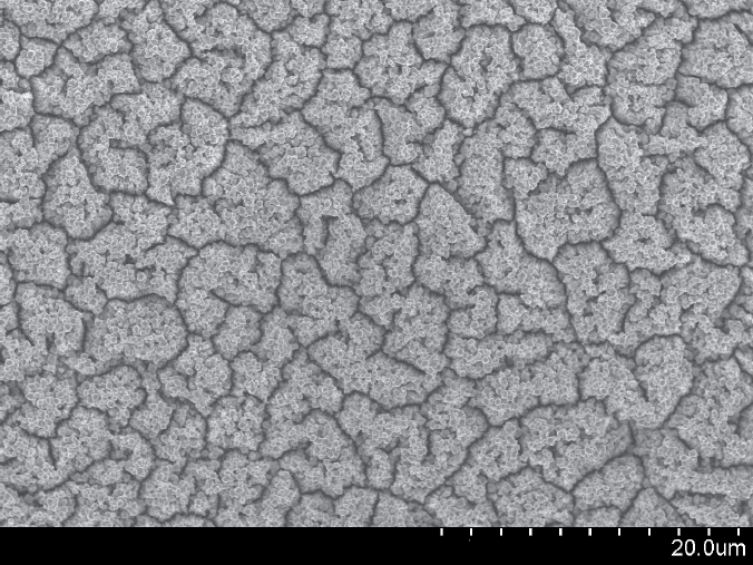

Anodizing Ti does not actually change the color of the metal ..., (probably will loose a few here ...) it merely deposits TiO2 in a crystalline formation to the surface (pic's attached below illustrating). The thickness of the crystals affect the light color(s) reflected from the surface so as to produce colors much the same way a crystal reflects light and various colors of the rainbow. The depth of the light reflection through the crystal affects the color you see. As the surface deposition thickness (on a Ti handle scale) increases the color of reflected light changes.

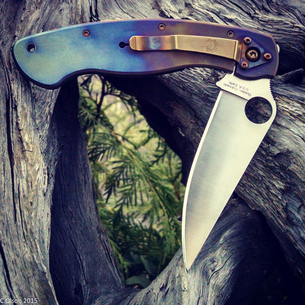

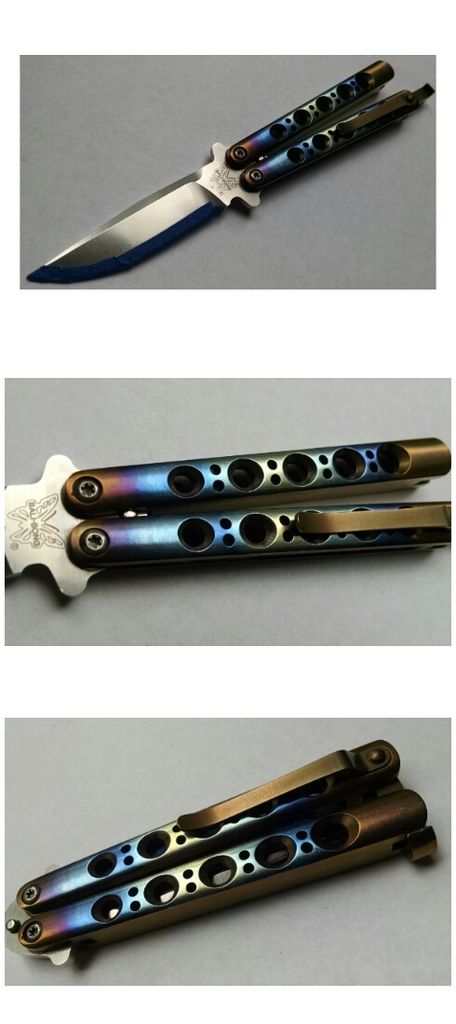

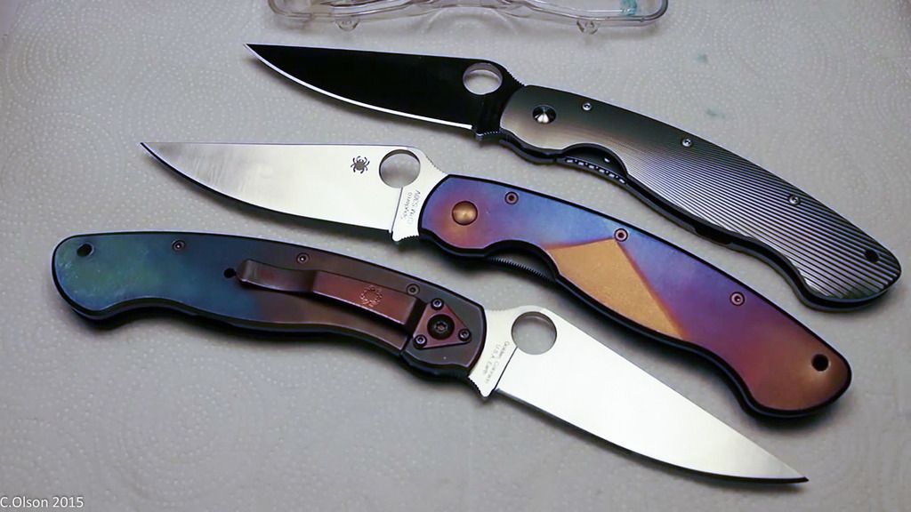

Few examples (anodized Titanium) showing various colors through the voltage range (personally I like natural blends of color range).
(the middle knife below was NOT done using stencils)
and here's a couple pic's showing the actual crystalline structure under magnification:

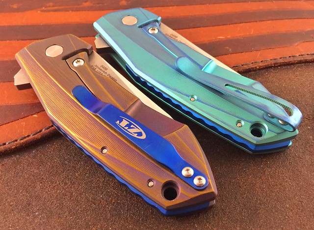

Those ZT 0456s look incredible, especially the greenish one.

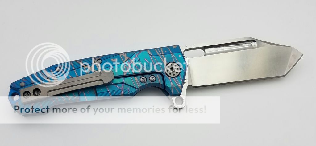

Any major difference in the look of the finished product when you anodize bead-blasted versus non?
Matt (mattal21) from the G&S forum took this plain Nadeau Typhoon and really made it pop with his work. Fast turn around too.
