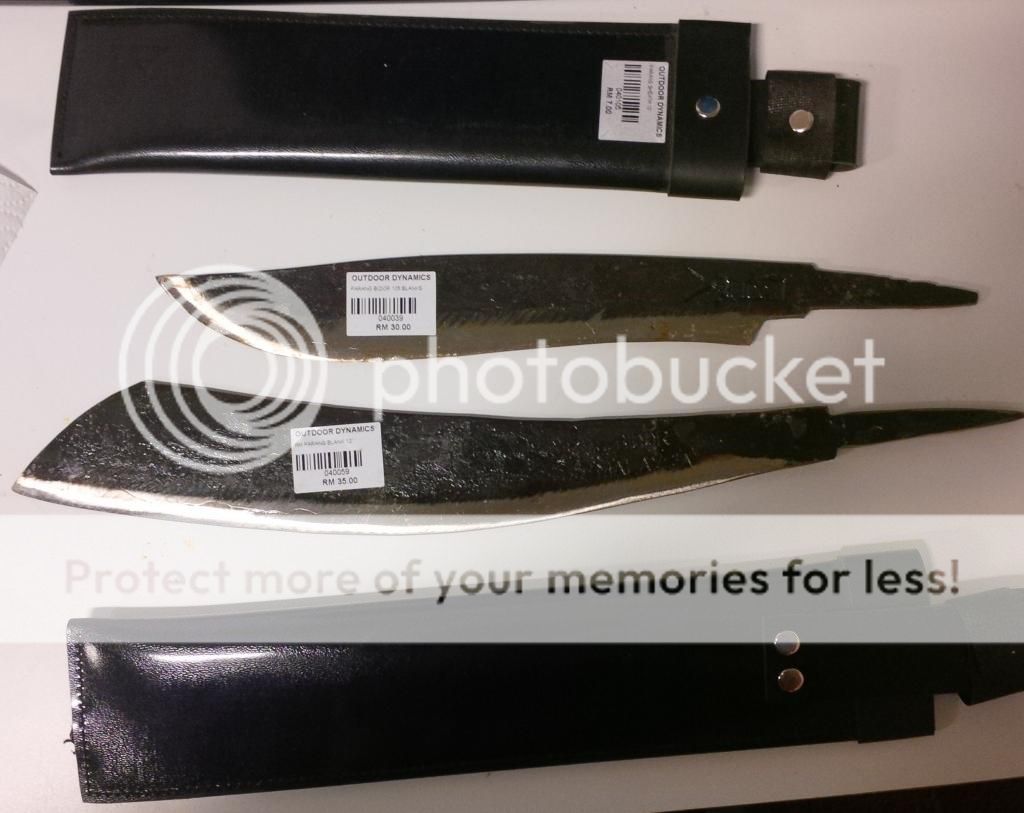

FYI, even though both are parangs but rightfully the top one is categorized under Golok Rembau.
While the bottom one is categorized under Parang Lading Pendek (i.e. some people in Malaysia just called it as Lading Pendek).
Hope this helps you and other forums members to be able to refer those parangs with the correct terminology :)
mohd
Thank you for the correct terminology, mohd. Half the fun of buying these things is figuring out where they fit in the whole parang/golok/klewang/etc spectrum. The site I bought them from called the small one "Cap Pedang". I thought a pedang was a golok-style sword? They call the bottom one a "Ray Mears Parang" after the bushcrafter who popularized them in the west. I'm not suprised you call them something else over there :) I read the Bidor factory where these are made is rather modern with proper forges and whatnot. There's another website where you can buy "village made" parangs and goloks made with hand powered furnaces, but I haven't been able to get in touch with the guy.

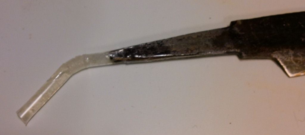

As you can see, this time I used a bendy straw so I could get a more traditional handle shape. It's been curing for about 16 hours but it's still bendable in the "flex" part of the straw. Hopefully it'll fully harden after 24 hours have passed. I don't know if you can make it out in the picture but there's a ton of bubbles in the epoxy. So far I'm not too impressed with this gorrilla glue epoxy, but I'll give it a full 24 hours to it harden and see how it turns out.
In the mean time I'm going to experiment with micarta colors. I'd like it to come out more natural looking than my previous attempt. I think I still have the epoxy dye from the acraglas. I'm thinking brown dyed epoxy with white fabric or black fabric might look good, sort of like a burl wood.
Man aint you slick! A Khukri straw:thumbup: Might look good with mixed white, brown, and black colors. I think its a good idea to use the acraglass dye. I do like the "Ray Mears" blade a lot!
Well, the gorilla glue epoxy straw never hardened. I was able to pull it off with my fingers. I'm assuming I mixed the epoxy wrong.

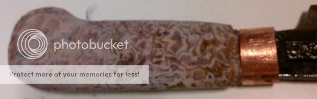

Whoo boy... Turns out I didn't have any acraglas dye left so I used some brown rit dye. It turned the epoxy pink. So my knife has a pink handle now. Other than that the casting acrylic resin worked quite well. I think it's more or less the same thing as acraglas. It's just as thin as acraglas, much thinner than the two part epoxies you get at the hardware store. The mixing instructions are virtually identical other than mixing equal parts resin and hardener. It seems to have bonded well to the metal, but this stuff is not meant to be an adhesive so I don't know how it will hold with hard use.
The other big problem is that the copper bolster shifted while the micarta was hardening so now it's crooked. I don't think I have to start over, but I'm going to have to do something drastic to fix it.

I think I'll seal the handle with a top coat of resin when I'm done, but I'm worried that would make the handle too slick. Right now it's very grippy, but I think the exposed cotton will absorb dirt/sweat/etc unless I seal it off. I think my method of making micarta isn't making "true" micarta because I'm not applying enough pressure to drive the resin through the fabric. But it's sturdy enough that it won't bend and flexy enough that it doesn't snap. And it's soft enough that I can whittle it with a pocket knife as if it was dried and hardened wood. It's nothing like the G10 I bought, which is more like granite than wood.
Here's the picture after some rough shaping. Now that it's dried, I guess it's more of a peach color than pink.
Dude! Thats going to look great! Your right its more peach colored and might look pretty good with the copper bolster. May try to polish out a small piece by the bolster up to 200 or so and then wet it to see what it may look like just as it is before dying. Your right about the resin ratio to fiber. There is an optimum ratio but that is something you need vacuum bagging equip presses and such to get closer to. For Khuk handles I think your headed in the right direction. I still wonder why the stuff aint hardening like it should tho? Maybe when you try smaller working batches like you say it may provide better results?
That pattern is really quite beautiful. The photo is a little blurry toward the pommel, but with more polishing it looks like you'll have a great handle.
