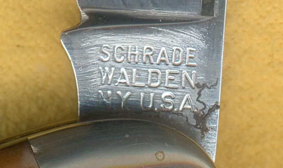

There are no further markings on the knife; no pattern number, and no markings on the pen blade.
I will add a larger picture of the tang stamp soon.
Here are pics of the tang, and some of the jig;
I am way out of my league here with all the construction information, but, is it possible this knife was rebuilt by Schrade? I have a boy scout knife that I dropped off at the factory back in the 90's to have a broken blade replaced: it was, but with one that is "sort of like the original." Perhaps that is what happened with this knife? Rebuilt with what was at hand at the time?

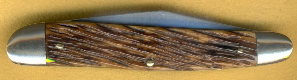

Wrong master blade....doesn't have the proper swedge; doesn't fit the backspring; too short for frame.
The tang mark is bad. Looks like a pantograph engraving, not a stamp.
I can't tell too well from the photos, but it looks as if the tang on the pen blade may have been ground thinner on the inner side to fit it's backspring. It does not have a swedge, as Charlie stated, but should.

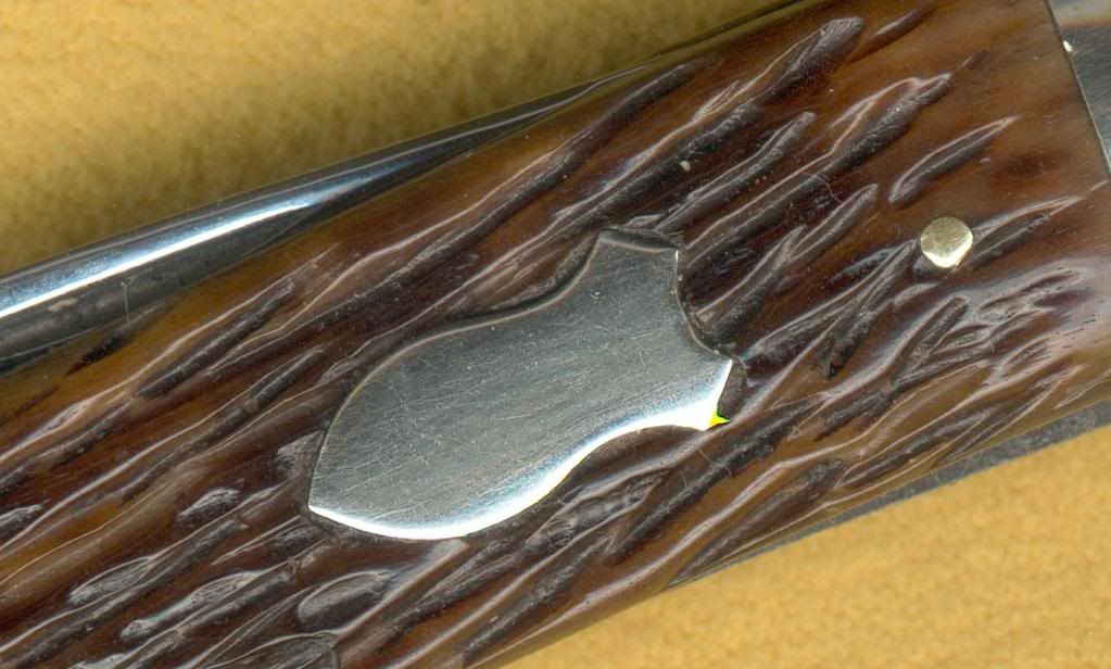

Not Schrade jigging, and although I think the shield is the correct one, it looks like it was inletted with a hatchet. The fit looked suspect from the first photos, but is glaringly obvious from the last pics.

the mismatched blade/spring and odd looking swedge are probably from being reground/"cleaned" (looks like the bone got hit with the buffer as well). JMO
You can see how much "cleaning" it's had by how much the tang line on the pen blade was changed,it also hides the fact that the master blade has been sharpened some,it's probably only about 10% smaller or so but it is noticeable along with the reground choil.As others have mentioned,that master blade didn't come from the factory in that handle anyway,it's an ok user but not worth anything as a collector.

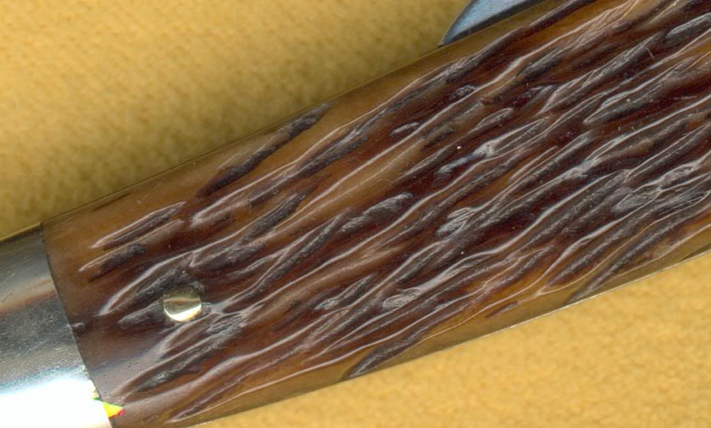

I've taken two more closeups of the bone. You should be able to see evidence of overbuffing with a soft wheel. This may account for the odd appearance of the jigging, and the mottled appearance of the color.

The stamp looks fake to me. You can see at the end of some of the letters where it seems like the engaver stopped and made little round marks. Theres been a ton of knives sold on fleabay made by that Brett guy that look just like this one.
The bone is harder than the nickel-silver and brass, so the soft buffing wheel, when used too vigorously, gouges these soft metals. Notice all the erosion on the bolsters and the brass rivets! The soft wheel also reaches into the jigs, polishing the insides, so you lose the contrast between the "matte" inside of the cuts, and the shiny top surface. Not nearly as pleasing to the eye.
The swedge on the master is softened from buffing as well, losing the crispness we all long for
The poor fit of the tang-to-spring of the master blade, the grind of the pen; more indicators that the knife has been apart, and re-assembled from disparate parts.
I will post some more tang stamps, because I agree with you doubters of the stamp!
I don't have a problem with the color of the bone, but it still doesn't look 'Schrade' to me. Look at the last pic of the pile side. the jigging cut runs from the rear pin, all the way to the edge of the cover below the center pin. It's dark, and didn't get like that from over-buffing.
Long jigging like that just doesn't look like I'd expect from Schrade, unless like Russell said, it was for a special order.
Fran
You are right Fran, the cuts are too long!
