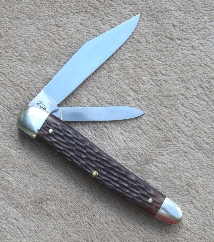

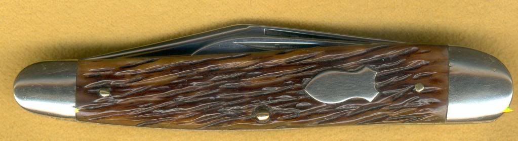

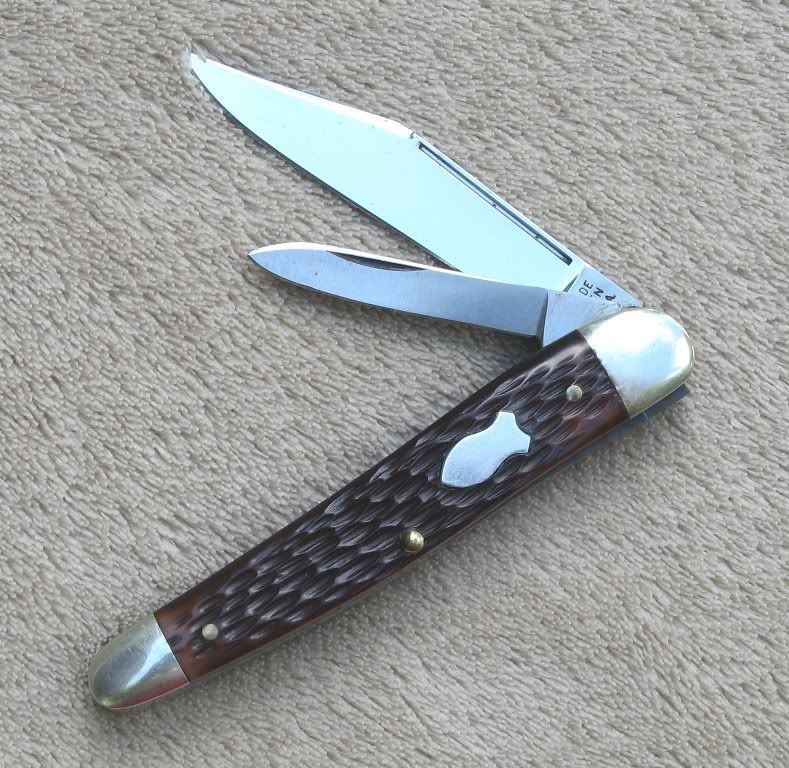

Charlie,
It's always GREAT to see some examples side by side! Really brings out similarities and differences. After seeing them like that, I'd almost be inclined to say that's original jigging, but then I noticed how differently the handle pins are placed on the questionable example versus all the others. Both pins are placed closer to the center of the knife, and this is something that wouldn't happen in production as the holes are drilled according to a pattern jig. What does some chicken eyeing reveal about possible previous pin hole locations on those liners?
Eric
