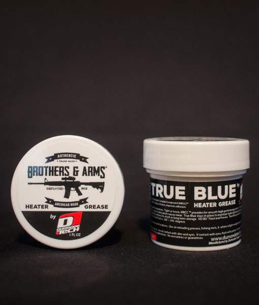

I'm currently testing this while I wait on my steel blanks for my lubrication test I'm going to be doing.

At the moment the grease I posted above has been outperforming the CRK grease, though I have to admit I don't have 2 of the exact same knife to do a fair test and I don't have all my blanks yet to do all the actual legitimate non subjective testing I'm going to do. Just thought I'd throw out there that 2 week in and the True Blue is operating smoother then the CRK, but again everything isn't equal so take that for what it is worth.

I'm starting to get to the point where I am ready to start recommending people try this product. Over the last month I have received 4 different used CRKs. Every single one was running on factory grease. All looked like they had been recently clean and were relatively smooth. After breaking all 4 of them down, soap and water cleaning them, a little magic eraser to the washers then reassembly using this grease I'm 4/4 on smoother knife.
My Inkosi is getting close to a month now running this grease and feels the same way it did immediately after cleaning it. Literally the only reason I haven't taken it apart just to clean all the schmutz out from inside is because I want to see how long this stuff lasts before I begin to notice a difference.
Anybody else interested in giving this stuff a shot on their knives? $14/oz or $30 for 4oz which would last you a lifetime. I have no affiliation to this product or company what so ever, but would love to get some other opinions on this stuff.

What is the purpose of magic eraser-ing the washers? Are you using it to clean the gunk off them, or does it do some polishing as well?
Yes but a finer amount of material is removed then even some of the finest sand papers.
That's what I thought, and that's something that is probably affecting your test as well. Here's what I mean:
When you test something (lube, in this case) you want to try and make sure that is the ONLY thing you are changing in your test. With the super tight tolerences on CRK knives, even removing a slight amount of material from the washers will have an effect. I'm not saying you're getting a complete false positive from the way you are doing it, i'm just saying the way to really see the difference from *just* switching lubes, is to carefully remove the old grease and replace it with the new. That way the mechanical aspect is as close to un-changed as possible.
In otherwords by changing the lube and slightly polishing the washers, you are seeing the results of 2 changes.
By simply cleaning the knife and switching *only* the lube, you are getting a better idea of the difference the lube makes since that is your ONLY change.

Definitely agree 100% with what you are saying. I have done the test with a few other knives of different kinds including a CRK without polishing the washer just for testing sake and the results were the same. I went to polishing the washer with the magic eraser because I'm that anal about trying to remove as much gunk as possible, plus it helps remove any old stubborn grease that did not come off in the brush bath.
