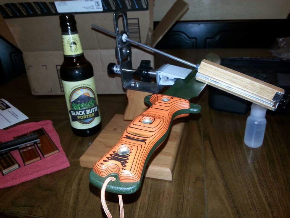

I have been using the KME for a while now. I have most likely sharpened 80 + knives on it. I have reground so many blades my 100 grit is no longer 100 grit lol. Its a very nice sharpener but it has its weakness. As far as cost goes to get "next level sharpness" you will have to fork over some additional coin. Not as much as a WE but only a few hundred less than the WE if you happen to be mil or something else that earns a discount for. So for cost, it IS cheaper, but at the end of the day not as cheap as you may think.
The leather strops and KME emulsions are nice and go down to .1 micron, however, if I were to do it all over again. I would completely avoid them. They work well but not great, in my experience when someone is attempting to go down to a .1 micron level they want the results of an emucalent, beautifully finished 100% even, mirror finish blade and 98% of the time I have been UNABLE to achieve this. Its not very difficult to get the perfect finishes on the cheap steels, but when working with the harder alloys it is significantly harder to get all the scratch marks out, even after using a stone that is well broken in and realizing the scratches are there and consciously trying to get them out before moving to the next stage. I would forego the strops and just move forward with the more expensive chosera stones which more or less eliminate this... Once again getting up there in price much closer to the WE (not saying to go get a WE, just pointing out that price point at the end of the day is not that far off than what you may think).
Don't waste your time with any stones in the KME that aren't the same depth as each other. Constant realignment is not worth the hassle or time.
The KME jaws leave a lot to be desired, knives like to slip and move, and you have to be EXTREMELY CAUTIOUS when clamping the blade down to measure out the angle at the tip middle and heel of the blade in attempting to get the most consistent blade angle as possible. Any knife that has a flat spot on the blade can achieve a solid edge from the KME, however, any blade that has a full grind or smaller more acute blade shape will sometimes have a lot of difficulty with the clamp.
The smaller clamps are very nice for smaller knives but the aluminum is very soft and bent on me the first time I used it. I had to take them out of the clamp device and flatten them on a board in order to use again.
I needed to make a steel flat to put on the back of the KME so it would hold the angle cube, It would be nice to see them do this for us, I also upgraded the knob on the sharpener for a more ergonomic grip.
I know this is a somewhat harsh review but it is honest and objective of the KME,
I WOULD BUY IT AGAIN, but no the leather strops. It works great for everyone who uses it, but if you want the next level edge that looks as beautiful as your knife you may want to consider a different sharpening system than the KME, but if all you want are razor sharp edges and don't care about scratches in the blade or strops leaving some parts of the blade more polished than the others than this is definitely the system for you! This is a hell of a user sharpening system where others are more of a show/perfectionist type of sharpner.

I have been using the KME for a while now. Its a very nice sharpener but it has its weakness.
Nice and balanced review, just a few remarks....
All sharpeners have their strengths and weaknesses so it would be best to choose the one that suits the majority of your knives. For the rest of them it is usually possible to make a few tweaks to get it to work with those as well.
Since a few months, they have a stone thickness compensator which eliminates this problem. Other sharpening systems also have this problem so for the Wicked Edge you would also need their Variable Stone Thickness Adapter or a drill stop collar for the Edge Pro Apex.
Most clamping systems work well with knives that have a flat spot on the blade but less well for FFG or hollow grind blades. Folding a piece of thin leather or chamois over the spine will usually do the trick and fills the gap.

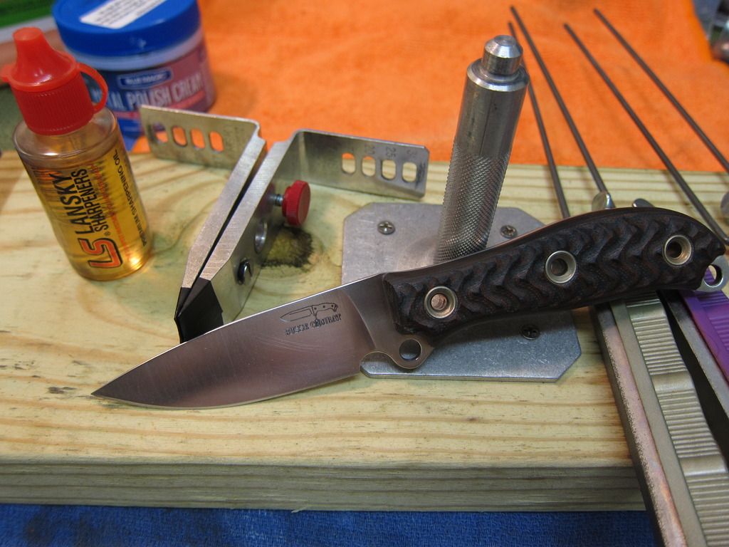

Broke out the 20 year old Lansky Diamond Kit. Have not used it for at least 10 years.
Did a little youtube brush up and got a couple of tips from this video https://www.youtube.com/watch?v=ZlI5PaXsfOk

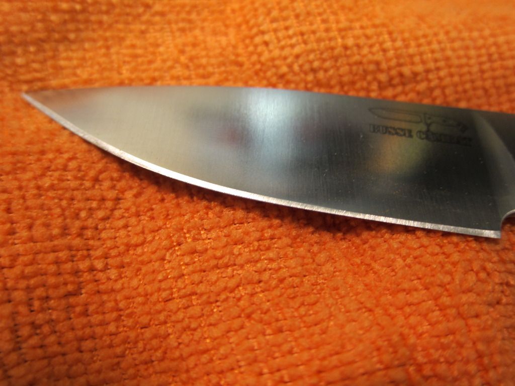

Sharpened the first Busse ever.
Turned our really well. Did not scratch the blade and the knife is very sharp. Only have a fine stone ( 600) and think the edge would be even sharper with the 1000 and 2000 stone.
Looks like there is also a leather strop available and a new updated clamp. Will give those a try as well.
Knife Came Well Used With Scratches - Lansky Did Not Scratch Blade
The 1000 and 2000 Stone Would Polish The Edge More Than The 600 Stone I had

That is actually one of the better videos available about the Lansky. I would make a marking at the side of the clamp as an indication of how deep the knife was placed in the clamp (or use the notches) so the next time it can be placed in exactly the same position. (I used a metal saw to make the markings).
I would also hold the stone on top at the middle or closer to the rod. That way it will naturally be pushed down a little and not rattle in the guide holes and there would be no risk of your fingers hitting the knife edge.
There have been numerous complaints about the new updated clamp. The rubber inserts came loose, when using the 17 degrees setting, the stone would hit the clamp. It was almost impossible to securely clamp smaller blades etc.... They removed the complaints from the site but this was the reason that they brought back the original style clamp. The soft-grip clamp will probably work with your larger knives but so does your original clamp.
Great tips, thank you. Ended up holding my finger on the top of the rod behind the clamp angle slot to keep the rod on the bottom of the slot and consistent.
