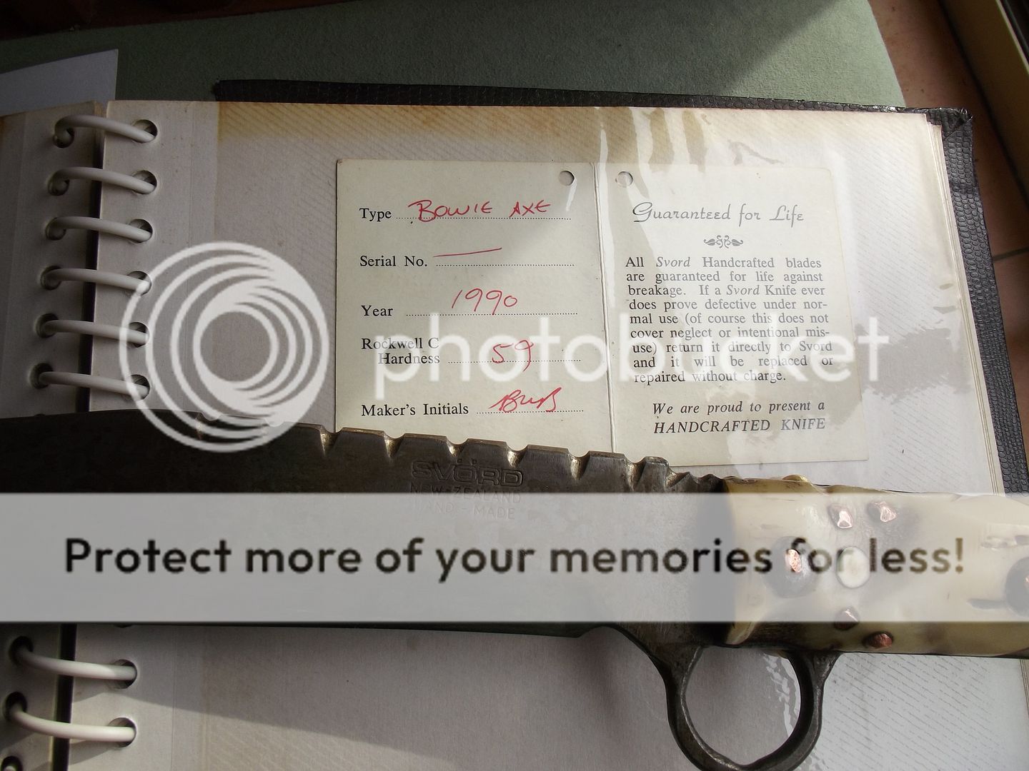

LADY EARTH....What an interesting thread?...Ive never owned a BUSSE and have no need to...I bought a Svord Bowie in 1990 and have never needed more of an (axe?) in my life...It was my edc as a demolition tool for 9 years,been on countless hunting trips and been trashed and thrashed in more ways than i care to mention.....10 inches of L6 at 59rc takes a bit of beating i tell you!....But each to there own...FES
OP, You mentioned cold affecting blades. It's true. Some steels seem to hold up in cold better than others. L6, as in the Svord knives has a reputation for dealing with cold better than some other chopper/large knife steels. Something to consider.
