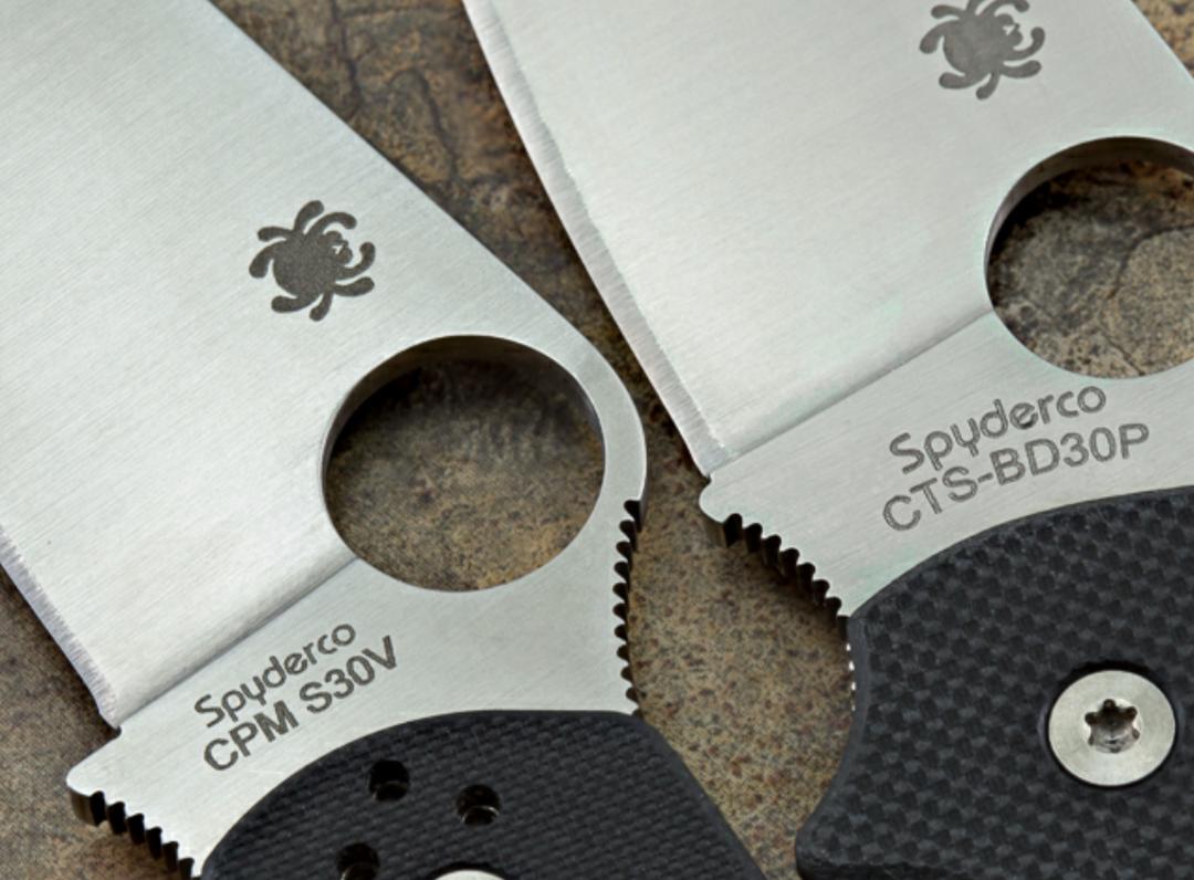

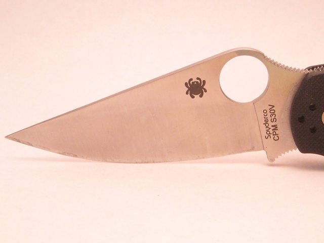

Bodog, not sure if you are joking but I don't think that Boris Spyderco is fake. I have seen the exact same font on many spydercos here are just a few:

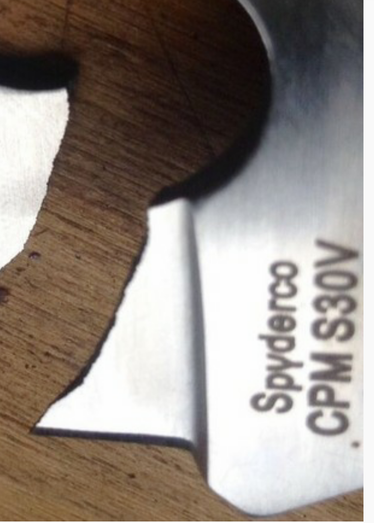

The logo, writing, and choil don't look right. Compare the "S" in spyderco on both knives. That should show what needs to be shown.
And like what they said earlier the way, look at the way the steel broke apart. Zoom on on the photo ans look at the chips along the crack lines. If that's a cpm steel then someone nuked the hell out of it.
Vs this. Now that I look a little closer it doesn't look like it has jimping either.
I'm no expert but I would definitely call fake. The font is completely different.
Funny, I didn't notice anyone mention the font but the pics shared by Cobalt even make it more clear that it MAY be fake. Take a good look... The spacing between letters is off.
I would normally be inclined to agree, although the almost ligature-like spacing of the "CO" and style of the font is a dead giveaway. The C's are wrong, and you'd think something probably made in china would at least get that right.
A real one, not mine, from early 2012:
I couldn't imagine spyderco jeapordizing their brand rights and consistency for a font change on one model.
I just think of those Cabela's retunree scams that people fall victim to. Why I say take it out of the box before you buy it.

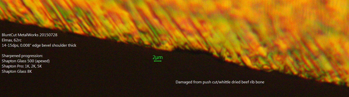

Edge: left section = as-sharpened. right section=after whittled rib bone.
:yawn: stuff?
:yawn: stuff?
Am I seeing this right? Being as close up as what it is it looks like there's not much damage. Do you have 52100 photos?

The only real way to find out what's going on is to send it to Spyderco. They can determine if it is in fact a real one, as opposed to counterfeit, It can be tested, chemically analyzed and conclusions reached which will be shared here.
