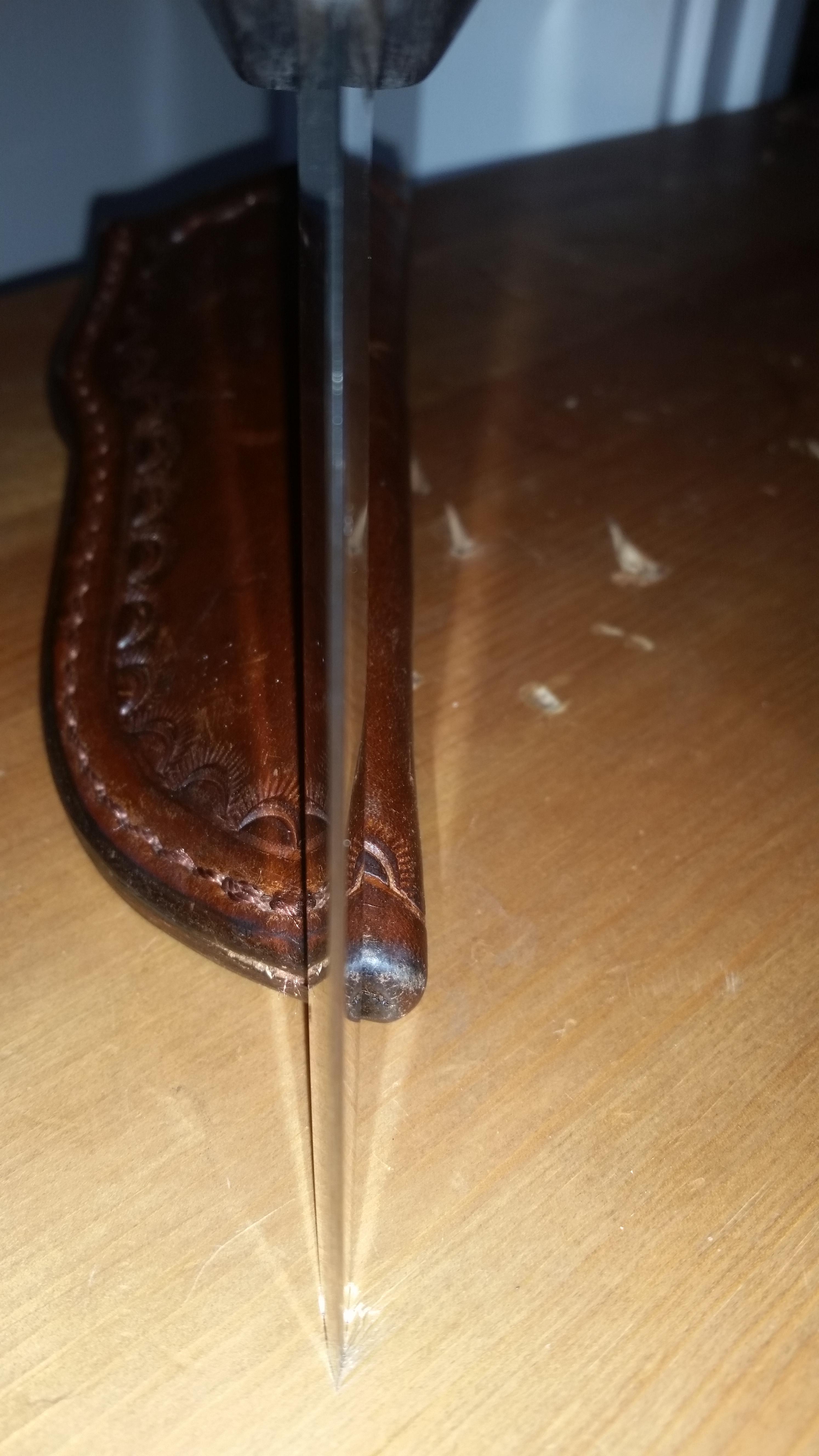

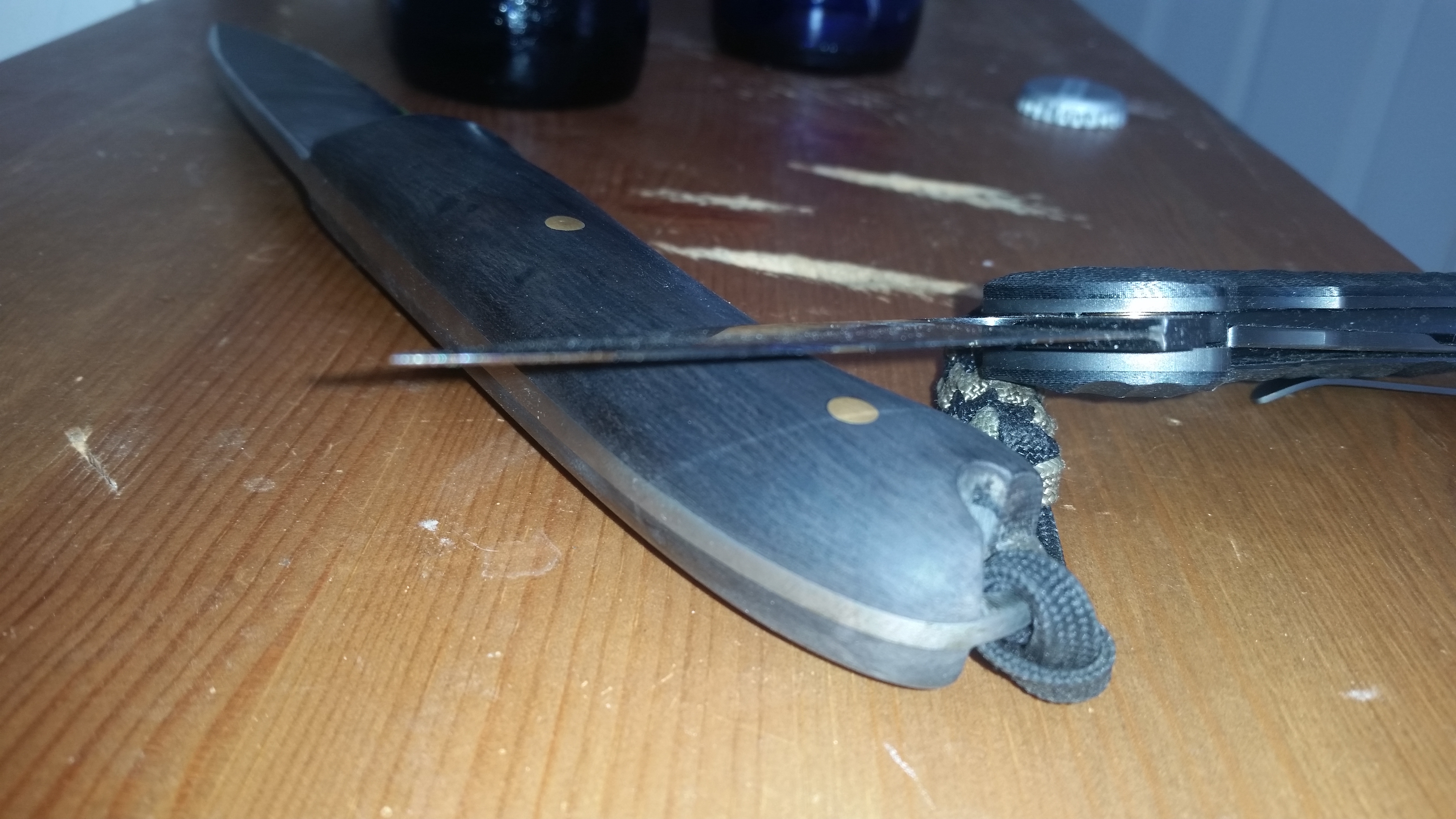

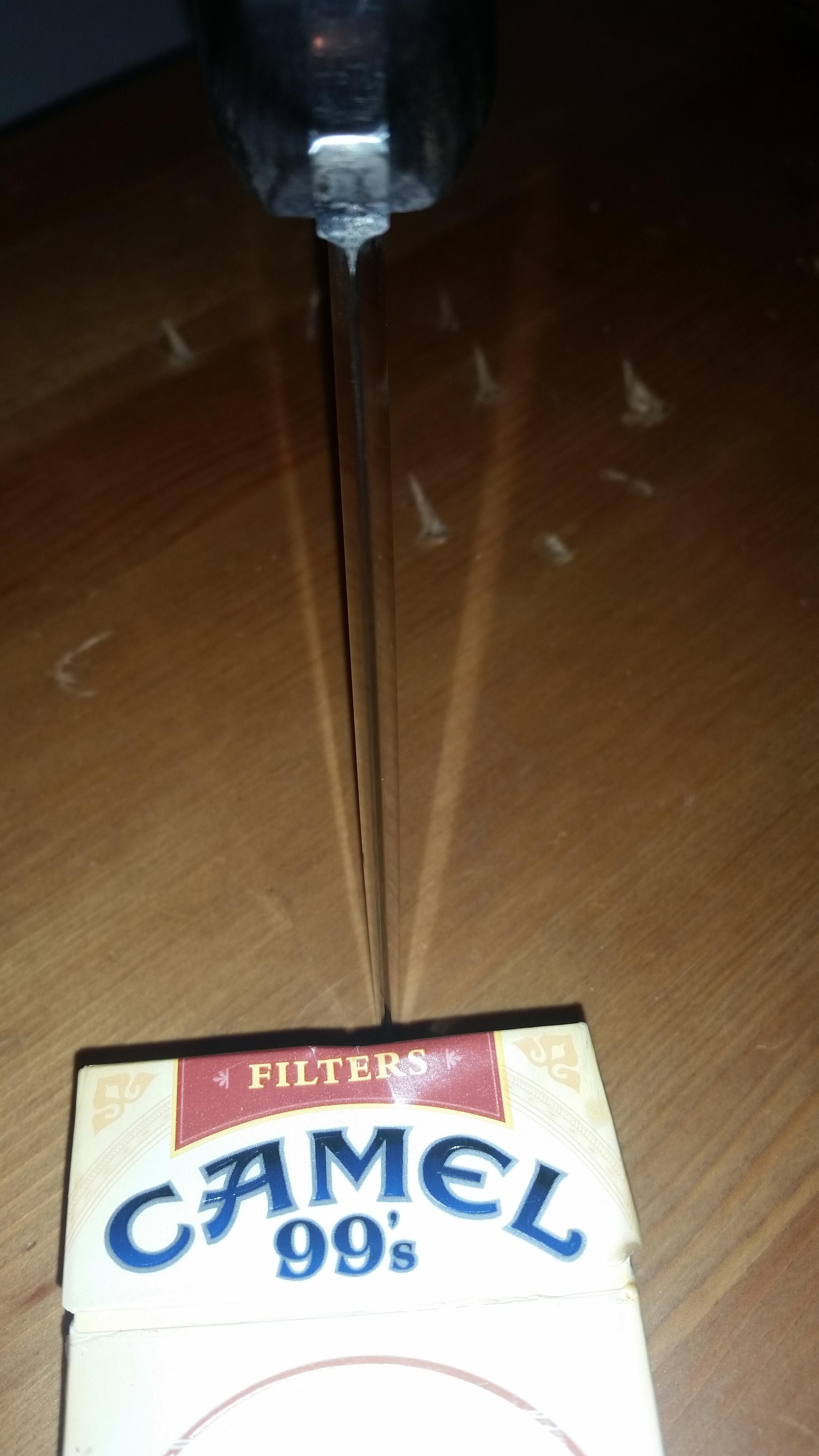

Elmax got a major ripple - apex sagged about 15um, bevel dent (darken area - where light reflected away from receiver) over 140um height.
While 52100 suffered ~8um apex sagged and bevel dented to around 35um height away from apex.
It looks like elmax may have won?

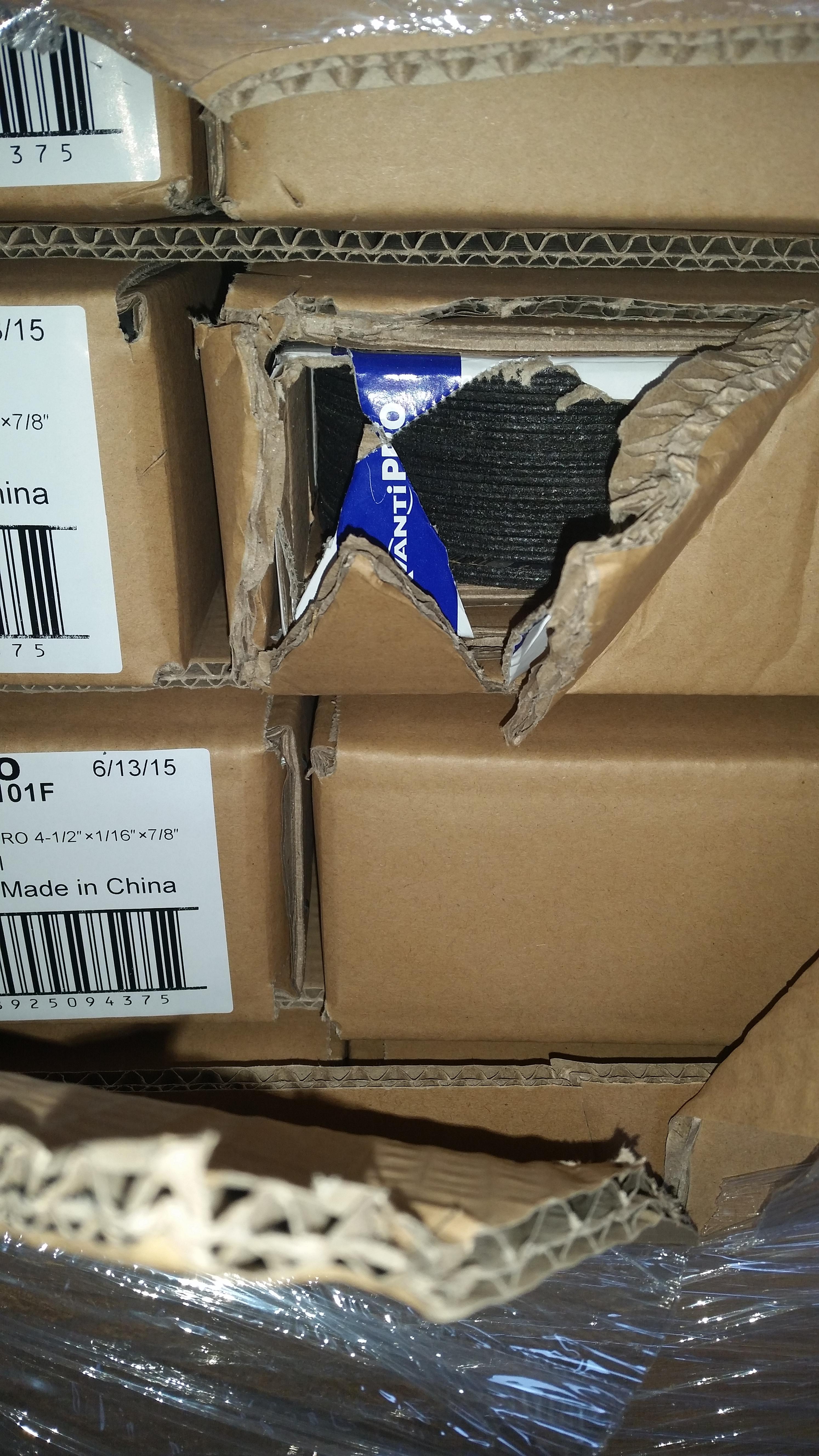

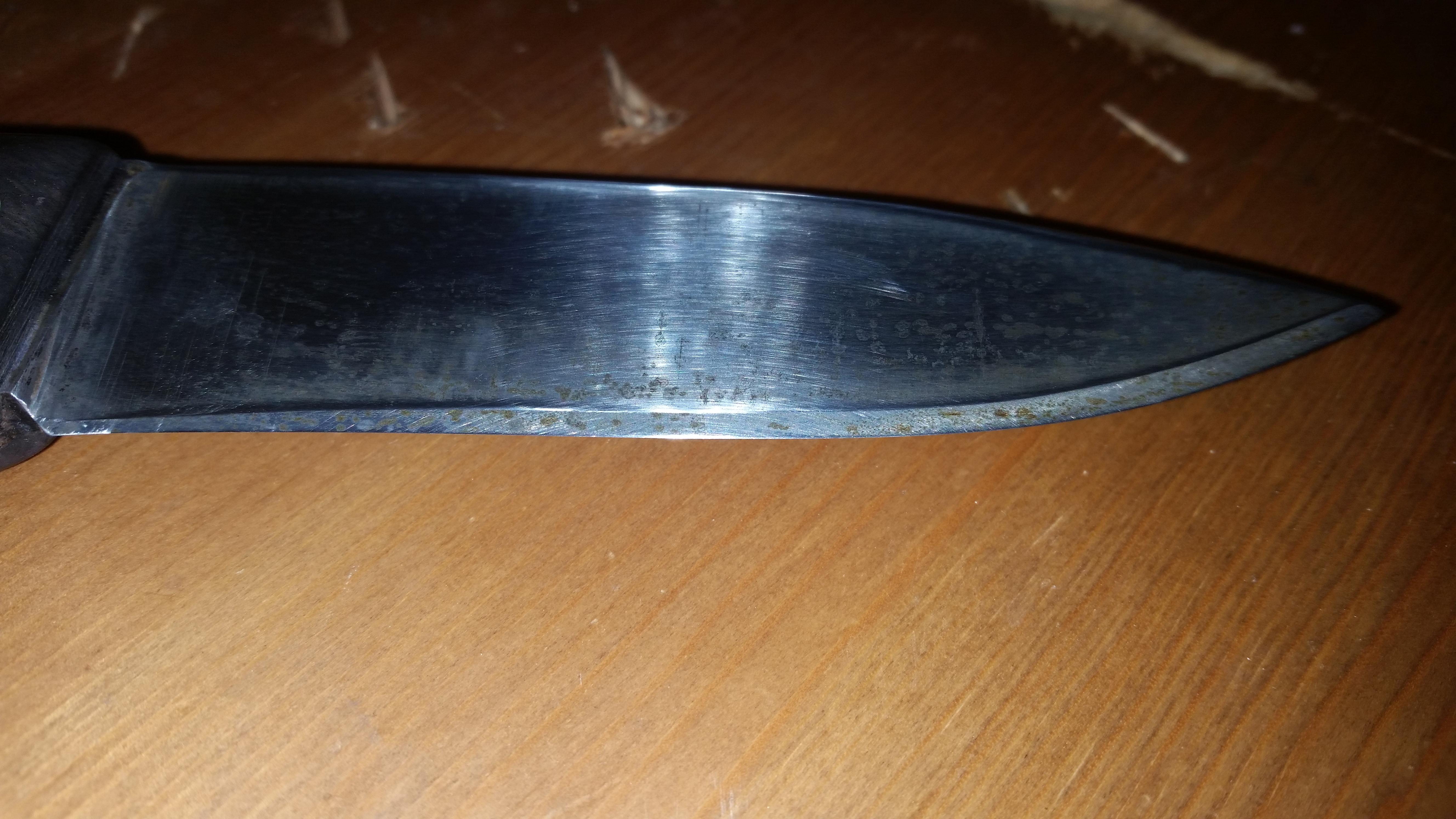

I'm not comparing 52100 from bluntcut with anything, I'm just showing it on its own. Here is one of his knives that I put to some good use over the weekend. I cut a bunch of quadruple ply cardboard, pried open about 8 sealed refrigerator covers, cut up around 5 whole pinapples (highly acidic), probably 40 bananas, popped a bunch of pallet straps, hacked into several pallets, etc. The edge didn't roll, dent, fracture, or anything. After all that the knife still slices printer paper easily. Not because 52100 has the best wear resistance via massive carbide volume, but because the edge apex remained intact, straight, and defined via its strength and toughness. This is directly after quite a bit of use, no touching it up on stones or strops or anything more than cleaning the crap off of the blade. I did use some 2500 grit wet/dry sandpaper on the primary bevel to see how deep the patina was but I didn't use it on the edge.

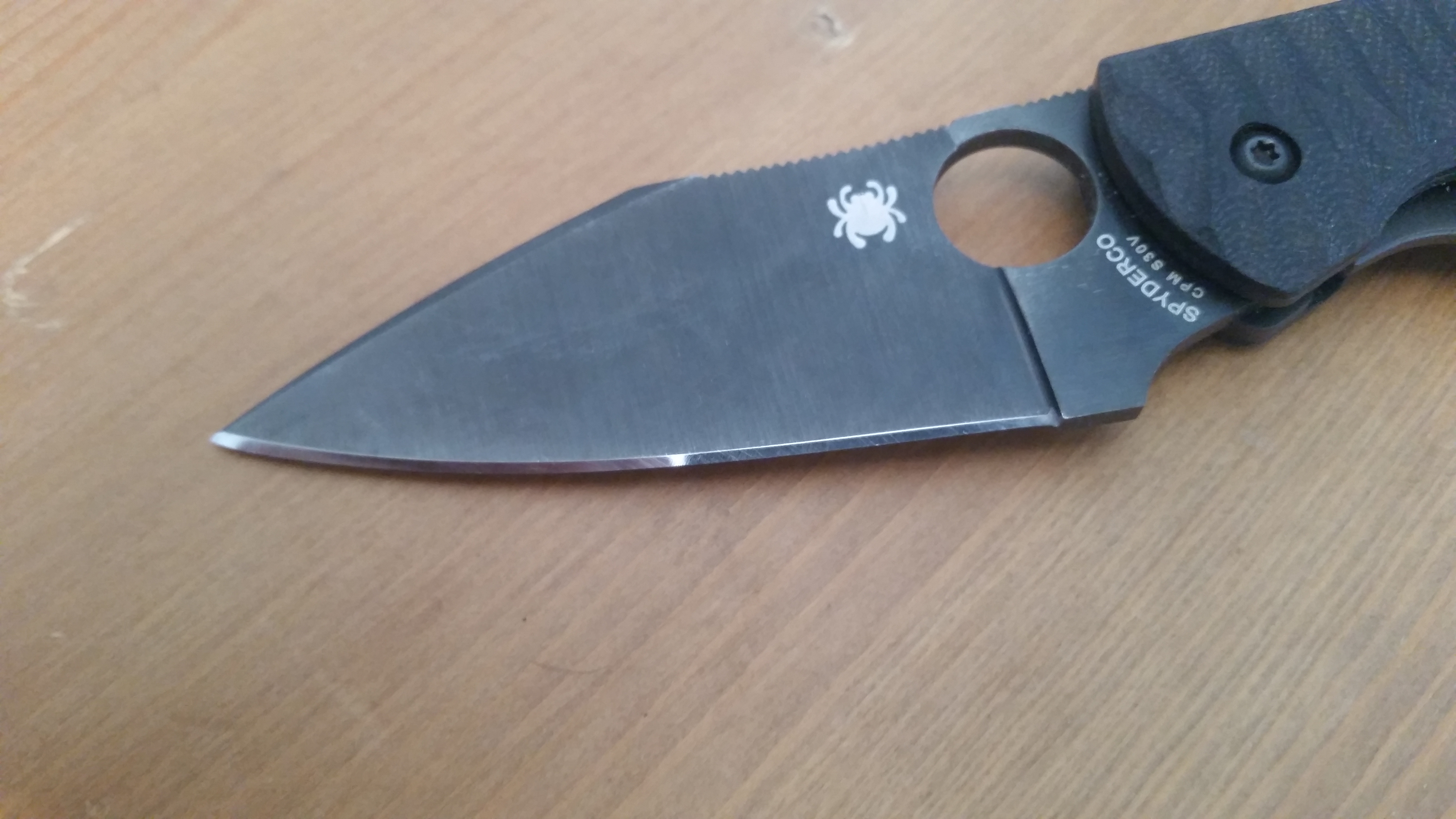

Here's S30V after much, much less use. I'm talking maybe 10 dirty, double walled boxes cut open and some pallet straps busted. Nothing major at all.

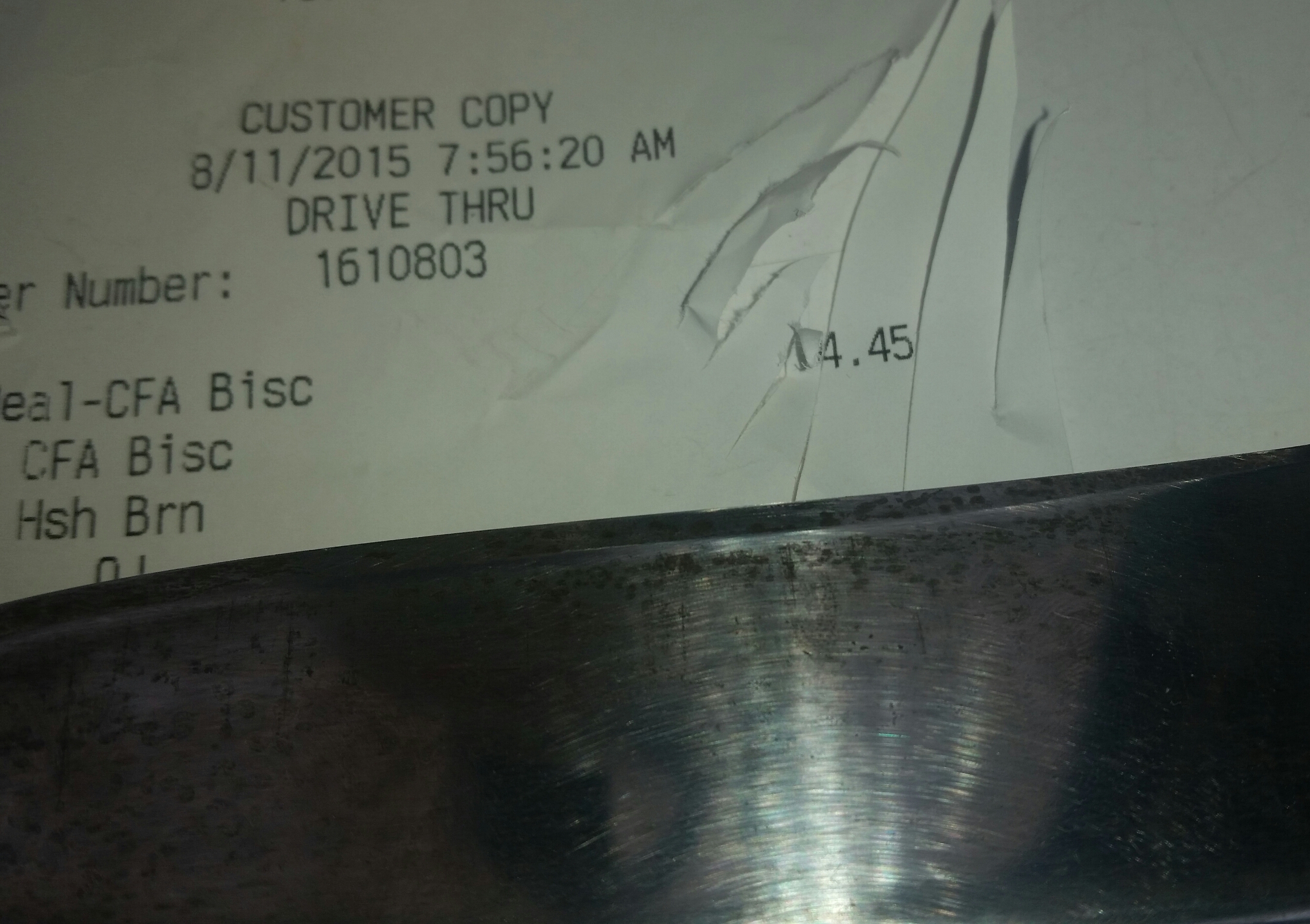

But, being objective here, it does come at a cost. Stain resistance is low. No one ever accused 52100 of being stain resistant, but I do have to say it stains easier than 1095 I've used. On Friday I needed to cut into a can of corned beef, I didn't have anything to wipe the crap off with. It stained within 10 minutes. I sharpened it that night because cutting into the side of any can will at least slightly damage any V edge thin enough to cut well. I also sanded the uneven patina off and forced another patina on the blade.
Sunday is when I was cutting up the boxes and whatnot I referred to earlier. The pineapples and bananas stained the blade even faster than the corned beef. It's not rust, its patina, so it's not terrible, but it came quickly. It doesn't bother me. My coworkers were even impressed with what i was doing with the knife and how it held up and they're not knife nuts like us. They did show concern for the staining, though. When I showed them it wasn't rust a couple of them expressed interest in getting a similar knife. I've not had any non-knife nut friends/co-workers say they wanted something more than their Gerber/smith and Wesson/Winchester knives before and it really is because this knife has taken a good beating over the past week and has performed very, very well, enough to where even non-knife people have noticed. That's pretty rare in my experience.

At least 20 boxes in the morNing session, that was frozen fish. At least 30 boxes in the afternoon session with the fruit. Quadruple ply. About 6" x 6" squares or triangles. Between 3 and 8 cuts per box. If my math is right that's about 300 feet or more cut if the cardboard was separated and laid out straight. I really don't know if 300 feet is a lot and I really don't care that much. It did what I demanded of it and i do know i demanded quite a bit. The cutting media was similar to this with less abrasive and more corrosive stuff inside:
And prying up sealed refrigerator panels absolutely can chip or roll and edge. I referenced the acidic foods because that can degrade an edge as well, but only a little. I didn't say that this steel was the same as 10V in how it wears. I said it maintained it's edge through toughness and strength rather than carbide volume so it absolutely can continue to cut printer paper without tearing it because the edge is intact and even rather than chipping out like higher carbide steels do. The fact that this knife performs like it does is what impresses me because you're right, 52100 doesn't have the reputation of keeping it's edge like that. Maybe it's just not normal for someone to produce a moderately high hardness version of a tough steel with a really fine grain leading to even higher toughness. It's ok that you don't believe it. I'm the one using it and can see what it does and how it behaves.

Like I said, I haven't touched up the edge at all since all that work. Here's some receipt paper, it's pretty humid right now so the paper is a little damp for whatever that's worth.

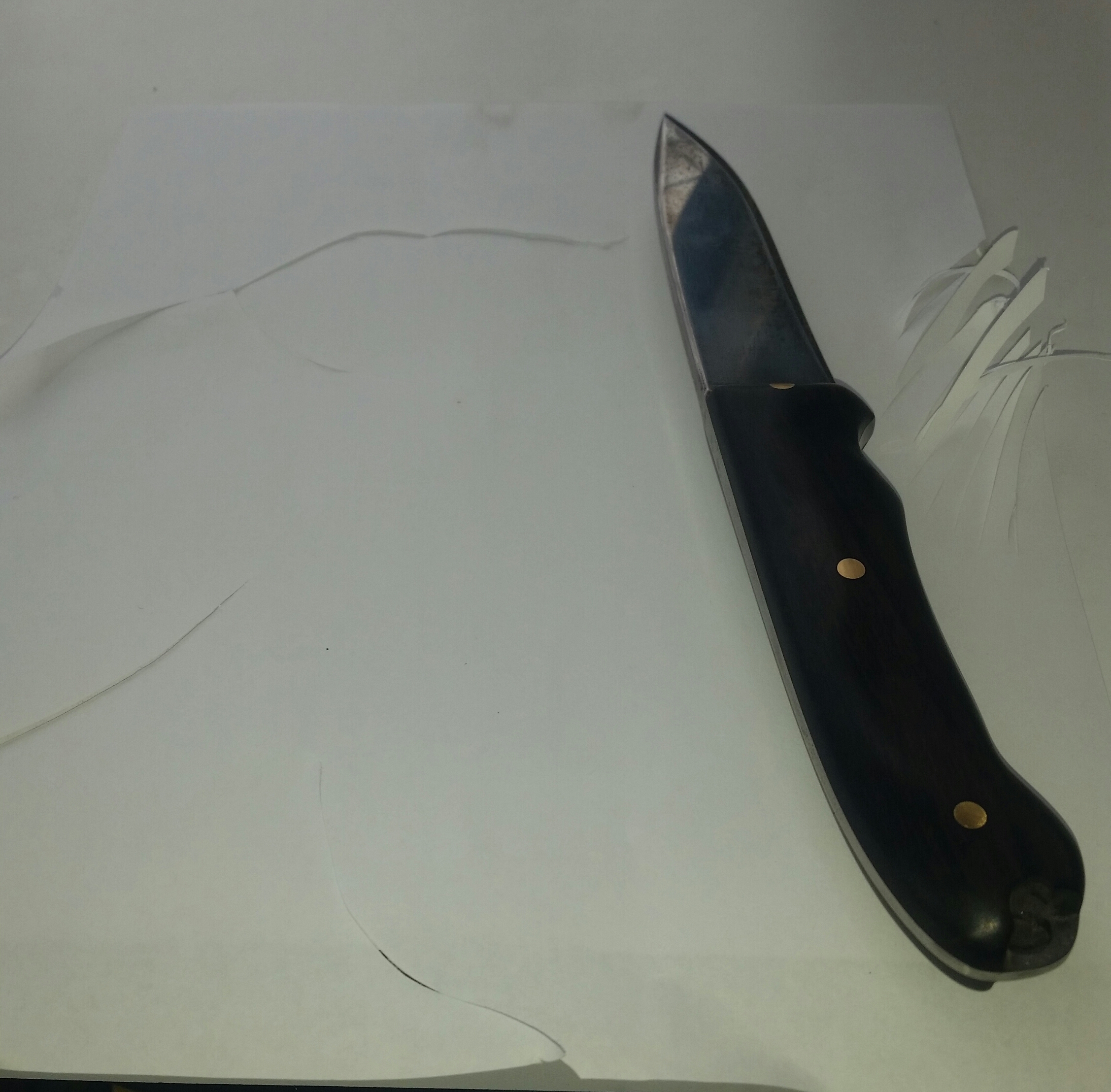

And here's some regular printer paper. Draw cuts it easily the length of the blade. It'll still push cuts at the heel of the blade.
