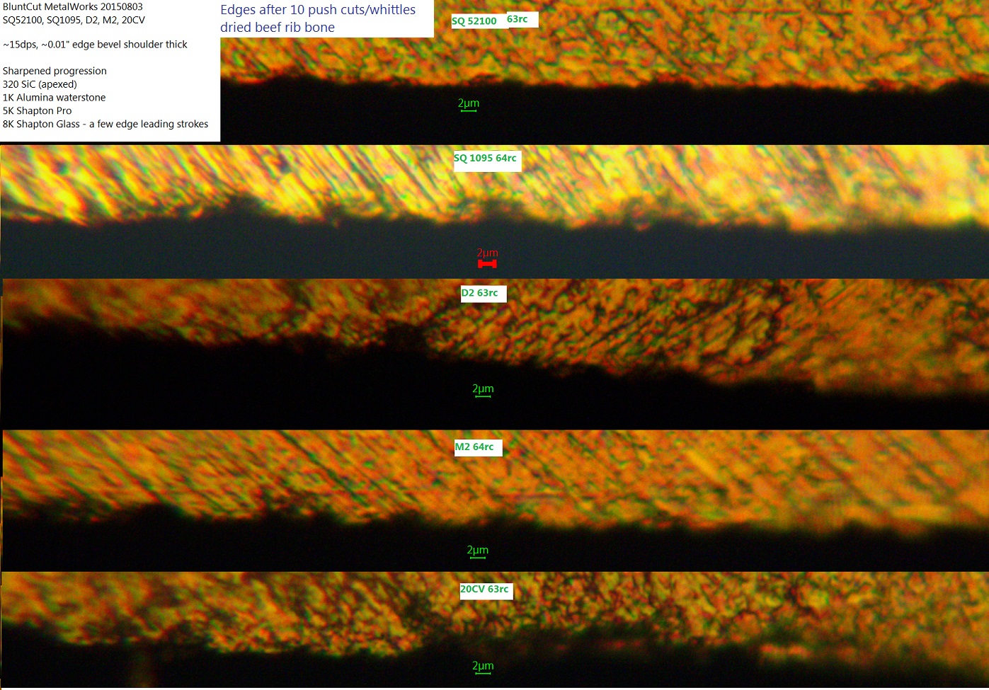

Yes, Elmax looks nifty good eh. Although I only made 5 cuts/whittles into dried beef rib bone. I should make another 5 cuts and re-imaging...
Am I seeing this right? Being as close up as what it is it looks like there's not much damage. Do you have 52100 photos?

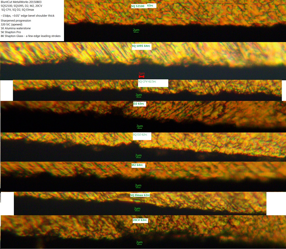

Here is SQ 52100, SQ 1095, D2, M2, 20CV. Be mindful/fair, should take hardness into consideration.
Excellent comparison photos Bluntcut! That is a good quench on the 52100 alright. The carbides are seperated pretty well. Contrast that with the D2 where the carbides clump together in places which can cut well in some materials but loses strength and toughness. Still a good HT in the D2 as it's better than many I've seen.
The M2 almost looks like a powder steel. It makes a very good cutlery steel IMO and would be used more if it weren't for powder M4HC steels in use.
I've never seen SQ 1095 but I do see the controlled grain structure and carbides.
To be honest they all look pretty good to me. One can't consistently make good knives without control of the HT and this displays you are doing things properly.
Thanks for putting the images up.
Joe

When a sharp edge (very thin cross section) impacted (forces and combination of into+deflection+twisting+etc..) with non yielding or hard materials (bone, sand, metal, etc..). Naturally, we like to know the state of this edge afterward. As an example, submicron radius apex hits an embedded/inclusion 30um(about half diameter of a hair) grain of sand when whittling wood. This is an impact event (non rolling/adhesive wearing type) and if this type of event is regular occurring, well ideally we can optimally select steels + ht + geometry for most productive result. Of course, I am talking about when percentage of imperfection dent/chip in an active working section of an edge negatively affecting the work result. If not, Bossly voice => 'work harder... stop looking at the edge' :)
Years ago, I did 3 months raspberry-cane-thinning work (yup, I worked in the berry farm for a handful of years). At that time, I hate the darn billhook (stout version of a mushroom knife) need to resharpen(with a file) every 15-30minutes of work. Rolls & dents were the mode of damage. *time travel* - I will take a knife with more strength & toughness, welcoming microchips anytime anyday. Yeah, I can carry SiC (file like) to sharpen. I cut plenty of rope too and often edge in contact with 3/16" dia wire. Extra wear resistance is obviously would be a nice-to-have after taking care the primary mode of failure.
At some point in chasing ultimate blade per given tasks per given technique/skills, we possibly getting diminishing values in return for investment/effort. It usually mean to last 10-20% of performance. I am not perfecting that last 20% with my ht but hope to expand the 80%.

These edges weren't polished nor etched, so only partial carbides are showing up. D2, some look like grain but actually they are massive CrC (aggregated from mill, which I wasn't to able to break all of them up into smaller carbides).
My SQ (super quench) ht is applicable for low Cr steels (e.g. 10xx, 5160, Cfv, 52100, W2, etc..). SQ is just a super fast quench which would crack/shatter most steels with more than 0.5%(C+N combined). Preparing steels lead to SQ is slightly more important than the hardening quench itself. In turn, w/o SQ these prepared steels won't harden correctly - shallow hardening steels will hit pearlite nose and other deeper hardening steels will suffer some diffusion into grain boundary.

D2 & 20CV at 63rc shown very low fracture toughness. Look like terrible impact toughness due to crumbly & penetrating fractures.

Added: Super Quenched (SQ) CruforgeV (CFV) 62.5rc, SQ D2 62rc, SQ Elmax 62rc.
SQ Elmax looks very good - some microchips and a long but shallow dent.
* SQ is a hammer, heeellooo steel - you are a nail, aren't you:confused::p

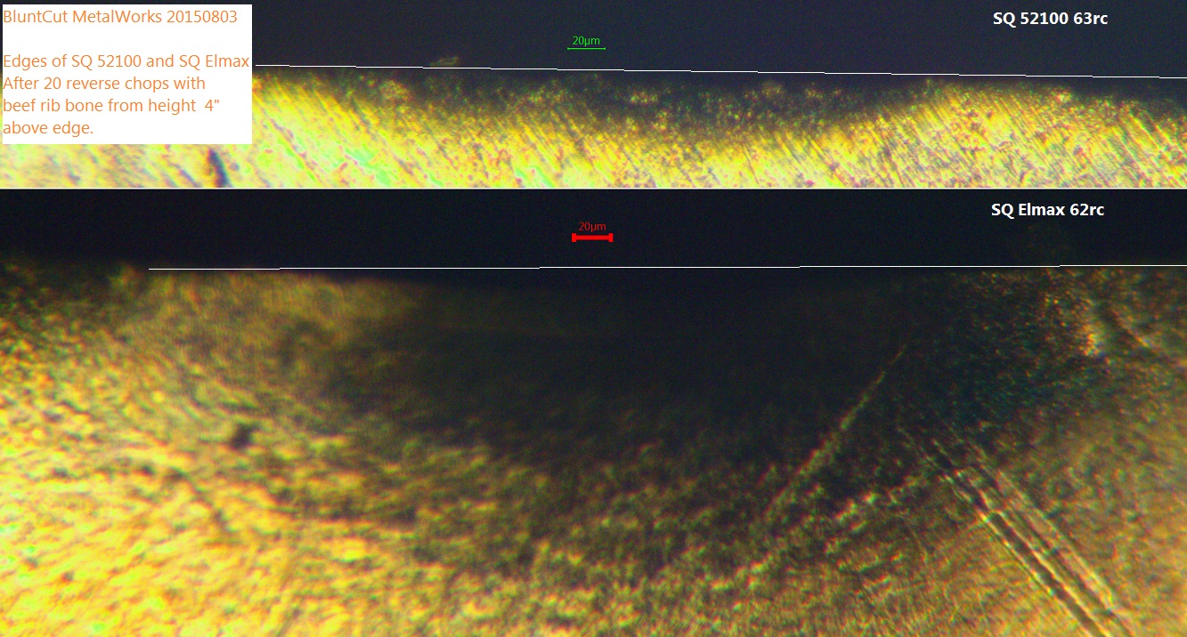

Let's compare impact toughness of the two best edges: SQ 52100 vs SQ Elmax.
** reverse chop: put spine of the blade against concrete, edge straight up. Take a piece of dried beef rib bone (pictured in earlier post), raise about 4" height, strike down. Aim for normal/perpendicular impact. Did 20 strikes, contact area is about 3/8" spread (sorry, I don't have perfect hand eyes coord). Take images of most damage area for each blade using optical microscope at 100x magnifications. **
I might be wrong, but it looks like 52100 is holding up much better.
