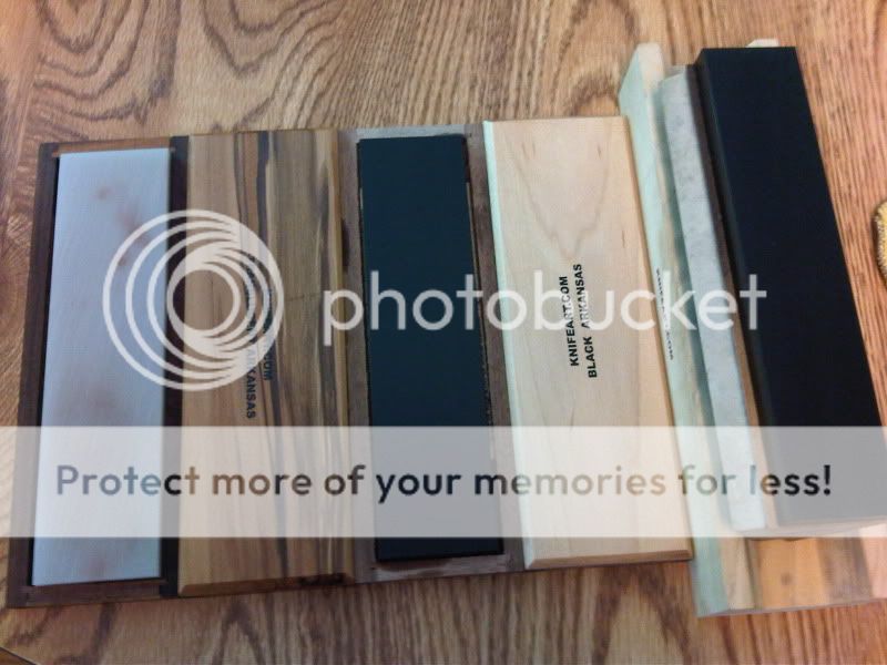

cell pic
Well, me being the person that never believes anything until I see it for myself...I ordered a new black arkansas from knifeart.com.
Here is how it goes, the translucent and new black feel about the same when sharpening. The translucent feels a little smoother to my touch but not to the metal.
The old black feels like glass to my finger and the metal. When I sharpen on the old black there is almost zero feedback and it will take the edge from the new black or translucent from hair popping to ridiculous.
Just a little conclusion of my own. This is without lapping or anything. The translucent has smoothed from very limited use but only to the touch of my finger.
Kevin

Rich, Your blacks have nice color to them. I have one Translucent that has color like yours and another that looks beige-opaque. I don't think the Translucent are defined as much by color as the blacks. My Washita is brown speckled and this is what I mostly see in this grade. The soft white and hard white are pure white with very little other color and thats what mine are as well. I think I like my washita stone and use it more for knives. My black I use more for my razor. DM
