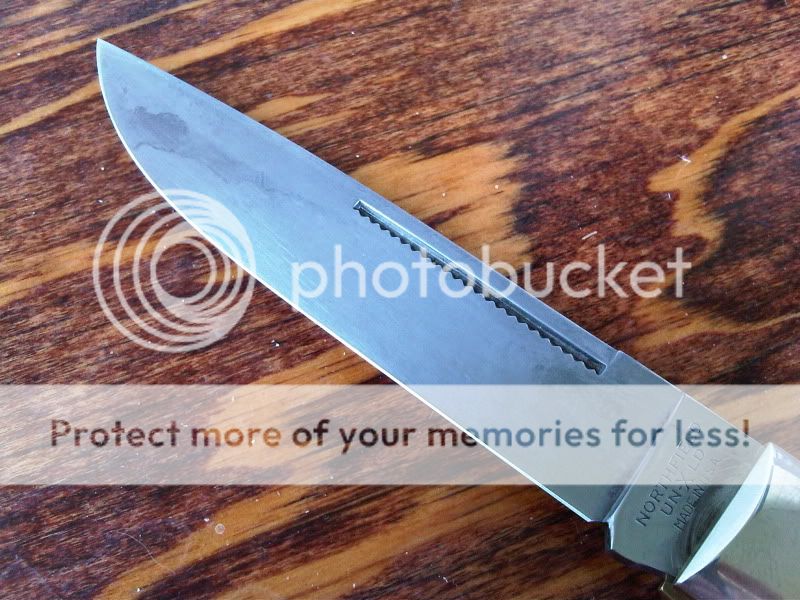

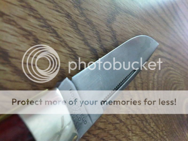

On to a pic of the edge. This is a quick cell shot I just took after about ten light passes per side. No strop, fresh off the stone. It will shave, push cut newspaper like melting butter, slice toilet paper, tissue, tissue paper and any other material that I test it on. I cut a pizza box to pieces and it still push cut newspaper and shaved hair. I found my perfect combo for folders!
Oh right, the pic. I had an incredible patina that contrasted against the edge like night and day, but I had to buff the blade lightly to remove leather dye. So here is the pic:
You can see fresh off the stone I am getting impressive results.
