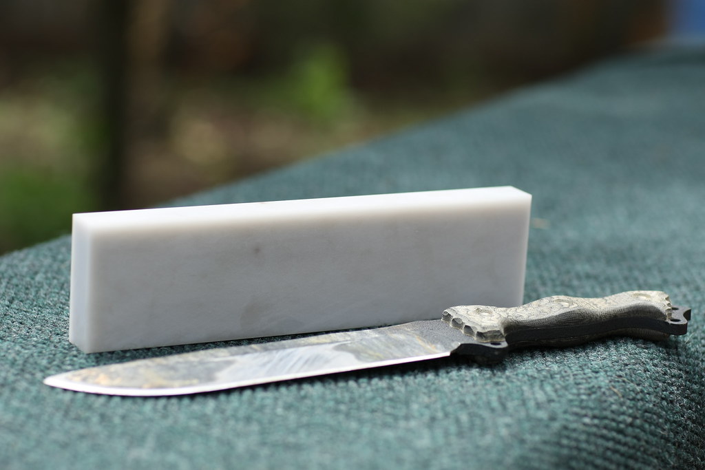

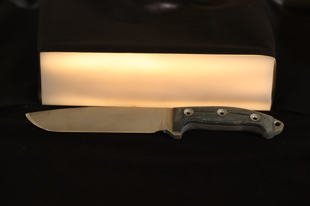

Here is a photo of my 12''X 3'' Translucent from Dan's. I was attempting to show the 'lucency' of it in the second shot. The uneven lighting is due to my impromptu light source, not the stone.

That Translucent is awesome, peppercorn!
RESISTANCE TO BUYING TRANSLUCENT STONE fading fast! :D
That's cool Pepper! You have a good imagination for pics!

Thanks Keith. Pepper, That size Translucent are hard to come buy, $$. A very nice stone. Kevin, Ho, suffering at the beach-- I see! ;) No, some stones have different colored veins in them. Not making them any harder just a formation in the way the mineral or rock was made. But when I stare at this 2X4 Translucent its appears that my vision penetrates a half inch into the stone. Which causes me to think this Translucent is clear near its surface. Whereas my other Translucent a 4X8" is more opaque with a little pink. Just a different vein and color, all still the same grade. But we don't see this variance among the black stones. DM

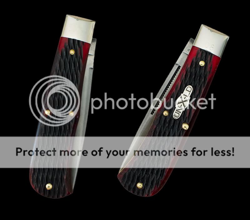

I wanted to add a little background to this thread to explain what kind of results I am getting.
Here is the knife I have been working with
Here is a cell shot of the basic look of the edge. It is not mirror but you also can not see visible grit marks. Somewhere right before mirror polish is what I am getting with my translucent. It is smoothing out but I would say I have only sharpened for 5 minutes total with it. It doesn't take much :)

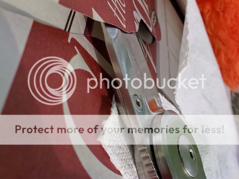

Here is another cell shot of my Busse ASHLE and the type of edge I do with my Kalamazoo 1sm.
I have sharpened literally hundreds of knives with my sander and I can't believe there is a way to get a knife sharper. With that said, I was so happy to be able to get similar results with my stones. Basically, I can 'almost' match the push cutting of the Kalamazoo and exceed the slicing qualities. I have finished directly from just about every grit belt possible and used just about every compound out there on my leather. All in all over time since I keep the edges up on leather I end up with a HIGH polished edge.

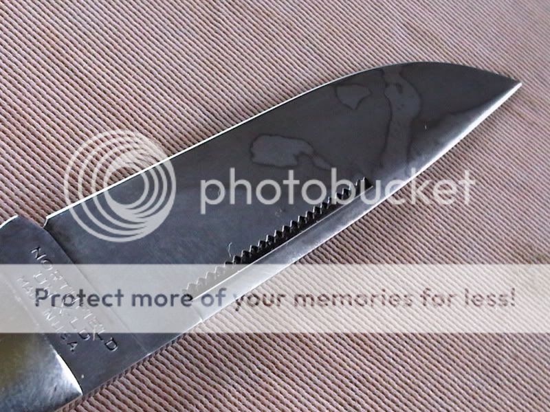

Here is a pic of an old Henckels (Boker) that I started on my stones and finished on my leather belt.
(Stainless) It is not as sharp as I can do with my sander and actually not close to as sharp as I got my GEC with my translucent but it was just another experiment :)
