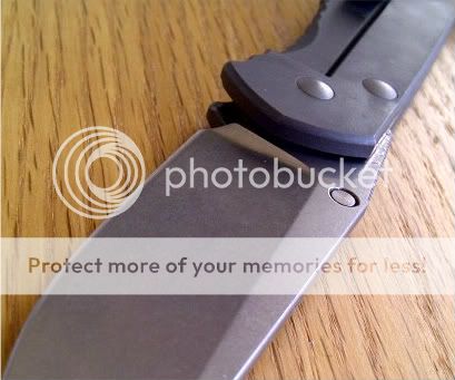

I finally started to EDC my regular sebenza again! Taking your experience into account I gave it a go on my 8x2 translucent. I was sharpening with sandpaper and a strop previously when I EDC my regular. Let me just say, I am THRILLED with the results I just got. So there is another voice telling the tale of S30v and a translucent stone success.
Here is a quick cell pick of the edge.
