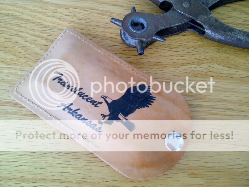

I did one quick mod to the leather pouch to make it MUCH nicer

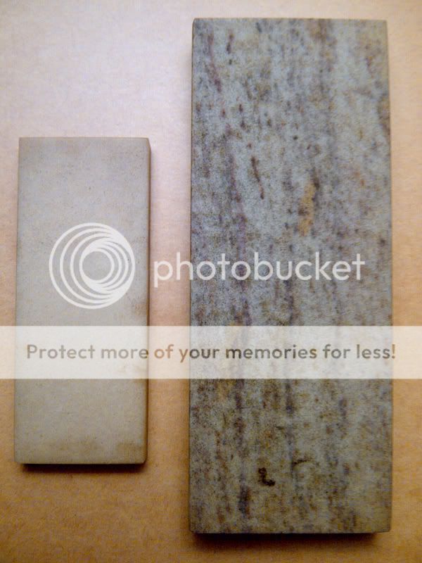

Your welcome. I have 2 Translucent Arkansas stones a 4"X8" and a 2X4" both are more beige with just a touch of pink in it. Whereas yours are a nice opaque, near white, stones. I can see why you enjoy using them. When I stare into mine there almost seems to be movement just under the surface... Enjoyable. To me the trailing point is a great shaped blade. DM

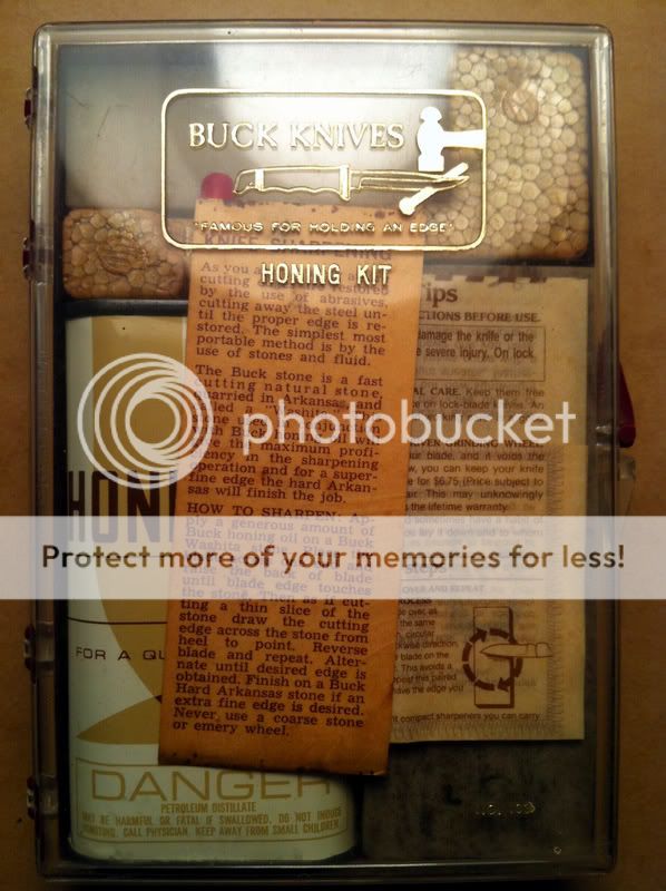

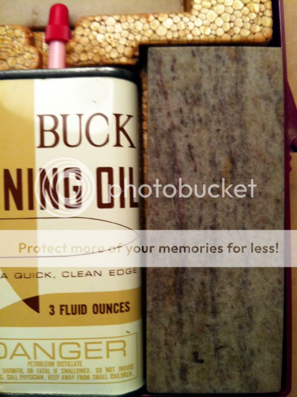

When my grandfather passed away his knives and sharpening supplies were left to me. Some really HUGE bench stones that make mine seem small. But one of interest is a small Buck sharpening kit. Its one of a few that he left me. Forgive the terrible lighting and cell phone quality, my desktop is crashed to use a real camera.
Here it is:
I know you are kind of an expert on all things Buck. Do you know anything about this stone?
Thank you!
BTW, out of that collection of yours what do you like the best?
One more shot, the Washita and then Hard Arkansas from the Buck kit.
Any clue? Thanks :)
Yes, that is Buck's model 133 sharpening kit. Brought out in the early 70's. The paperwork should have the 1717 Magnolia Ave. address. The Washita stone is the coarsest of the Arkansas's around 400g and the white hard 6-700g. I use the above Washita on my knife and the black and translucent on my razor. DM

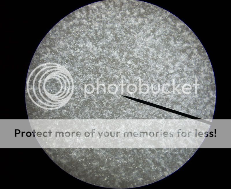

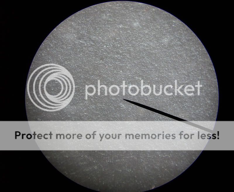

10x3 Translucent Arkansas
100x view
8x2 Translucent Arkansas
100x view
What do you make of these David?
