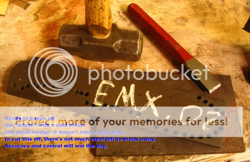

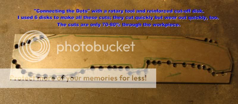

FWIW, I use an angle grinder with cutting disc to rough out a blank. It's a lot cheaper, although some of the knifemakers have horror stories about discs breaking and so forth. As long as you don't put a lot of pressure on it (especially not sideways), and let it do the cutting, it works well. Then you can clean up the profile on a belt grinder or dremel, or use files.
Harbor Freight sells a portable band saw that comes in sub-$100. That might be another option for WW, and you don't run the risk of shattering a disc. I've seen a few that have been secured to a bench or wall and a fitted with a little cutting table.

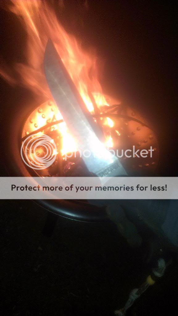

On a happier note, look what the wife brought home for me last night.... Fire pit! Its an early valentines day present. We always seem to get each other presents early and never on the days we are classically supposed too. Either way, I would say it was a REALLY good gift. Its stainless steel, very large, and works purty well. Christened it last night with some wood prepped with my Beckers. It was in the teens last night but in front of the fire it was quite nice. I said she did very well!

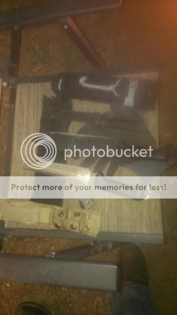

And a crappy pic of the tools I used last night.
Fire!
I just looked at that portable saw, pretty cool!! Ill look some more into options like that but space is really an issue here. I do have a pretty open basement but id be worried about not having any type of exhaust down there. Thats what stopped me getting a sander and doing scales down there. I didnt want all the dust and fumes trapped where i was working.
Yep, that table is pretty cool, but it runs 120 bucks. Also, you gotta get bimetal blades for it. An angle grinder is like 30 bucks at HF, and discs are 4 bucks for a 10 pack pretty often. One disc would rough out most smaller blades. Usually takes me 2-3, but then, I make BIG things. You still run the risk of being a fool and having your fingers eaten by the saw too. All power tools are dangerous. Find me a power tool that's not dangerous, and I'll find you one that's not plugged in (and even then, you can still hurt yourself).

Well, people do that... but it's not the best idea. See Todd's post above. If you're only doing one or two knives it really doesn't take long to profile it out, even with a hacksaw and files. Honestly, that's the easiest part. If you have access to a drill press (and you're going to want one), you can simply drill around the outline and "connect the dots". This was a Tracker/WSK style knife I did a few years ago... normally I'd just hack off the corners with an angle grinder and take it down to final profile on the 2x72, but this was an odd shape... anyway it just shows there's more than one way to skin a cat.
Now if you're going to do a dozen, or it's a big honkin beast with weird shapes like the M18, yeah it's totally worthwhile to have a waterjet place do it. With most places, once they have the file set up you can order more and it will get a little cheaper.

Incidentally, I agree with Crimson... an angle grinder is a perfectly good cut-off tool when used properly. That's what they're made for. I wear a full face shield and heavy coat when I use mine, and welding gloves. (it only takes once to realize that a shower of sparks straight up your sleeve is a pretty bad idea :eek: :p ) Don't aim the sparks at a pile of greasy rags or something, either.
