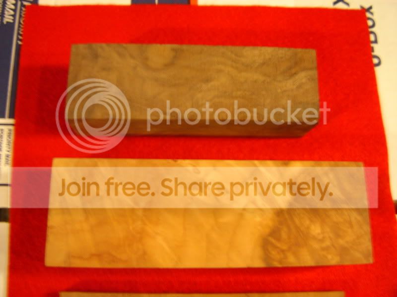

I found a link to Northcoast knives they had a Tutorial on Stabilizing Wood. This is what it said:
Stabilizing Wood
I love using stabilized woods: the grain really pops out , they have the consistency of micarta or Corian, and you are assured that they will never be affected by moisture or humidity. This means that they will never shrink, expand or warp,( a small but common problem when using any natural materials for knife handles) . Unfortunately, I'm also cheap and hate the cost of processed stabilized woods. Plus you're at the mercy of whoever you order it from, to pick a piece out of the pile for you. I looked at a lot of different ways to do this yourself to a slab of wood that you've fallen in love with without having to make or buy an expensive vacuum set up normally used. I modified a process that I heard about and found that this works mighty well.
Here's what you need to start: a one pint can of Minwax High Performance Wood Hardener, an airtight jar large enough to hold the scales you're treating , a coffee can large enough to hold the entire jar and a nearby saucepan to keep a constant supply of boiling water at hand. I'm going to do a nice set of maple burl scales here.
Safety note: When I first read about this home process, the writer suggested using a double boiler set up ( The jar sitting in a pan of boiling water) on a hot plate to heat the Minwax Wood Hardener in the jar. I'm not the brightest guy you'll ever meet, but this stuff has ketones in it. Uh...yeah. The fumes from the ketones are so EXTREMELY flammable that I could never bring myself to recommend this particular technique to anyone, no matter how well you think you can sit there and supervise this. IT"S DANGEROUS!!!!. If you really want to do it this way, make sure you do it in the home of someone you really don't like. Use Google to look up "Flash Fires". If you're using anything with ketones in it, try keep it at least seven miles away from any open source of heat.
Set the scales inside the jar and cover with wood hardener. Set the lid on loosely and set this inside the coffee can
Pour boiling water in the coffee can to surround the jar. The object here is to safely heat the wood hardener in the jar. By the way, please make sure the area is very well ventilated. The smell is very strong enough to strip wallpaper and will assuredly lower your IQ by a few points if inhaled for a long time. Outside is best, by an open window is a second choice.
Keep replacing the water as it cools off to keep raising the temperature of the wood hardener almost to the point of the boiling water. You are also opening up the pores of the wood. I put a very small hole in the base of the coffee can to allow the hot water to gradually drain as it cools.
You'll see the wood hardener bubble like ginger ale as the air is displaced in the wooden slabs. Keep doing this for about a half hour until the jar and the wood hardener is so hot that you need an oven mitt to hold it. I didn't say very warm, I said HOT.
Remove the jar and screw that lid down tightly. Remember your high school physics class? As the closed jar cools off, a vacuum will be created inside which will draw the wood hardener into those newly opened pores. Let it cool off slowly and keep the jar sealed for a week or so. The white stuff on the side of the jar is some of the wood hardener that foamed over the lip.
Take the scales out and let them cure in open air for a few more days. You can reseal the jar with the wood hardener in it, and store it for future projects. Wow, look at these things! Beautiful!. You'll also notice that since they soaked up so much wood hardener, they are twice as heavy.
Notes: This works great for 3/8" thick scales and the wood hardener soaks all the way through. I haven't tried this process with blocks yet, but I'm going to assume that it's best if you do some preshaping first to get the block close to a final shape before you do this. This also works best with softer woods ( like redwood ) and open pore woods ( just about any burl ). Some heavy and dense woods ( like cocobolo or ironwood ) won't work well, but they really didn't need to be stablized in the first place.
I am wondering what you guys think of it? Would this be a good way to stabilize the scales? John

Your knife looks good. In the future with walnut or other open grained wood (visible pores) try wetsanding with tung or true oil. The slurry that is formed will fill the pores for a smoother surface. Don't hesitate to experiment. That's how you figure out what you like best. If anyone messes up their wood or needs a little more, that's ok. I go thru the paypal payments and ship the beginner wood about once a week.
