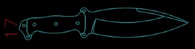

#17 with an 11" blade would be an insanely good chopper. But it would basically be a bolo. Convex grind.

#8 with expanded fuller, but a hair fatter at the pommel end, I think it needs a bit of a stop for retention on heavy swings.

Here are a few more. . . . All of these are shown with an 8 1/2" Blade and all approx. 14" OAL

I'm drinking coffee so here's my sober 2 cents :D... 10 or 11 of the above imge post would be sweet. I love the CBT and think it will look really cool on those angels like the HG55. I dig the size as well. Awesome desings though... all of them.
#17 with an 11 inch blade would be awesome and I would love to see it in addition to the smatchet.

Everybody really seems to love #17! It has actually grown on me quite a bit. I still think something is missing though. Maybe some cbt/lines like #10? Maybe small fuller? What are your thoughts gentlemen?
Also I think it would look better without the swedge...
I dig the lance leaf look of #10 and combine it with the swollen fuller of #12 just maybe a slight less swollen. Possible a little longer too, depending on balance
