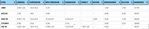

This isn't a downgrade.
AUS-10 has a bit more carbon and has some properties that may make it tougher.
It compares well to ATS-34, which is a fantastic steel.
I doubt anyone could tell the difference between AUS-10 and BD1.
