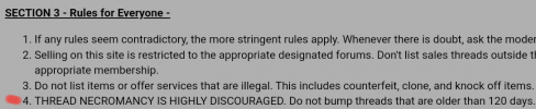

Sorry, but pointing out a forum rule is not degrading. May want to familiarize yourself with them...
Are you a moderator? People were clearly still interested, hence the multiple replies. No one likes a snitch.
That suggests I reported you, which I have not (yet).

This one was only 5 years old lol...he's revived much older across the forum. I only brought it up here because I was already responding to one of his posts and didn't know if he realized what he was doing. I get it...you search for something and don't look at the date before responding...it happens. But doing it on purpose? He may not care, but the mods will get sick of having to follow him around locking old threads he revives, and being on the mod's radar usually doesn't end well. Heed the advice or not...I tried 🤷‍♂️.
