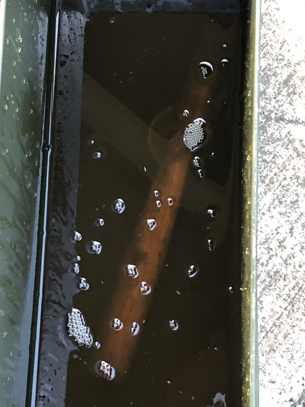

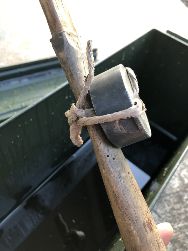

It's not much of a deterrent. When you want to kill off an active infestation either heat it to an internal temperature above 65C or put it in the freezer for a week or longer. Then you will have to take measures to prevent a return if you are prone to these critters in your area, ( I use borax). In this case however it's academic because that handle is far gone, the only thing left, to use it till it breaks - may be your first substantial swing - and replace, putting aside all fetishization of old tool handles and fantastic dreams of the properties of blo.:)
Look like powder post beetles. Ernest gives some great advice. I would go with heat over cold, I'm not sure about the families in your area but they could well have cryoprotectants in the egg stage. I would imagine they are more apt to deal with excess cold then excess heat where you are. Heat in general is the standard, but make sure to hold it @ ~150°F for an hour or two if insects are still coming off the peice you're working with. Mostly we just see signs of where they have already been.
