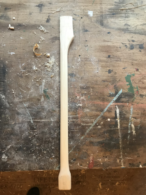

Well I had a less than stellar day today. I had been working on fitting a nice piece of ash to a Campbell's hammer poll head over the last few days, but the shape of the inside of the eye had been giving me trouble. It's hard to describe, but the back of the eye protrudes out in the middle and while fitting the head I got it majorly stuck. So unbelievably stuck that I considered using the axe as is without cutting a kerf and wedging.
Went to use someone's vise since I don't own one and had the hammer part of the head clamped in soft jaws. I beat away at it with a giant hornbeam mallet and it finally budged and eventually I had the handle out. Only to realize to my horror that the back of the handle had been resting on the bottom of the vise and while I beat it out it peeled up a huge splinter.
The piece of ash was already just big enough and there was barely going to be any shoulder at the back. I think this one has just become firewood.

I have a few sticks of ash and locust drying for the day I decide to try making my own handles. When that day comes in a year or two, I would love to have some replicas of vintage (or some of the lovely work people here are doing) handle patterns to work off of. Anyone have an idea of how we could add something of a handle pattern library to this thread? Best I can come up with is make a tracing of that awesome handle you have, shoot a photo, and upload with the length of the handle in the thread so we can scale the image and print it. But there is probably a better way. Just a thought.
Just to update on my gory handle pictures. I decided to make a back wedge. I'm including a few pictures to offer a glimpse into woodworking in an apartment. Glamour there is little :D.
Knocking off as much as I can with the axe and leaving some on the end to hold while whittling.
The fit is solid. If I were to do it again I would shave the handle down so that the wedge makes up a larger part of the wood filling the bottom of the eye. As it is now I'm afraid I would eventually wear the bottom of the wedge out from driving it out to disassemble. Luckily, I don't think I will be packing this axe anywhere to have the need to take it apart. Unless by chance an opportunity to build a ship miles back in the wilderness falls into my lap?
