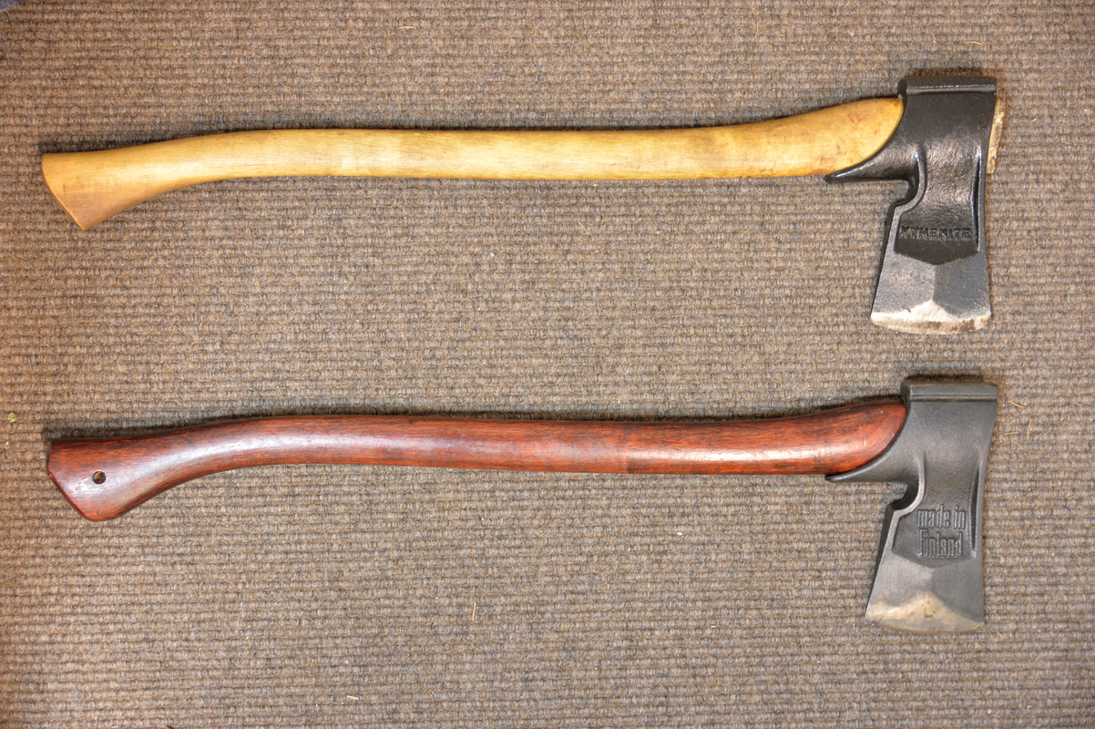

The thin blades are the optimal form for Debranching and pruning. The wide cutting edges i dont want to miss aswell, it is so much easier to hit Branches and not your handle. (A thing mentioned aswell in 1959 about swedish axes, seems they did not learn half a century later...)
And the refiling is also faster because the blade stays thin for a longer distance.
I find that with the "D" shaped eye i can make rehandling easier and faster, i had a more difficult time with the oval (not symetrical=different radius on front curve) eye on my Prandi axe.
I would get a Biber "broad" its 10 or 30 mm wider than the normal Biber, a few 10s of mm are the difference between a blade hit or a handle hit when a bad strike is made. I would get a light version, max 1200 g.
For debranching of Leafwood over 1,0 fm (m³), a mass of 1250 g was recommended in 1959. Under 1,0 m³ its 800-1000 g.
Müller told me by email that the difference between the Biber (Light blue) and the Classic (forge finish) is in the steel quality and finer grinding.

So if you got a thick blade, unlike the 3-5 mm ORIGINAL Iltis or Müller Axes of today, you use no more than ~0,5% of C for the needed Toughness. As is the Case in Müller axes.
As we know Ochsenkopf in their Iltis today, uses 0,6%C, unlike ~1960.
They dont need the Toughness since their (stupid) thick Axes dont break either way and the People that use them dont sharpen them thin (i use 14° on my Müller Biber, Putzhacke and Tiroler Asthacke. My Prandi Dayton can not handle that Angle without bending. So i do not recommend it anymore. If someone interests this, i added this information?)
If you want a Iltis than get an original one from ~1960 (idk when they became bad and fat) or a Müller Biber.
My Müller Biber is 7,9 mm thick, in a distance 80 mm from edge. (Axe 180 mm long)
My Putzhacke 7,8 mm. (Overall blade is thicker quicker, but 20 mm longer so its the samd thickness at this measuring point)
My Tiroler Asthacke 7,5 mm. (Axe is 195 mm long)
(+-0,5 mm, since the thickness changes if you measure closer to heel or toe and how you reference "distance from edge" perpendicular from edge or Nape, bla bla bla)
The original Iltis (the non plus ultra) is 4,9 mm.
The Ochsenkopf Iltis today (I asked Ox by Email).....11 mm...
sad...

Part of the problem is that you would need some very complicated diagram drawing and measurements or 3D scanning to really generate meaningfully useful information. It's otherwise just a bunch of numbers that aren't really *useful* for much. There's a lot of variables involved that aren't exactly the most trivial to record, and having only partial figures is not very useful without the context provided by the less-easy-to-measure aspects. This all takes a lot of time and effort without much payout so most folks will probably not actively contribute to such a project.

The Finnish axe you are referring to is Högfors 10.
It was made by Högfors foundry using Kymenite ADI (Austempered Ductile Iron), a patented material developed in the early 1970s. The radical axe design came from the company advertisement department assisted by designer Jaakko Ahopalo. The developmental models were known as 10, 20 and 30. Model 10 was the final model and was produced in the early 1980s, but only in limited numbers as there were problems in use with fractured polls.
The axes are extremely rare but luckily I have these two:
If I´m correct there was also a smaller version Högfors 11.
