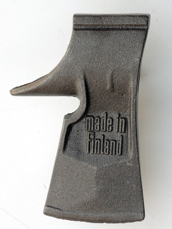

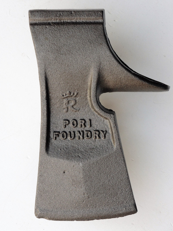

The Finnish axe you are referring to is Högfors 10.
It was made by Högfors foundry using Kymenite ADI (Austempered Ductile Iron), a patented material developed in the early 1970s. The radical axe design came from the company advertisement department assisted by designer Jaakko Ahopalo. The developmental models were known as 10, 20 and 30. Model 10 was the final model and was produced in the early 1980s, but only in limited numbers as there were problems in use with fractured polls.
The axes are extremely rare but luckily I have these two:
If I´m correct there was also a smaller version Högfors 11.
Additional info: just two weeks ago I was able to buy this, an unfinished in-the-rough axe head casting by Rosenlew Pori Foundry, quite similar to the Högfors 10 model. The seller told me that these were given as gifts to customers and that he has one fully finished and hafted version. How this came to happen is a mystery. Please note the additional ridge of material at at the cutting edge, presumably to make sure there´s enough good material for final finishing. As for its scarcity, I´ve never seen one before:)

After WWII the idea came up less and less. I'm aware only of a Finnish manufacturer Hogsfors who tried,and failed,to produce axes by casting in the 1970-ies. Otherwise all was quiet on the casting front.
Today to my knowledge only Ivan Tasev,in Bulgaria,is still experimenting with the process. He's an excellent metallurgist,and has gotten a hold of some dinosaur soviet equipment to play with,and is actually producing axe-heads that are cast.
He sells his tools on ebay under the handle "mapsyst",and also has a site,you may try http://axessive.com/
(He's a nice guy,very approachable,possibly you can pick his brain in regards to details).
Other than that again the odds of running into a cast axe-head are rather long,it was never a practical Or a cheap way to produce axes,and again-the result would in no wise be of an inferior quality,not for reason of it being cast in any case.
