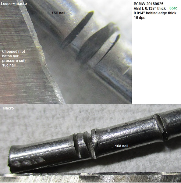

I agree - now, please come up with a marketing jingle for 2 aebl knives below
aebl 0.188 (3/16) thick, 1.75 wide/height, 64+rc
K1) look like bladesports shape, except front/tip is slightly curve for pry husk (especially brown).
K2) ffg big belly 3.5" blade for pressure cut green & brown coconut.
* I pressure cut quite a few green coconut with my little 65+rc W2 knife - need a strong thumb to push through the almost brown nut
edit: crank up the ht oven to cook aebl - the two .196", 1.5" wide, plus a couple paring. Dead aim for 66rc.
Chris "Anagarika";16214276 said:Luong,
The grind line on the video shows clean and flat. The chopper works well. With BCMW HT, a stainless (less maintenance concern) will be very desirable! :thumbup:
Especially for coconut processing, you don't want the patina blackened the nice white flesh.
