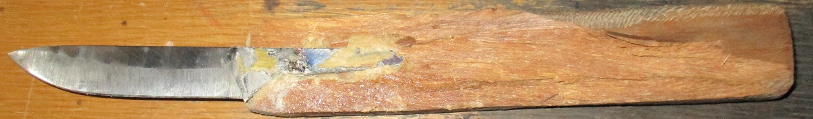

Chiral - the 67.25rc blade tang didn't shattered because it was torched (by a mini torch, while the blade in water) beyond spring-tempered. Video ended when the wood handle cracks in 3 sides.
After 2 additional round of testings - the handle was too broken(after fixes with CA & expoxy) to continue. So I dug/split the handle to examine what inside look like...

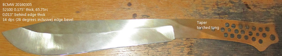

52100 0.175" thick jest bolo: aimed for 65rc, would like 66rc, got 65.75rc
Multiple-chops 2x4 in less than 10 (mostly around 8) hits. Very deep penetration into seasoned oak. Small olive branch seems to explode on impact (several times) - Twice, I thought the edge was a goner. A best one among JB bunch - thinness reigns!
OK now, it's too thin...
when too soft = rippled & rolled
when too brittle = cascade failure or a very large chip
No roll nor chip, just rippled.

In the process of hardening the 2nd 0.325" thick JB. 66-66.5rc is the target working/in-use hardness. Will full zero grind this chopper, then reprofile to ~0.01" BET, 12/15dps (12 bevel, 15dps micro w/ face length ~0.002").
Why BET(behind edge thickness) is so thin in light of my rippled edge above? After some analysis & thoughts (didn't test yet, just brain) - micro steering lead to macro deformation. So 15dps or 20dps (if need be) could stop an initiation of micro steering. I think, 2" FFG with edge geometry 0.01" BET at 65+rc has enough backing to support hard wood chopping activities. Just don't hack rocks.
edit: tested against knotty 2x4 and oak: 0.175" thick 52100, 0.01" BET, 12dps/15dps-micro. Passed.

0.175" thick 65.75rc 52100 JB, 12dps/15dps-micro, 0.042" thick at 0.25" up from apex.
Against knotty 2x4 & oak: 0.008" BET. Passed.
Against knotty 2x4 & oak: 0.007" BET. Passed.
Against African Blackwood: 0.007" BET. Major chips, then quickly destructed. v-notched/chips toughness is below my expectation. From breakage surface, I have a pretty good idea what is/are not optimal.

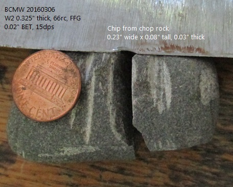

0.325" thick W2 JB, 66rc, FFG (decided not zero full grind)
0.02" BET, 15dps (no micro)
Chop tests:
2x4 - passed.
oak - passed.
olive - passed.
African Blackwood - passed (20 chops) with a small chip.
Sand stone - passed (1 chop split).
Granite rock - 1 chip (2 chops); pic below
Next - thin BET to 0.01" and sort of repeat tests above.
