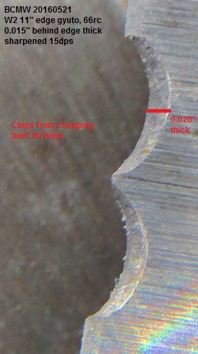

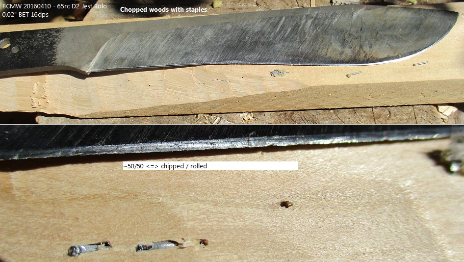

D2 (was 64rc) 63.5rc@475F. Reprofiled back to 0.015"BET/15dps. Passed all tests with intentional mis-hits.
Aebl 61.75rc@350F (5 readings) 0.017"BET/15dps. Done twice - edge rippled when baton AB. Quite low macro hardness and micro hardness isn't that far behind macro but sub micron hardness must be quite low. Definitely a case of edge steered by nano weakness - yes, start small but lead to ripple up to 0.035" height (up from apex). This blade is perfectly fine for normal hard usage. I like it able to withstand abby-normal usage

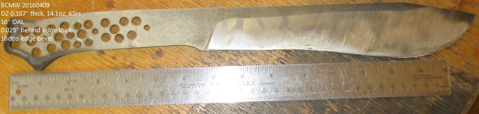

Ht-ing 4x paring size D2 .110" thick blades with slight ht param deviation per each blade. Target testing hrc at ~65rc.
