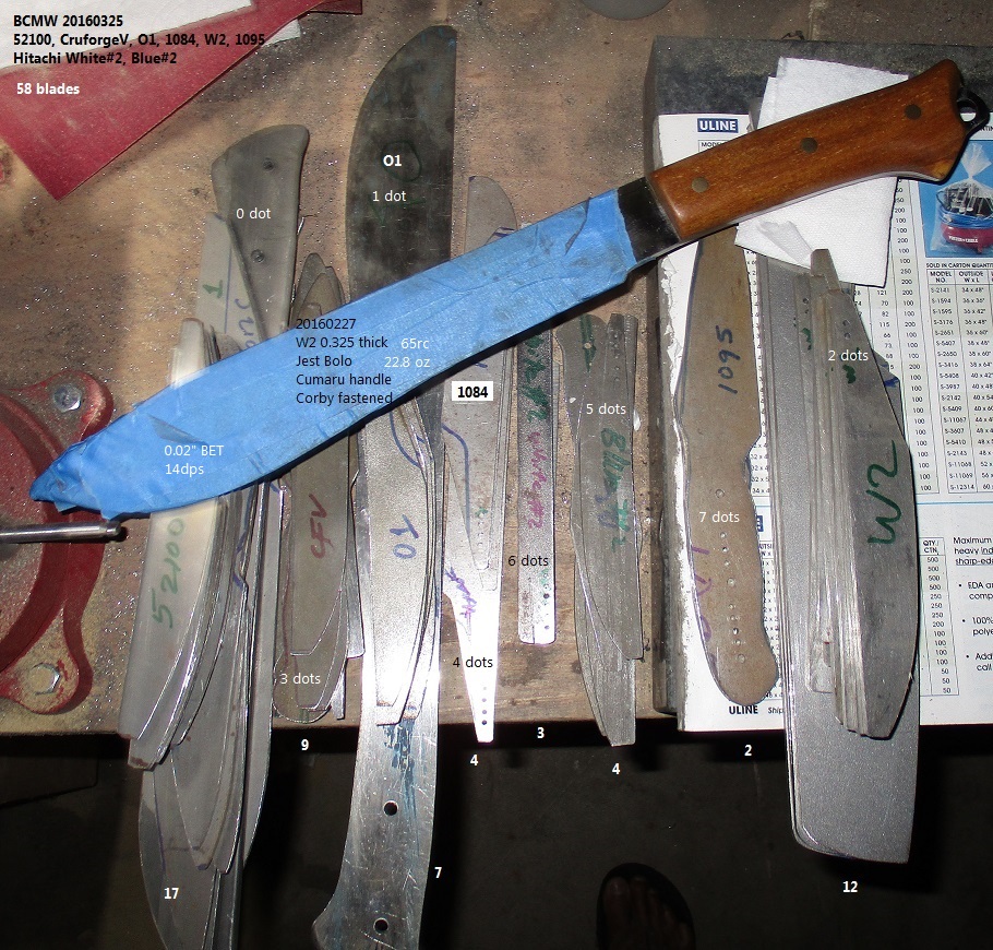

Ok, so I just watched the video. Believe it or not I don't think you stressed the knife that much. Good beginning test, I think that 67 is way to high based on how quickly your edge damaged on one nail with one hit. But I do think that most steels would take damage quickly at 67 Rc so no surprise there.
Thanks for watching and remark. If you happen to know test of untempered high rc blade, please post links. Thanks
I found bouncy baton through nail is very harsh, when force exceed uts and plenty of lateral bad damage is guarantee.
No one is abusing high Rc blades for exactly the reason that yours took that damage. Remember, it was one blow that caused that damage. I am sure the point is to see if there is stress crack propagation and there was none which is perfect. So your test was successful, but I am sure you know that there is no way that you can make a 67 Rc blade tough. Even with a more obtuse edge geometry, you will still have damage quickly.
Your statement is accurate in the context of abusing a 67rc blade with edc edge geometry.
On other hand - I see. This exactly blade spec would performs very well for folder, small fixed-blade, kitchen knives. IF so then this untampered blade isn't like glass to be broken, right?
Even if a blade made by re-arranged atoms, when force exceed uts - there will be damages. Just hope the damage will be local instead of catastrophic global.
I've heard it said that with the fine grain steels like W2, 1095, 52100, etc, that highest "apex stability" is at the as-quenched hardness of 67-68. Now I wouldn't have guessed that myself. I would think highest apex stability would be found at a high RC number, maybe 65-66, but with a low temperature temper to help relieve quench stresses. Interesting test, Luong. I check this thread every day!
