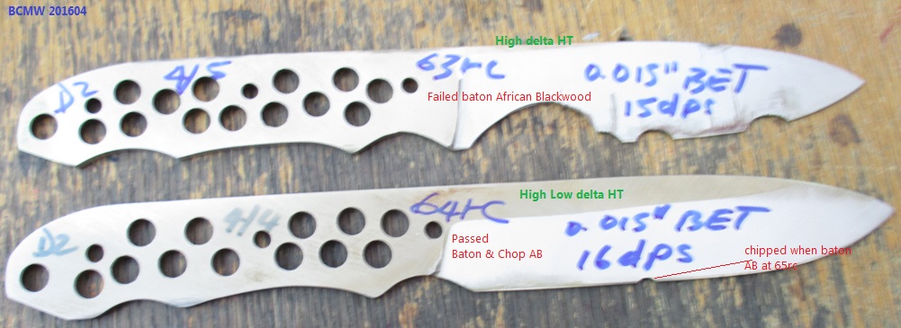

Sadly spent Saturday morning with work but got a fun ht afternoon. Used applied ht1 & ht2 formulas adapted from low Cr steels ht formula.
1 Aebl ht1: 60rc AQ = failed.
1 3V ht1: 65.5rc (AQ & 275F) - good edge stability & feel sticky sharp after 80grit belt. Plan to temper this hardness down to 64rc before baton 16D16(0.16" dia) nail.
1 3V ht2: 60rc AQ = failed.
1 D2 ht1: 67RC (not a typo) AQ; 65.5-66rc 275F. Survived baton African Blackwood. Lost 1" tip when baton 16d16 nail. Will temper down to 64rc then baton 16d16 nail.
1 D2 ht2: 64rc AQ & 275F. Very high edge stability. Edge(13dps) damaged up to 0.022" cross section when baton 16d16 nail. <== :thumbup:ht formula Whittled steel rod -> got carbide serrated edge. Didn't see any sign of large carbide fracture.
All these blades have sub 15dps edge and BET between 0.015 to 0.025".
I see possibilities of chopper blade using aebl/d2. While 3V is given but why using it when aebl or D2 could be as good... LOL, of course, I will make a few chopping blades to test this projection/conjecture. btw - I already made 10+ paring blades in aebl with hrc 63-65, so it needs just a little ht mod.

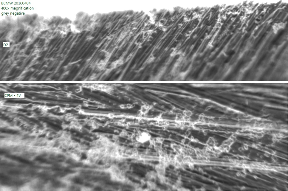

edit: looked at D2 ht2 under 400x metallurgical scope - scanned 2" long strip near bevel shoulder. Just eyeballing (lost my laptop, didn't setup another computer yet)- found 1 broken up carbide about 10um. Next largest about 3-4um. Look like I need to complete break up & distribute any remaining large carbides larger than 1um <= would be ideal but won't be easy.
edit2: under 400x magnication - D2 ht1 look like D2 ht2 as it should - hahaha. 3V ht1 - carbide in 2-3um range, didn't see any large carbide w/i 0.25" scanned. W2 65rc largest carbide I found is around 500nm, most are barely and not visible. it need nital etch (I might do that) before seeing the rest of carbide & possibly grain boundaries.

Ht & tested 4 blades
aebl: 62rc AQ, 60rc 350F = failed.
3v: 65rc AQ, 61.5rc 350F = good hardness drop-off curve. Will destruction test it later. Next ht will target for working 63-64rc.
2x D2: 67rc AQ, 64rc 400F = similar behavior as previous D2 ht1. Passed baton African Blackwood at std edge geometry. Next ht target will target for 64rc at 350F.
400x magnification (actually 40x len + 25x eye but optical is 400x) for D2 & 3V look great.

1) Baton through Burly African Blackwood: 67rc chipped to 0.04" thick cross section. 65rc chipped to 0.02" thick cross section.
2) fixed 65rc blade 0.02" BET and 16dps. Battoned 10+ times to that piece of African Blackwood - no edge damage.

Just hookup the microscope to an old laptop - to be calibrate.
White blobs/dots are carbides. 4V carbides are clearly visible sizes between 2-6um. At this resolution, camera dropped probably half of D2 submicron carbides.

tested 0.125" thick 65rc 5" blade D2 0.015" BET, 14dps. Got a few micro(need loupe to see) chips after baton AB. I took a small risk of big chips at 65rc but not bad outcome in spite chopping around with this full tang d2 blade. I will temper this blade down to 64rc.
Looked at W2 65rc 0.012" BET after Baton AB under 22x loupe - there is 2 micro chips (1/2 size of 65rc d2) and micro rippling along apex. Well, I sharpened that edge to 5K grit, so yeah apex radius was too thin.
20160405, my ht wandered back to how a normal ht D2 behaves at 63rc. hardness 66rc aq, 63rc 400F.
