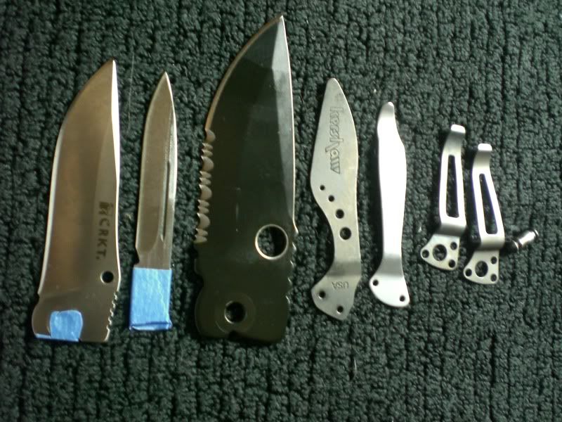

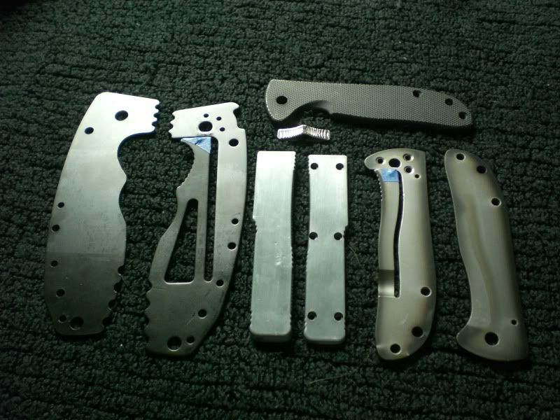

Ok. So I've finished my tedious disassembly and packed up the good to be shipped out. Here's a pic of the stuff to be done. Let me know if I'm good to go.
I'd like to get these as rough as possible for maximum grip
Some to be stonewashed
Some to be satin finish

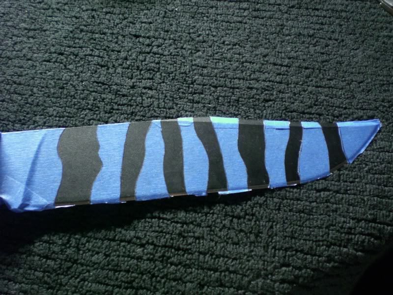

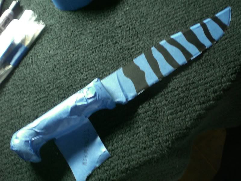

And lastly my KaBar to be tigerstriped.

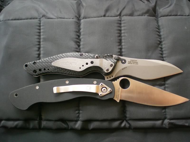

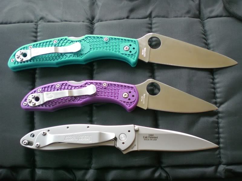

Ok so I got my package in yesterday and couldn't wait to get this stuff assembled. Everything came out perfect.
First, my Tigerstripe heavy bowie

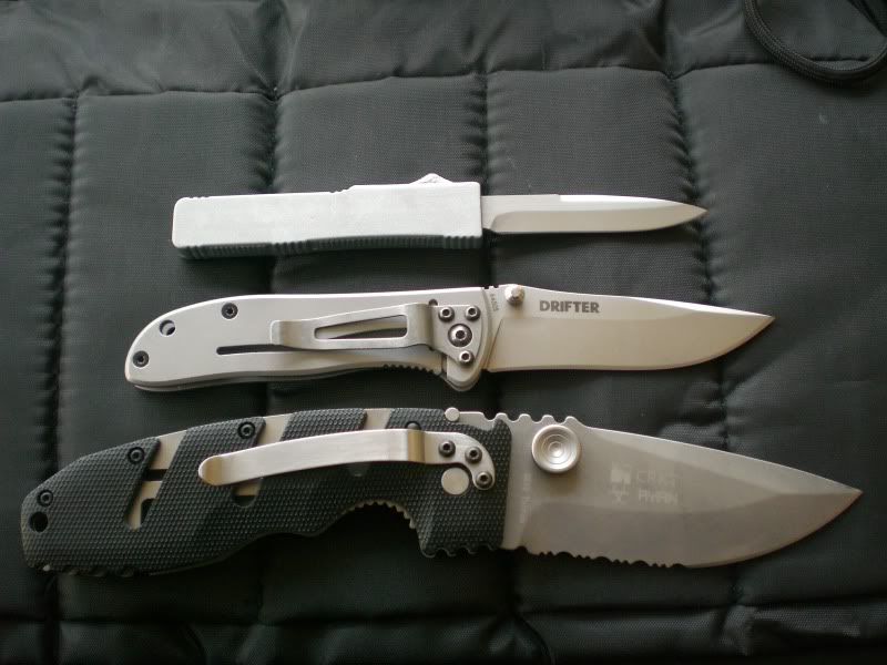

All metal parts on these are stonewash. I really disappointed myself with the drifter. I had planned to use a G-10 scale on the front and a framelock on the back. This meant using a liner with the G-10 but alas the pillar holes on the framelock side did not match the liner side. Just off by a couple of mm's. So I ended up going all metal. These handles are really grippy;).

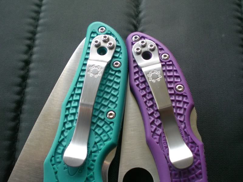

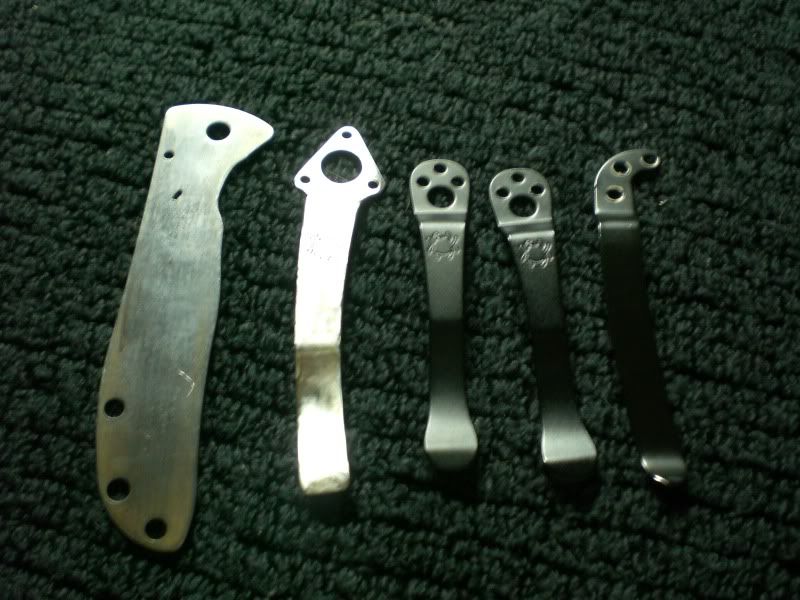

Some polished clips
The millie clip is satin to match the blade and the spec bump clip is stonewashed to match.

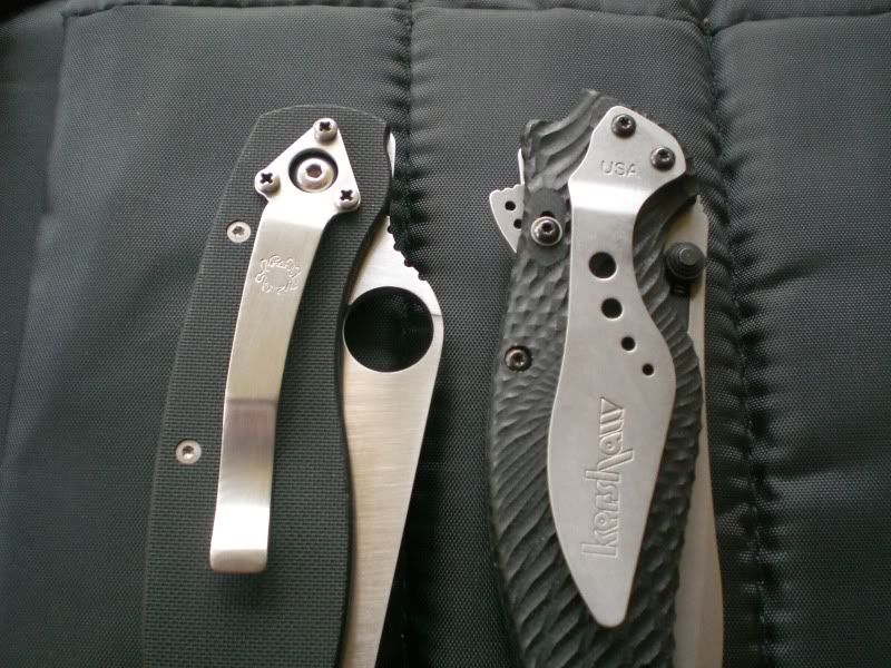

A quick pic of the some of the goodies that made their way back in the last batch.
As always many thanks to da man :thumbup::thumbup:
