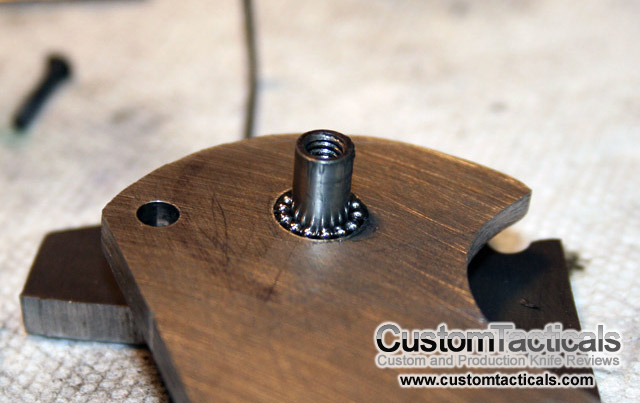

You get different type of bearing system approaches the same as you get different washers.
Normal IKBS:
Double-row roller bearing system
KVT:
Andre THorburn and Andre van Heerden Munlti row IKBS:
There are other I cannot seem to find such as GTC etc. IMO bearings done right is harder than washers and requires more attention to detail. YMMV just my 2 cents.

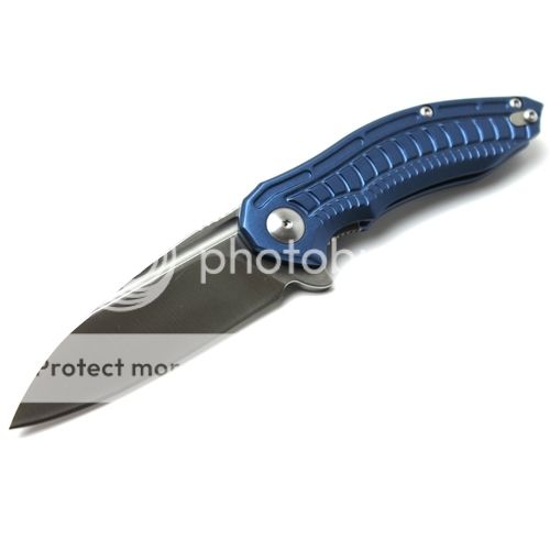

No, its on bearings, and I find it to flip very well. The main differences with the 2.0 is they removed the jimping from the handle and softened the shape of the flipper.
My Bionic 1.0:
Bionic 2.0:
