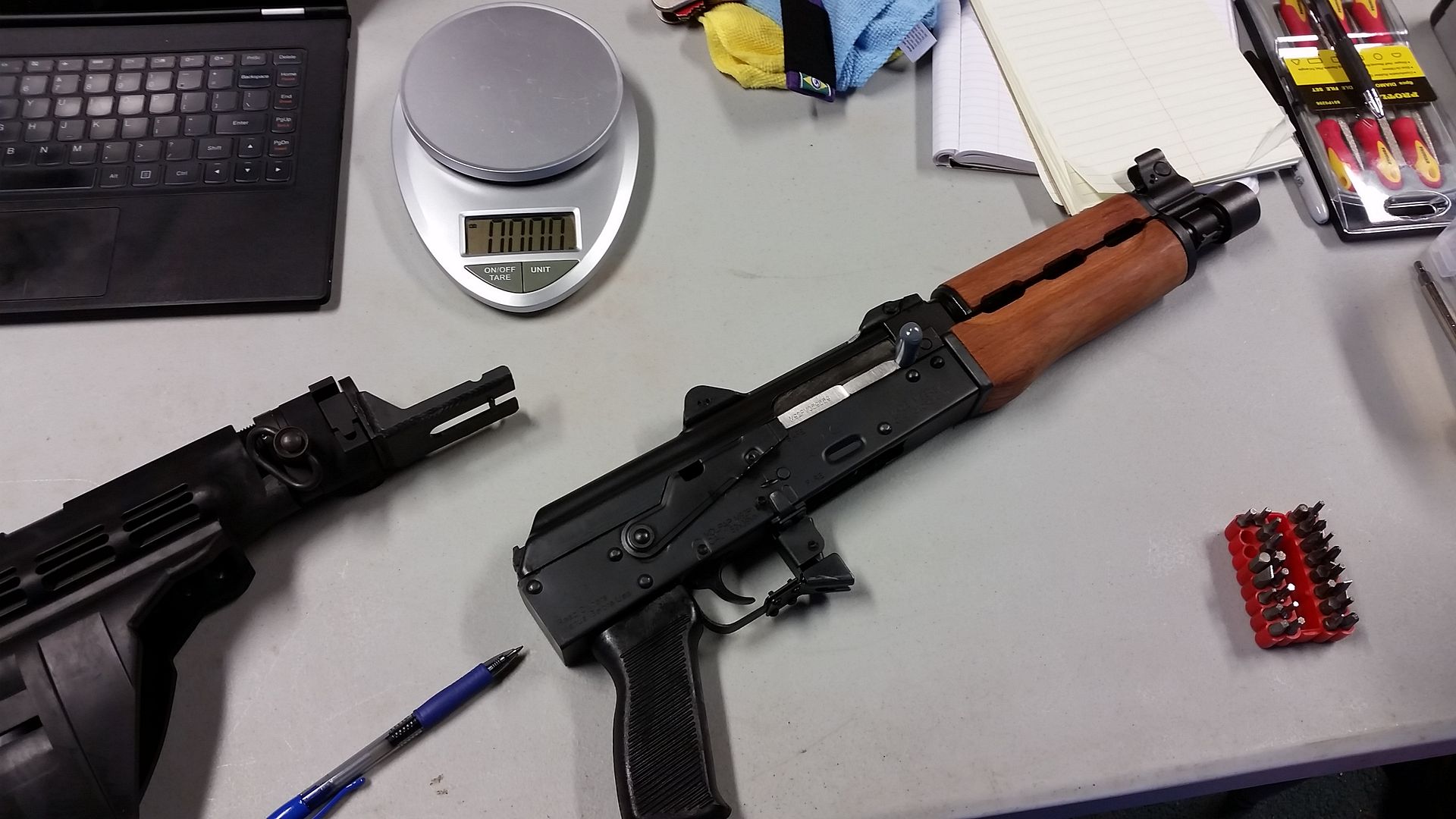

Got me a new toy: Yugo M92 pistol.

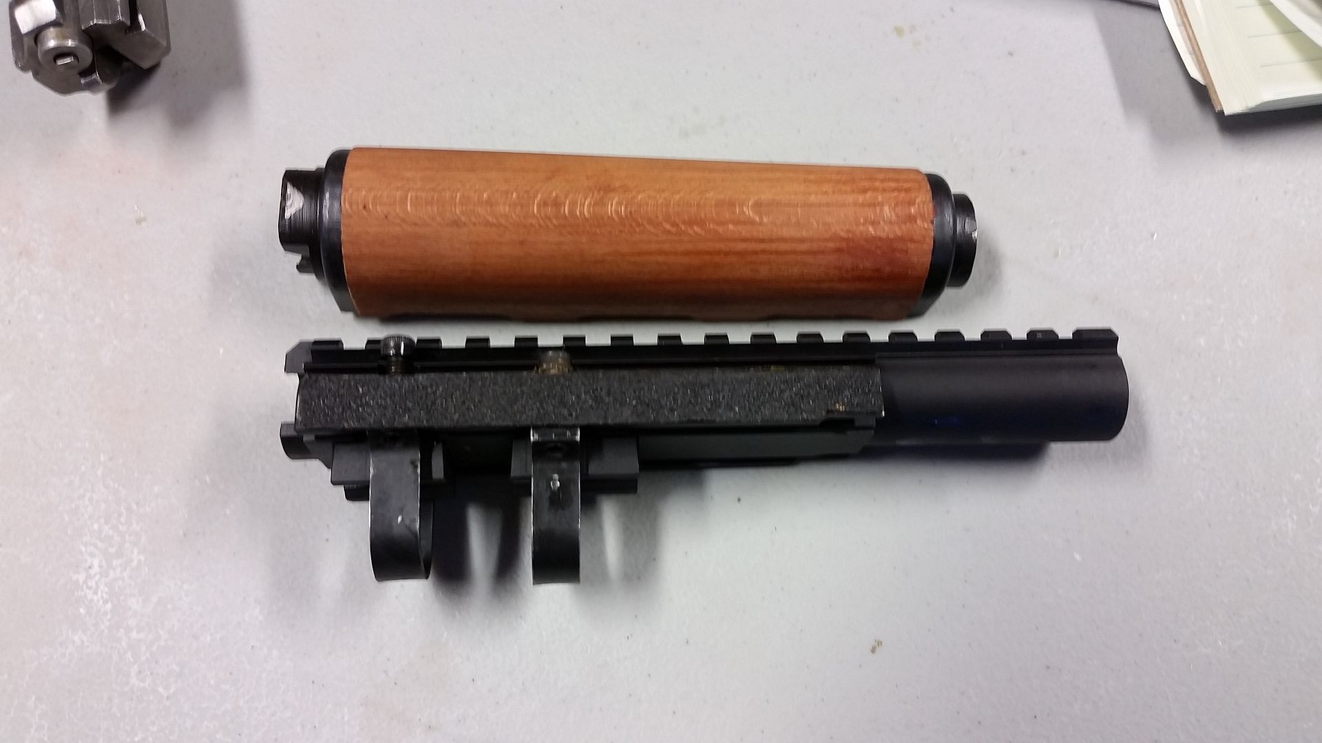

Had a spare Ultimak M1-B rail, so I dremeled, filed, and throated it to properly fit the shorter piston.
M1-B next to the m92 original gas tube:
Dremeled, filed, and throated.

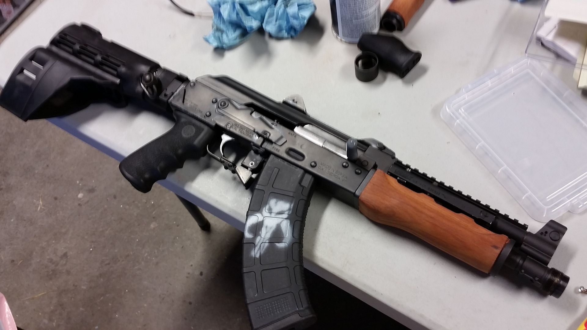

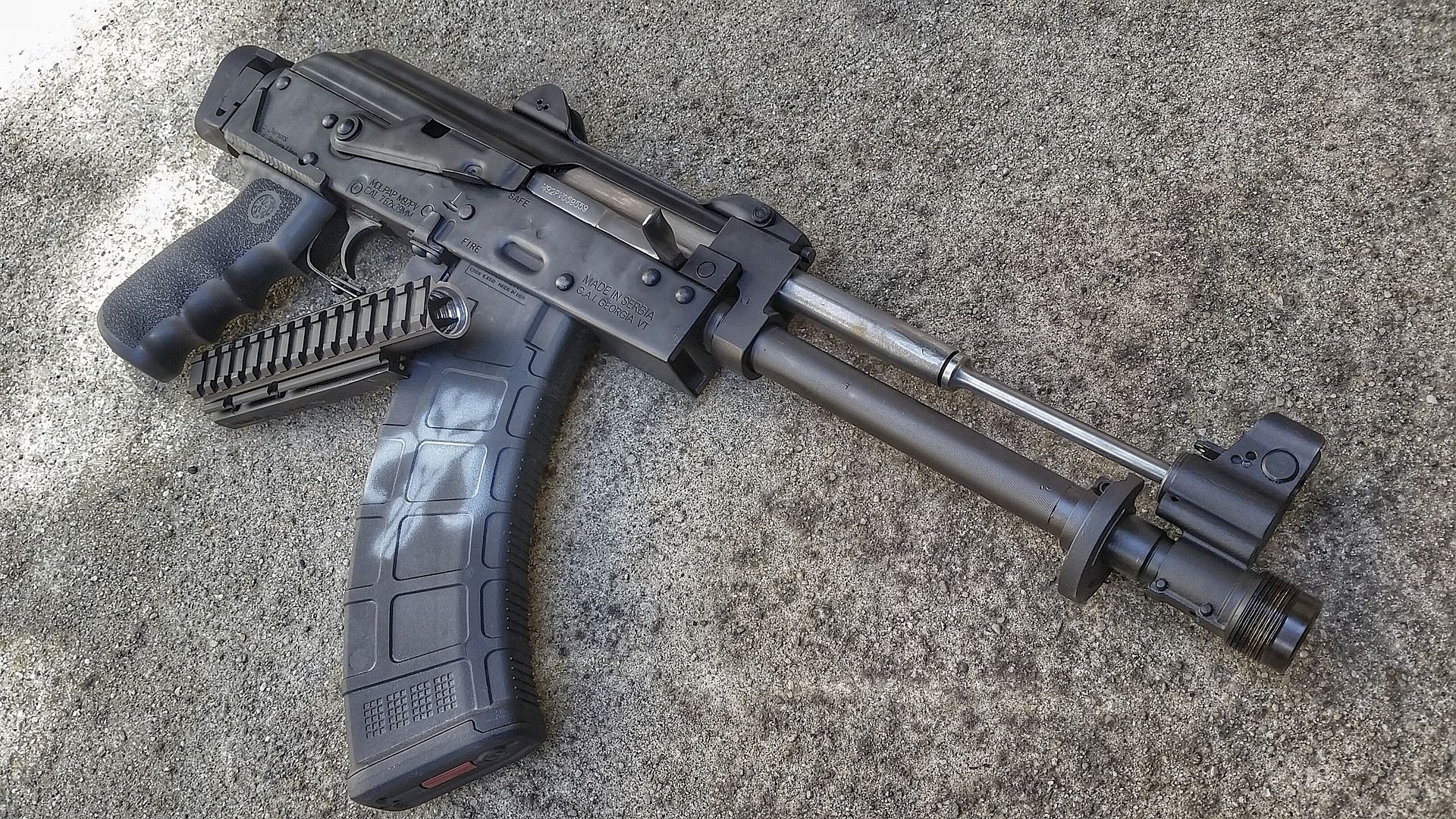

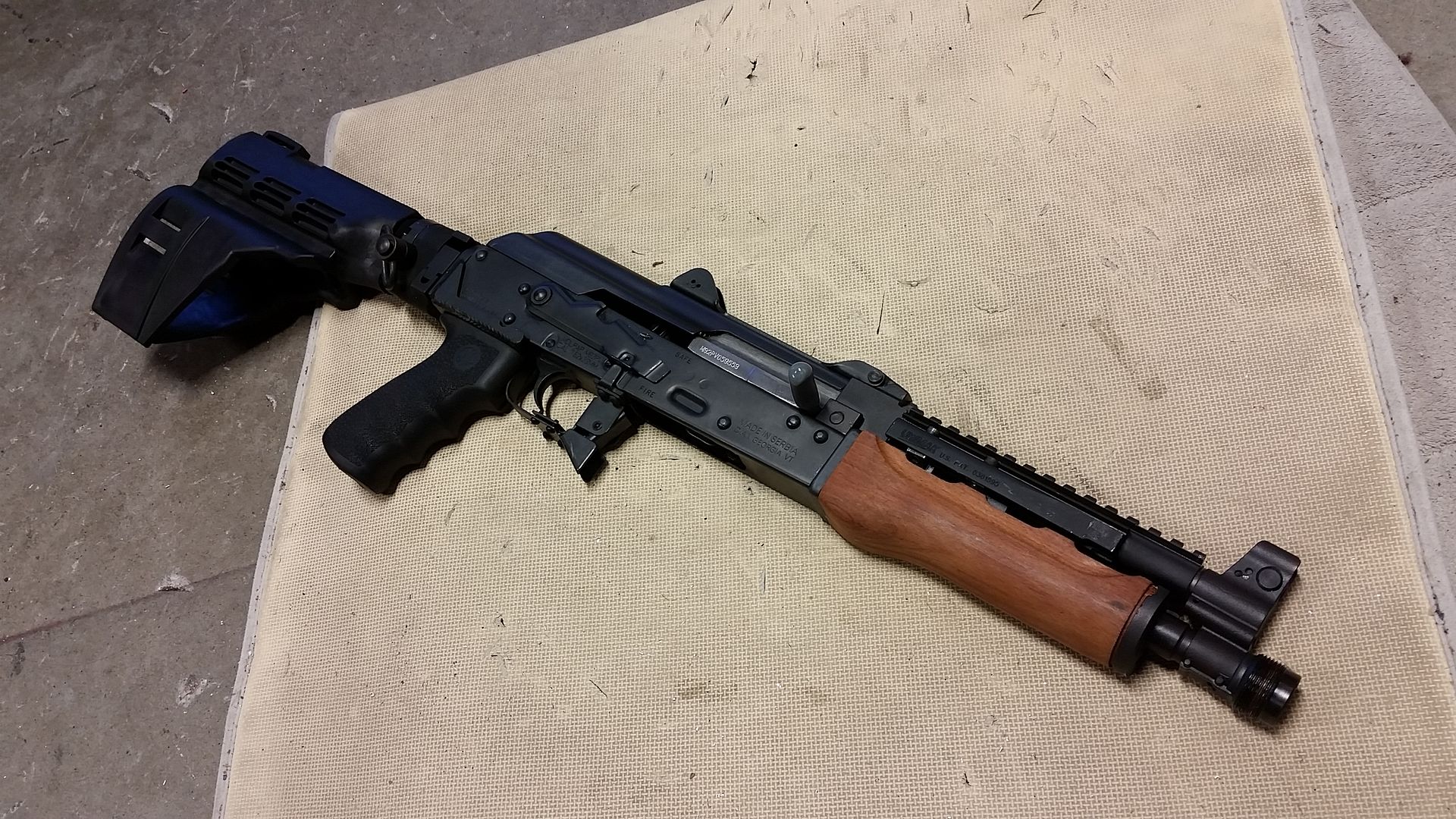

Had a few other spare parts: Hogue AK grip and an SB15 brace. I bought an AK hinge from Stormwerks, and because I'm apprehensive about tapping and drilling a new firearm, I bought a grip adapter and mounted the folder to that. Adapter is a whopping 7 or 8 oz, it's significant.
Here's everything mounted.
7.5 lbs unloaded and no magazine. Hefty for what it is. I eventually want to replace the SB15 for the lighter Shockwave blade, which should drop it down to just under 7. If I ever get brave enough, mounting the hinge directly to the rear should get me closer to the 6.5 lb range.

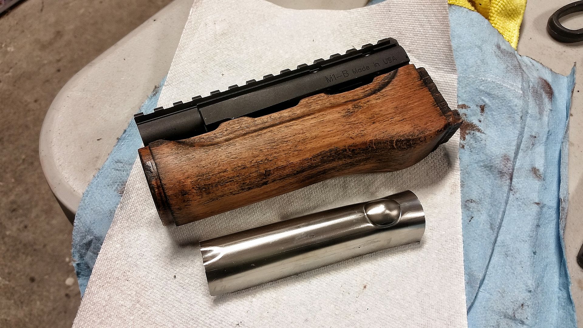

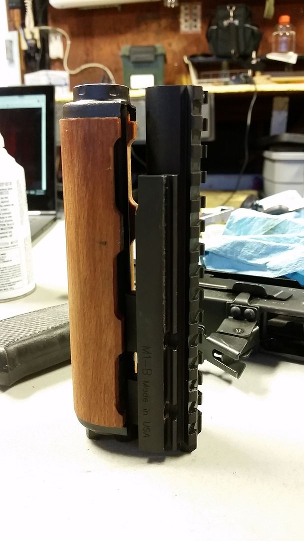

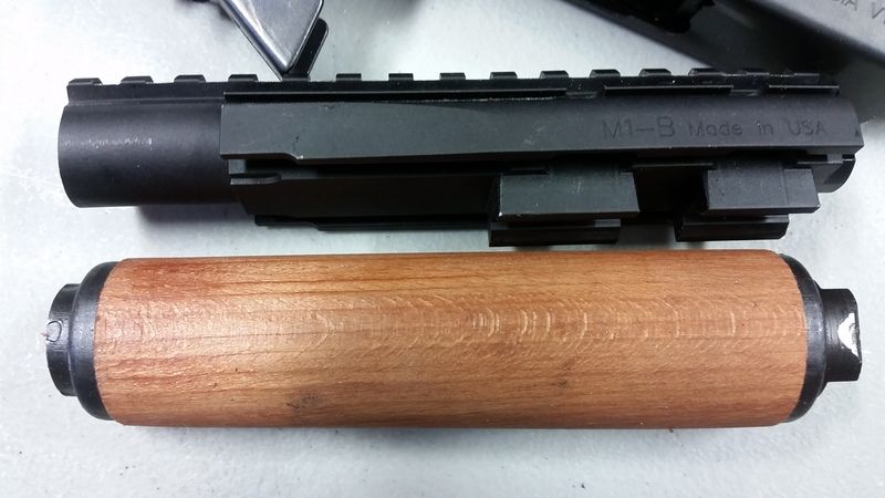

Stripped her down to work on the handguards. Good angle of the Ultimak's throating, nice and shiny.
Handguard was stained initially with ebony, which brought out the grain. Red oak 3 more times, it's not as dark as I want it, but it'll do. It's temporary until I can figure out what direction I want to go with the lower handguards. I shaved down a heat shield from another handguard and plan on putting that on as well.
