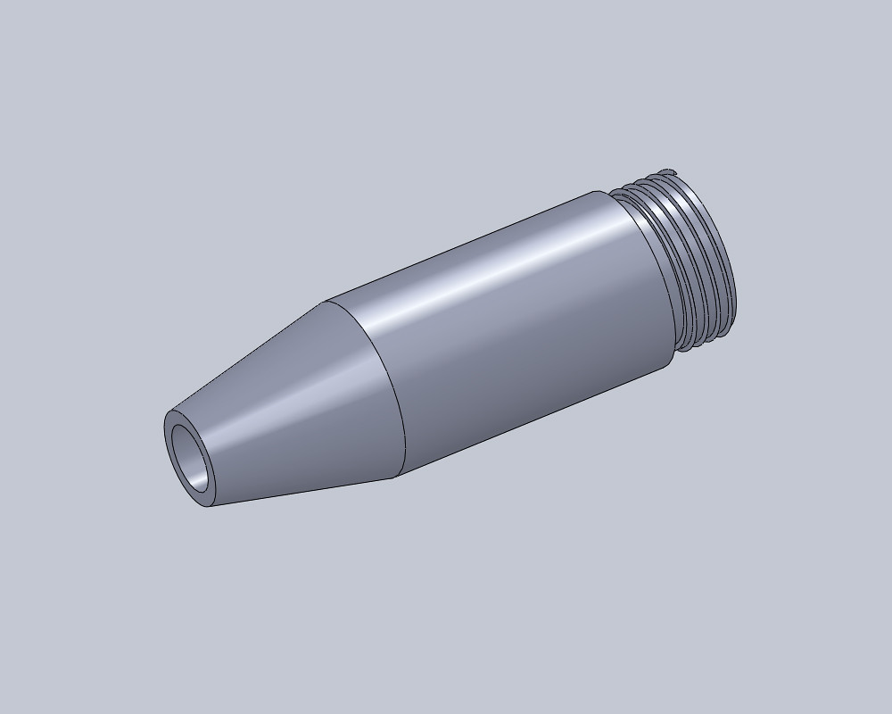

Derailed? I think not, here are the dimensions I first gave Flexxx for the kit. 3" long 1" OD tube, 3/4" ID, threaded but cap, with a groove for an O ring. I would like to see it sealed at the bottom, tapered front, with a 3/8" hole for epoxying in a GG firesteel.
Textured outter, and a finger groove along the tapered front. Stainless steel was my preference, I like tough stuff.

Show me something similar or sketch me something on a napkin so I have an idea as to what you are driving at.
I just downloaded some free cad/cam and am working on the moose disign...
I will show pics ASAP.
So, given your measurements, something like this? (Keep in mind, rough draft. I am eating pizza.) With an end cap that fits over the end, texturing, and a groove on the beveled front part, etc...

As far as the sketch, think ESEE fire kit, but more moosely. I break stuff real easy, ask Mistwalker, he's been my gear pimp here lately.
Moose
YES!!!!!!!! THATS IT!!!
But I need a 1/2" wide groove across the fron taper, but yeah, thats pretty much it.
Moose
Welp boss, you want more Moosely, it is gunna have to be a bigger OD than 1" if you want a .75" inner chamber.
Minus the inner chamber, that leaves us with .25" for the walls. That is .125" for wall on each side. That is .0625" for wall that is half that to accomodate a lid, and even less for something threaded.
1 1/8" might work. Not really sure though. Never done threads before on something.

I actually imagined the threads being cut in the ID, I figured 1/4" of difference in the OD/ID would render 1/8" thick walls, plenty of room for threads, but hey, ya'll go this on lock, I'm just the motivator.
