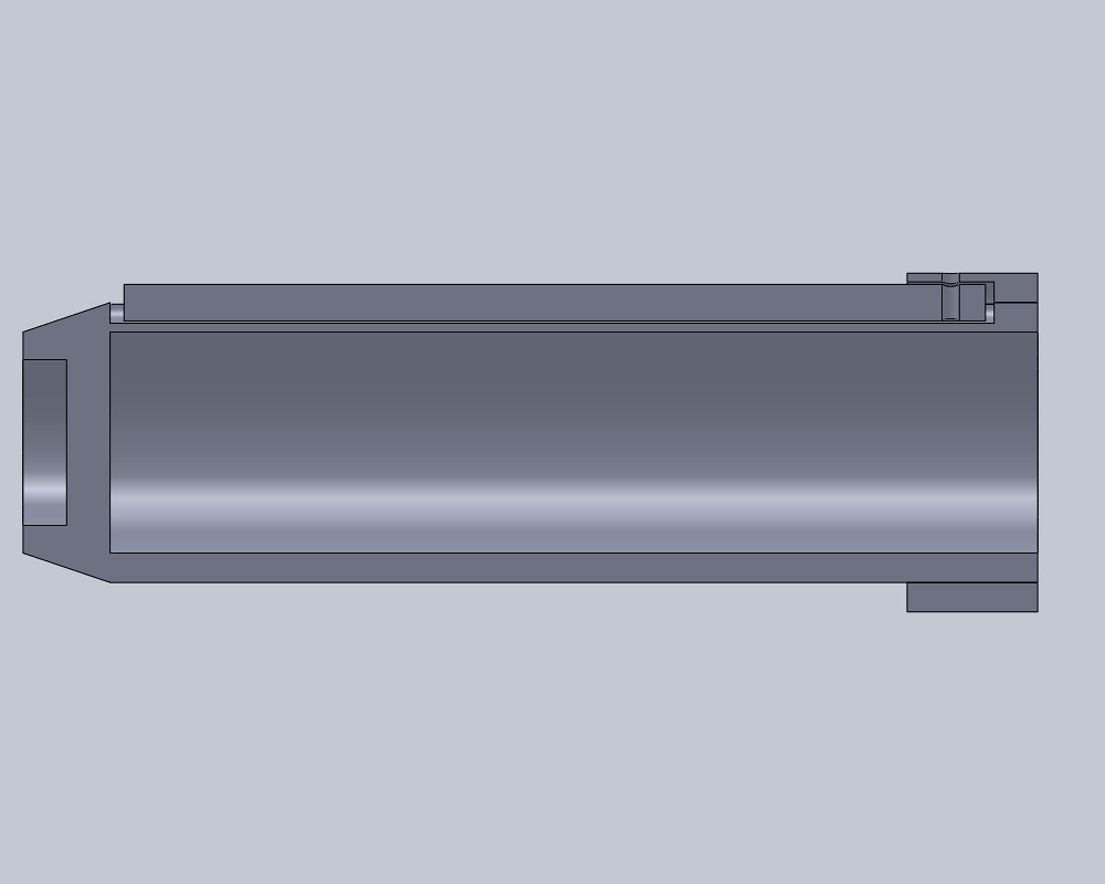

I dunno guys, I am kinda put off on this idea. I mean the firesteel kit with a capsule on the end of a firesteel seems like two things to me. 1-Played out. 2-Not Becker style. I mean if I have this metal capsule, and it has a little rod sticking out the end of it, and it is only .5" deep into the tube, I really feel like there is a chance that if I fall and land on this thing it could snap the steel right off. If we epoxy the firesteel into it, you are out a whole kit. Even if it was attached in some other manner, like a through-screw type thing, it would still I think suffer from this rather glaring weakness (IMO).

Why not all of the above? Here is my idea, in rough form.
Okay, so we have a capsule that is about 4.5"~5" long. At the tip is an indention to hold a button compass, whatever. Then we have the main tube. Down one side of the tube a half-round channel is ground, that is 4" long. At the other end of the tube, the open end, we have a small lip that is about .25" deep. Fitting over this end we have a small sleeve that will only slide on one way over the open end, and has a hole milled and tapped to allow a small set screw to go through the outer sleeve to hold the firesteel in place. Around the circumference there are other holes that allow other small set screws to go directly into the main body of the tube itself, holding it into place, and helping to stabilize as well as secure the firesteel. Then the open end has an internal thread, and the cap (which I didn't draw) has a thread with o-ring to seal it all up.
The exterior of the main tube could be knurled however it need be done, the firesteel wouldn't be sticking out and in as much danger of breaking, could easily be replaced, and the whole thing would be tough as nails if done in steel. Plus you could toss a button compass in the end. Tons of storage, heck, you could even put a small allen wrench and extra firesteel in there if you felt like it.
And yes, after looking at it here, I realize it looks like an uncircumcised penis. Thems the breaks.
Like I said, rough idea, the measurements are all kinds of off, but you get the idea. Also the firesteel would fit the groove exactly, I made my demo firesteel in the drawing smaller to show the groove detail and whatnot.

Good idea and it's somewhat different from the rest. :thumbup:
We could call it the Becker "Dick Firestick"... :D
The only problem with that is how the hell do I drill the side of the shaft to add the firesteel.

Drill hole lengthwise then remove the rest of the stock until it is the right height? I dunno.
Good god man, I am a computer nerd, not a machinist!
