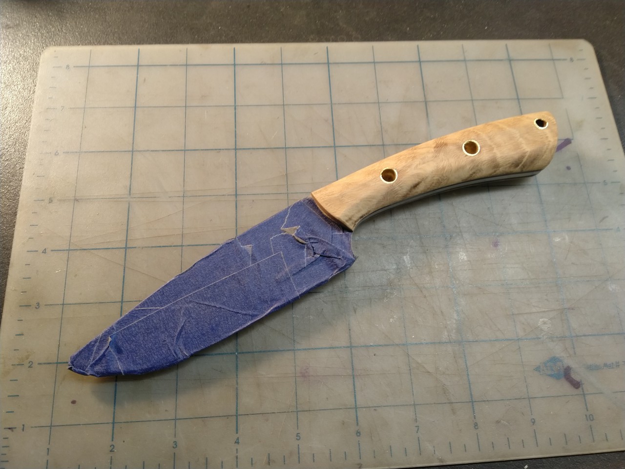

Anyone have a simple home DIY method for this? And what I will need to accomplish darkening the logo after deepening it? And what is the ratio of the solution I should mix to use to deepen the etching if anyone has the specifics before I do a trial and error approach?
AC will darken, DC will etch. Tho you do want to make sure you get your DC direction correct. I believe the positive terminal goes to the tang, and the negative on the contact touching the etchant/mark. I do not know what AC voltage is appropriate, and you almost certainly don't want to put 20A thru your blade.
Or you could just etch it deeper, fill it with some paint or nail polish, and then sand off the coating.
Or strip it all, then put some color in the mark and wipe the surface clean. Don't have to get too technical. Also don't have to darken it at all - light hitting it differently because of the relief will leave it quite readable.
