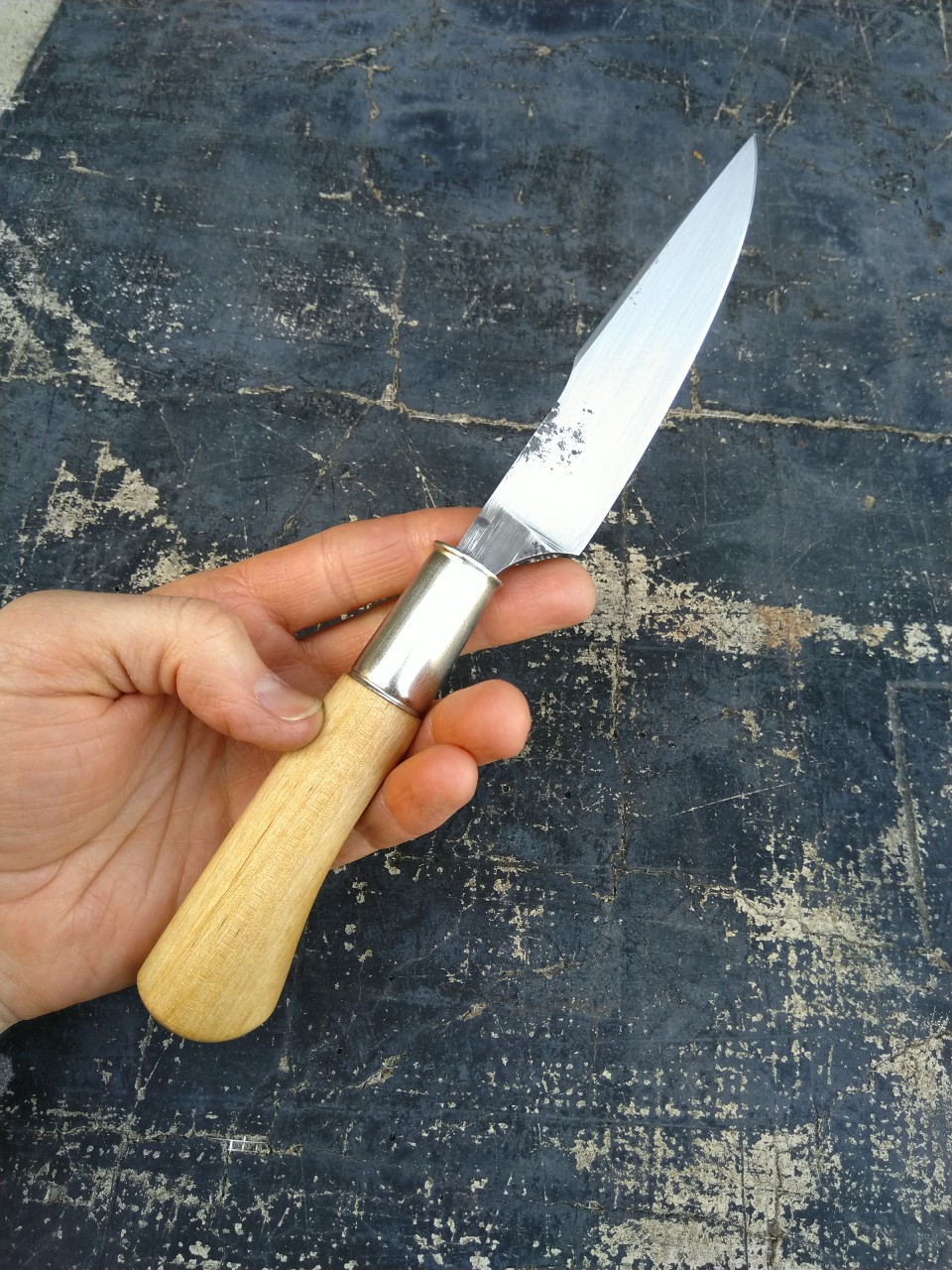

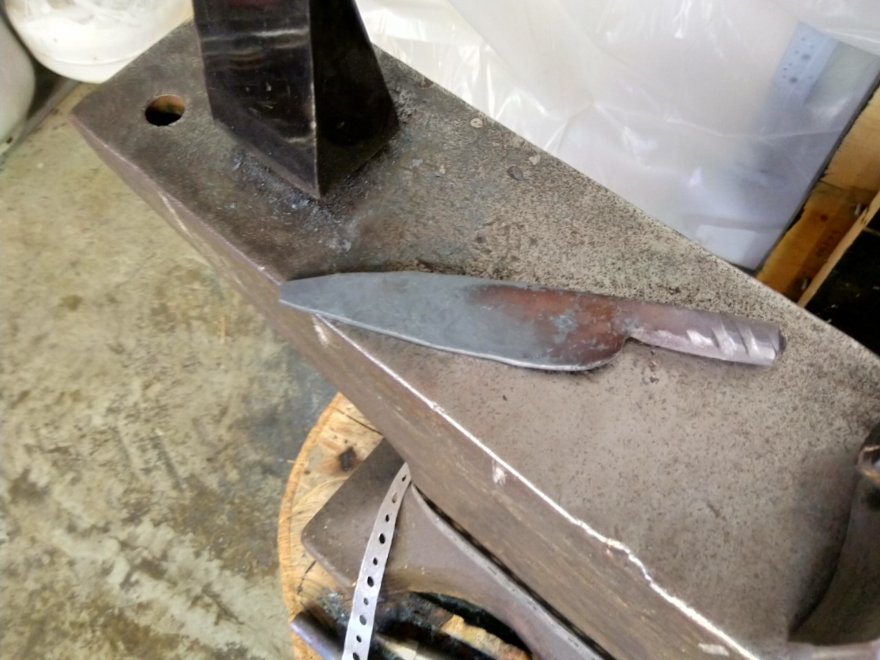

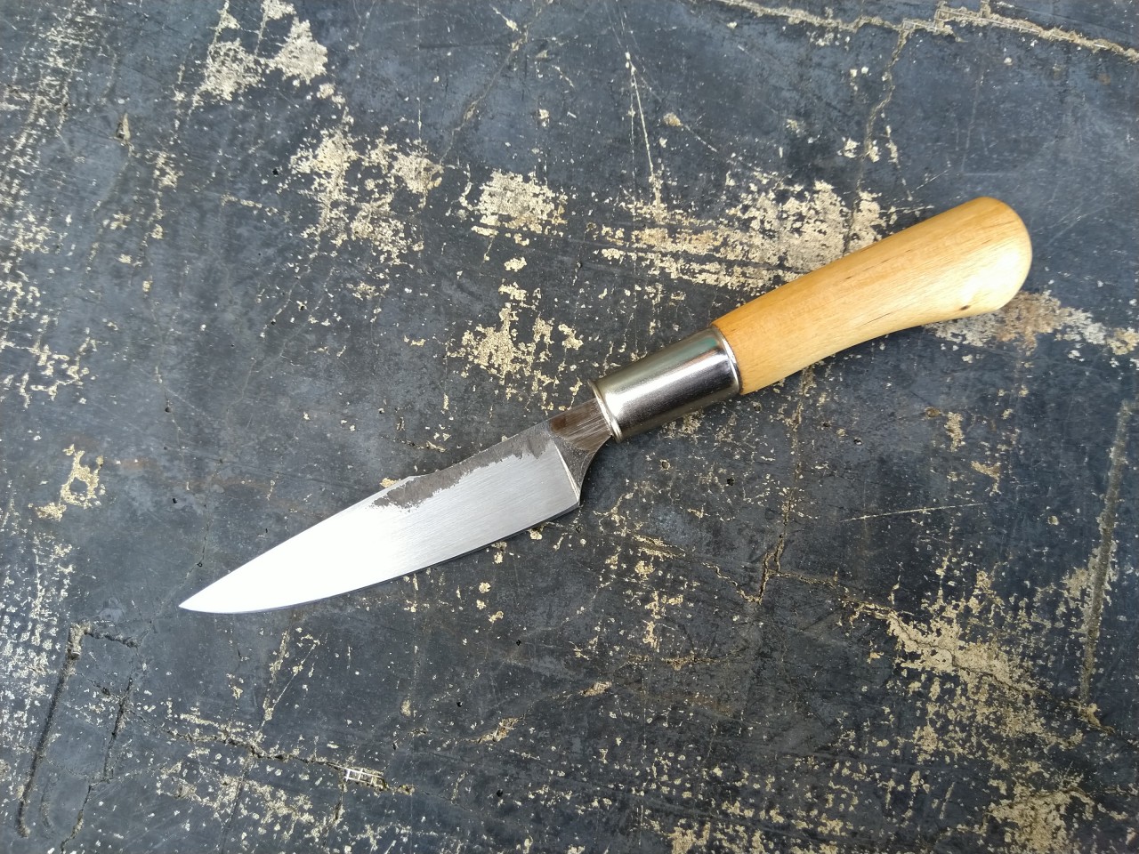

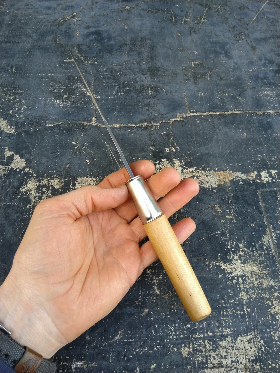

This weekend's ill-advised detour: a knife forged out of a piece of grade-60 rebar (purchased new and marked), just to see how hard it would get, and shoved into a Nicholson size-E file handle.
Verdict: 55Rc out of quench and after 350F temper. It will cut. But not for long. ;)
Cute. And keep in mind, there are a lot of companies that still aim for 52-54 RC
True enough, and it's far from useless. It might cut like a Condor, for instance. But I can make a better-cutting blade with salvaged coil springs.
However, if my forge was long enough (don't have a place for coal), I'd consider beating a section of this rebar into a narrow light brush sword that might handle a little better than my hardware store Colombian machete. Good hardness for that. Next time I'll flatten out a little section and do a break test or two to see how tough it feels and to look at the grain. Might be better for small digging tools and the like. Probably too much carbon for tongs, which end up getting dipped in water a lot to cool them off. But maybe not?
I bet it'd work fine for a machete. For tong handles, you could wild mild steel jaws to it.
