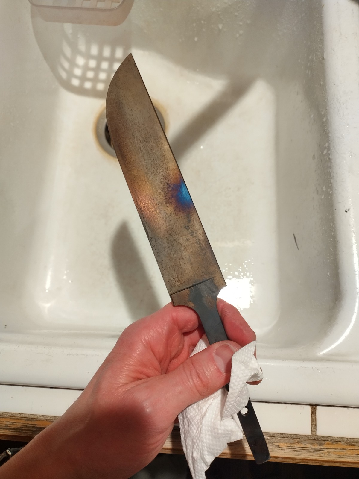

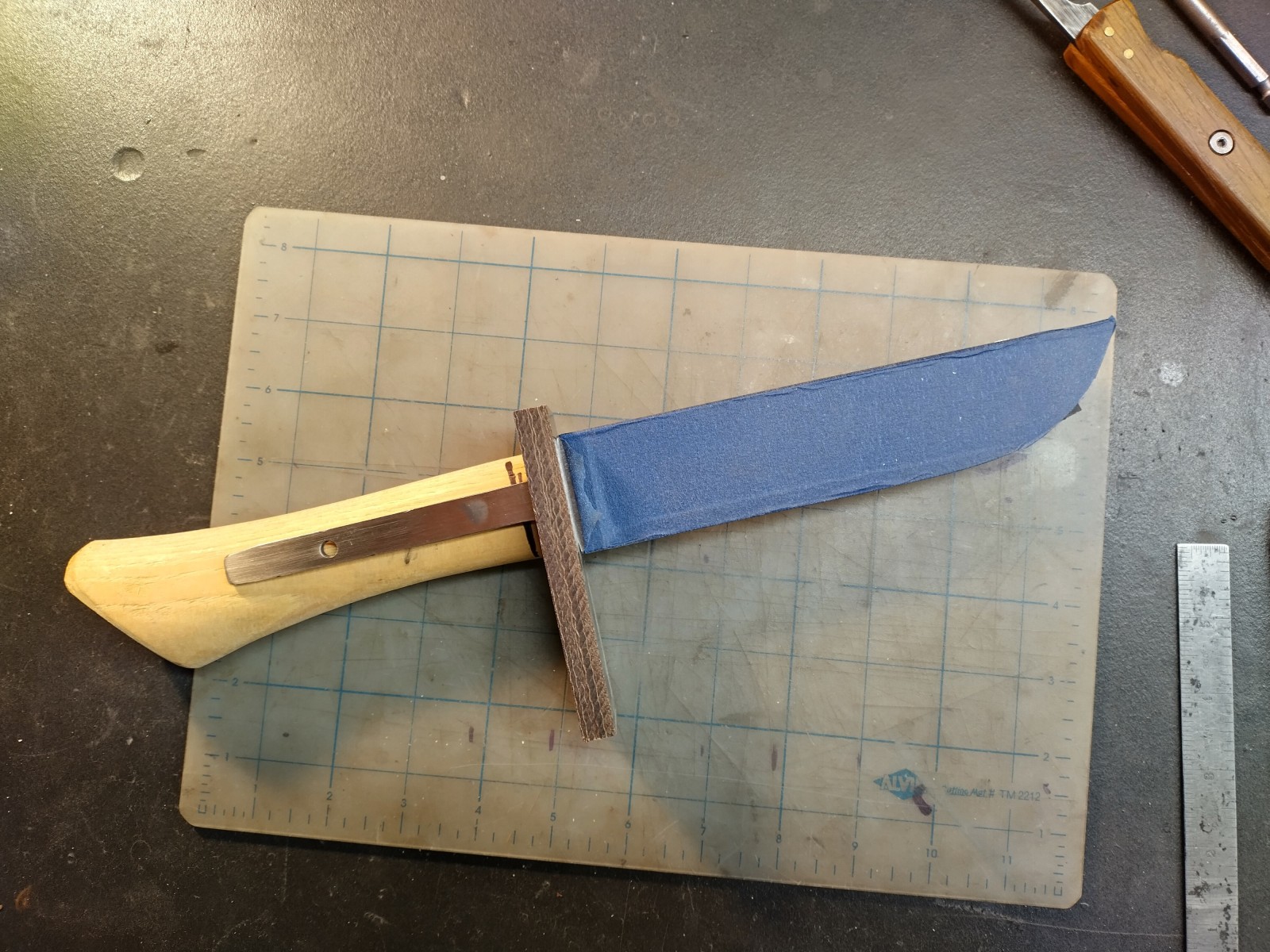

Last night and this afternoon I worked on the American Leuku. It really is too big to heat-treat in my little forge for reasons, but it got good and hard and I managed to straighten the inevitable bend. Once tempering is finished, including drawing the spine a bit with a torch (edge in water), I'll whack it on a log or something to make sure I got it right before proceding:
