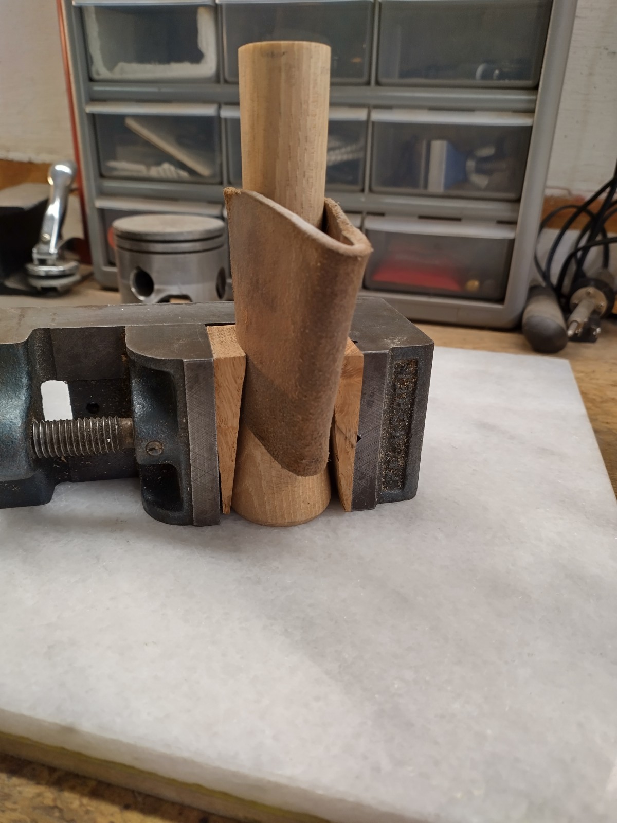

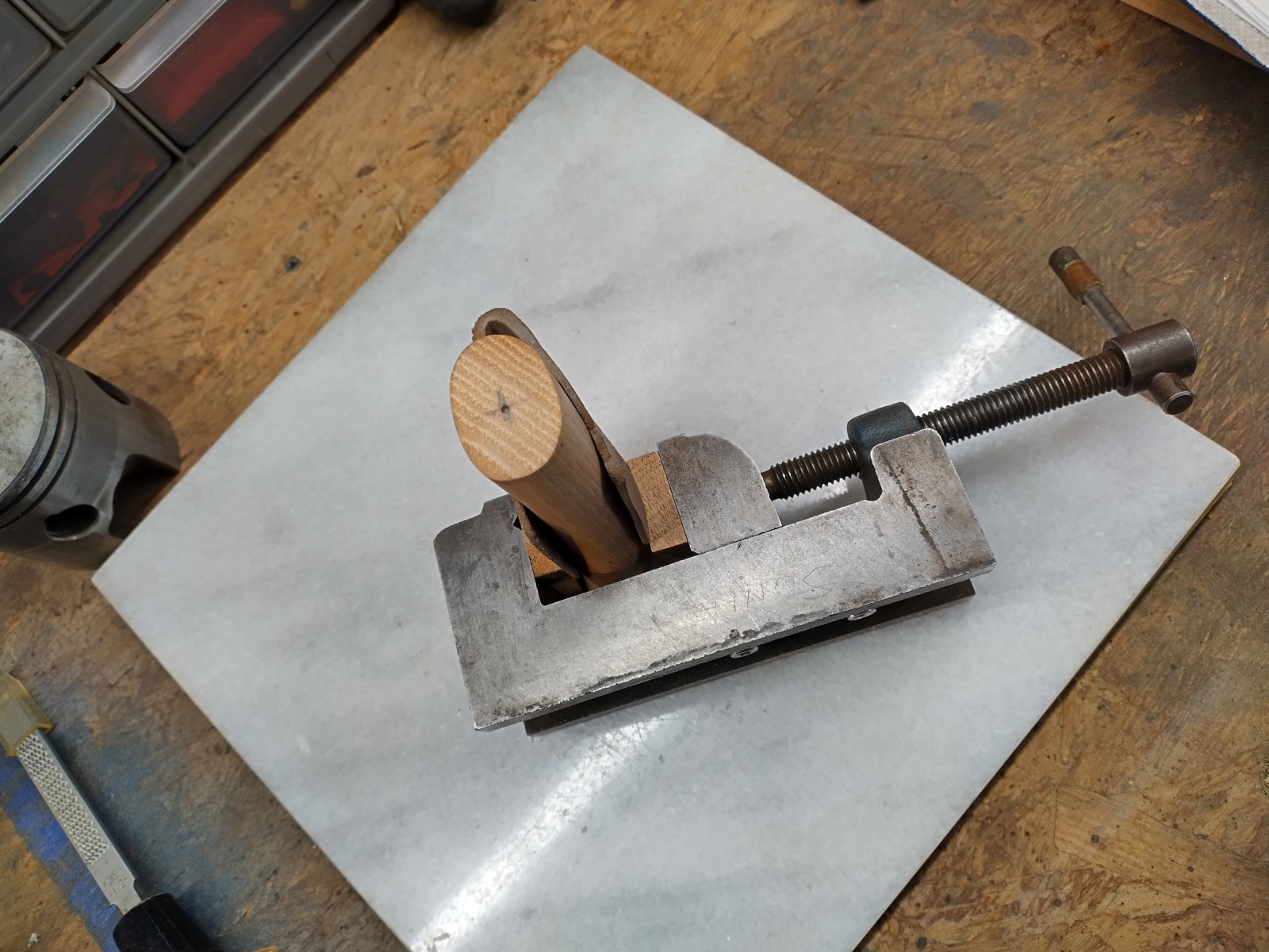

How difficult was it burying that tang into the existing handle?
Marking, drilling, clean up, etc with the existing curves of the handle I imagine is tricky
*lol*
yes, yes it was.
And that tang is 4.25" long, so it's IN there.
When I got to that point I remembered what a pain it was the last time...
I drilled a 3/8" hole and then broached top and bottom key slots. Then squared up the face. Good thing I made a longer broach a couple months ago too!
I made a couple clamping wedges with inside curves and used my ubiquitous folded piece of leather as a buffer. It was enough of a trick that I took pictures at the time to remind myself:
I might try shaping the next one, or doing a test handle on some scrap.
