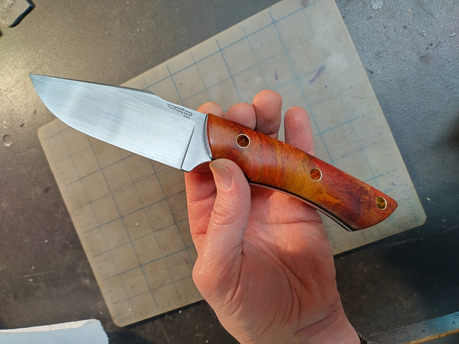

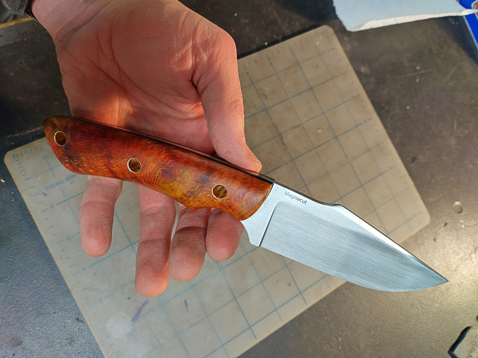

Last one for the weekend show, not quite done. This is just off the grinder. I hit it with some BLO for a preview. Hopefully I can keep motivated and get back over there after dinner to sand it out properly. I hope it turns out. It's like flamboyant love child of BK-17 and BK-18 w/ just a bit more handle:
