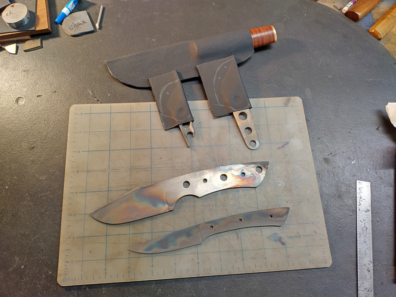

Heatin' and Squeezin' today.
All those holes in those two magnacut knives at the bottom? DEFINITELY drilled pre-heat:
