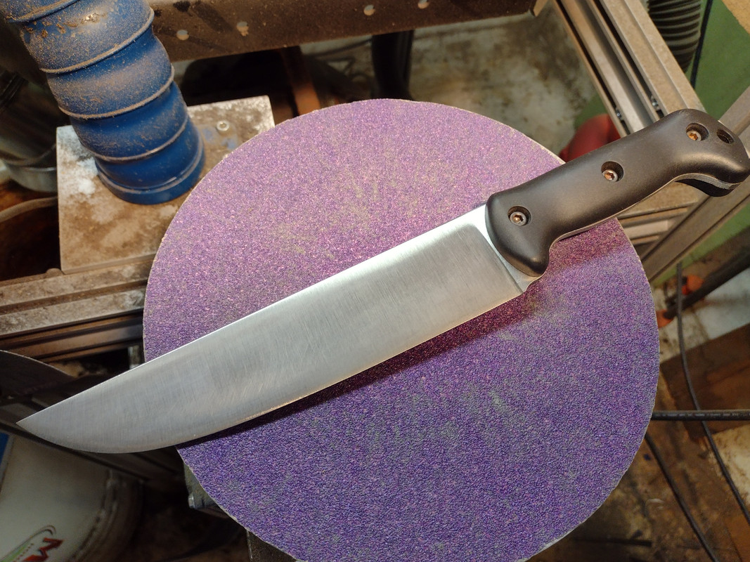

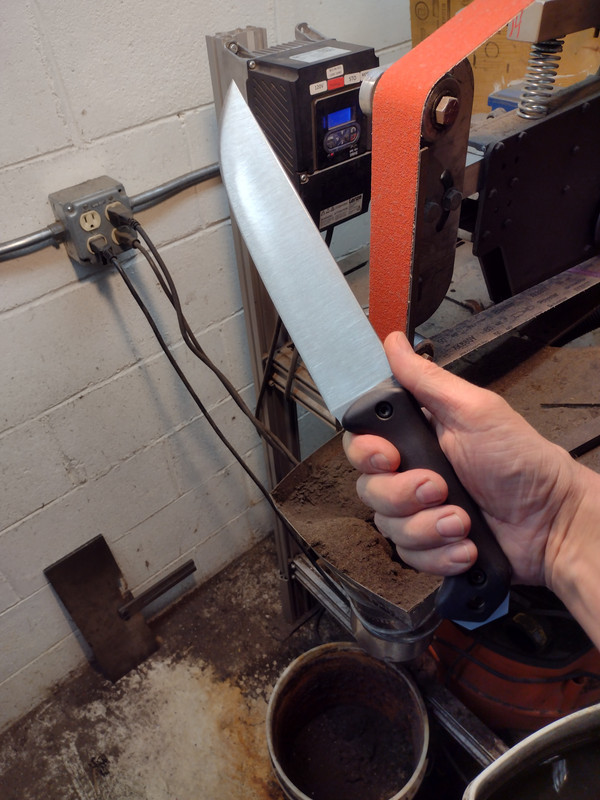

I have been dealing with some health issues lately so I haven’t been taking on many custom orders. Perfect time to make a new knife for myself, something I rarely have time to do nowadays. Anyone who knows me knows that I love big blades, so using my old BK9 as inspiration I decided to make kind of a mutant version lol.
This bad boy is 17 inches long, 1/4 inch thick 5160 with a full convex grind, no swedge and an added finger choil. Still got plenty of sanding etc to make it pretty, but you get the idea 😈😈
YOU'VE MADE A BEAST-K2!!
Well done.

Sick!
Haha. Great name 😈😈
I don't recall who coined that term, but I think Dubz had a pretty good rendering of one, and you've come very close to that (straighter clip, FFG vs. saber, add choil).
