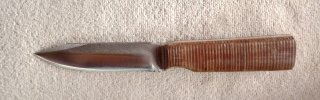

Held an impromptu knife making class with the neighbor kid Friday night.
I did one side modeling the steps, and he did the other side. Then I did cleanup and added handles with the material of his choosing.
4.5" long blade, just over 8.5" oal, 1" tall and ground out of an old file with frequent quenching in water whenever it got uncomfortable to the touch.IMG_20240707_094314499_HDR~2.jpg
The handle is a cutoff from a veneer glulam with micarta spacers. he wanted the stacked washer look in a synthetic material

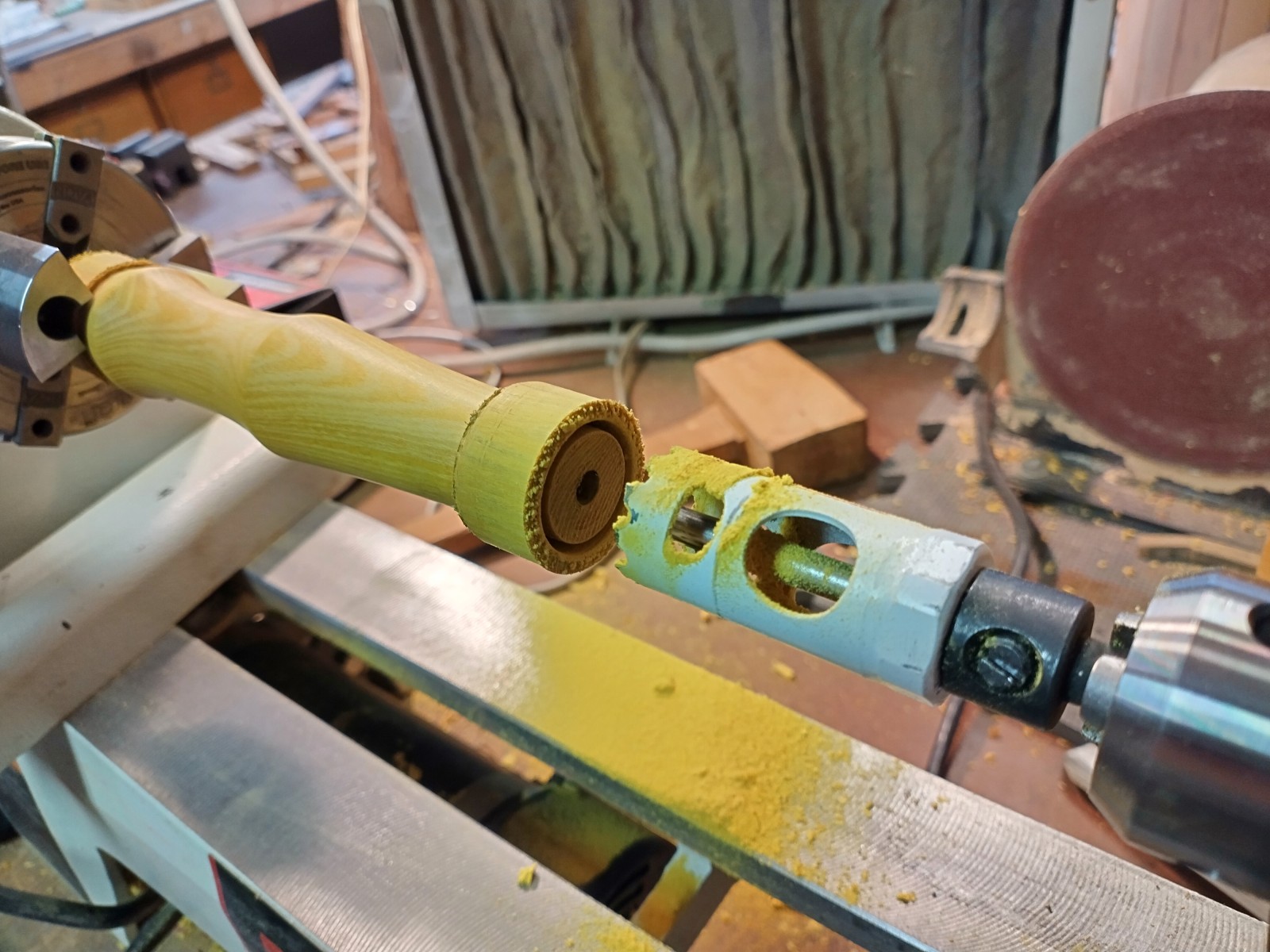

Still gotta do some hand-sanding on this handle, but the preview is looking pretty good:
This worked better than it had any right to.
I started with the regular barbed center on the drive/chuck-end, turned a tenon to grab it by later, and most of the handle shape.
The grab-tenon (vs. the collar/tang tenon) turned out (har-har) to be exactly between the capacities of my big jaws and pen jaws, but I made the pen jaws work. Lesson learned.
Then I drilled a 1/4 hole through the tang-end with the tailstock chuck, including through the leftover chunk that would be discarded (drilled through that because it had the live-center's hole for reference!).
Used a bit of 1/4" stainless tubing as a guide in the hole saw because it aligns coaxially with the hole saw, unlike my drill bits, interestingly. I should have left the tubing another 1/8" longer, but it worked!
Then used a drill in the tailstock chuck to support the end of the piece as I cut through the waste collar to reveal the tang-end tenon.
