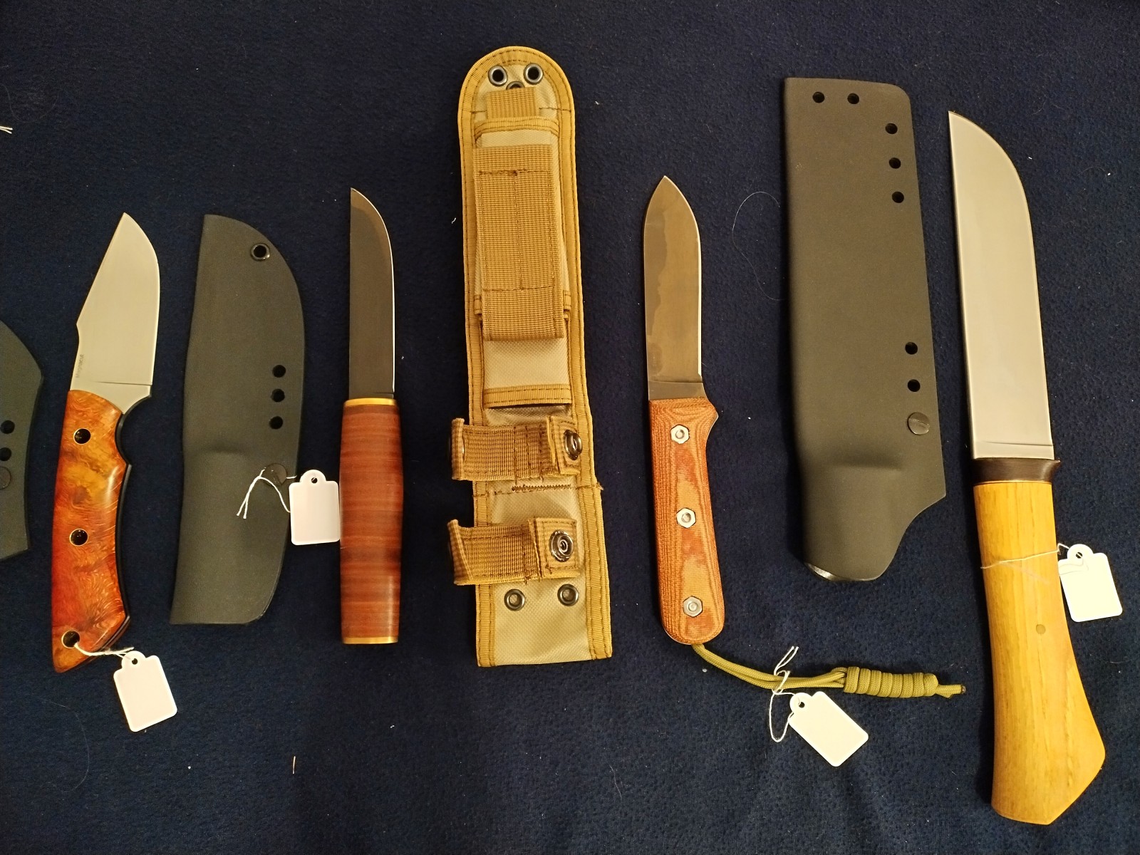

Lousy lighting in the "layout room", but here's a sample of what's going on the table this coming weekend:

Question on the BK-62 lanyard! How did you attach it?
Thanks!

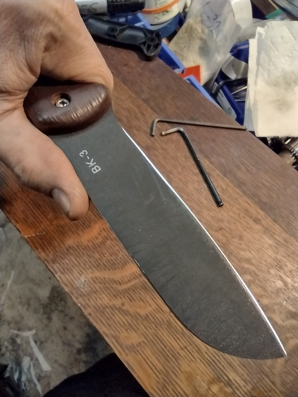

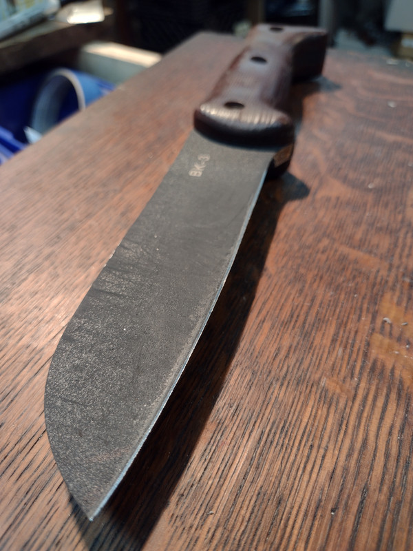

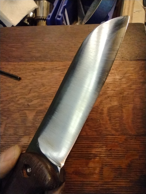

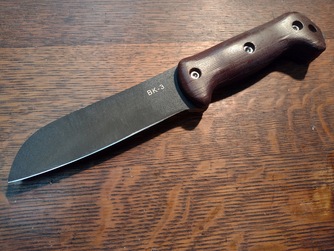

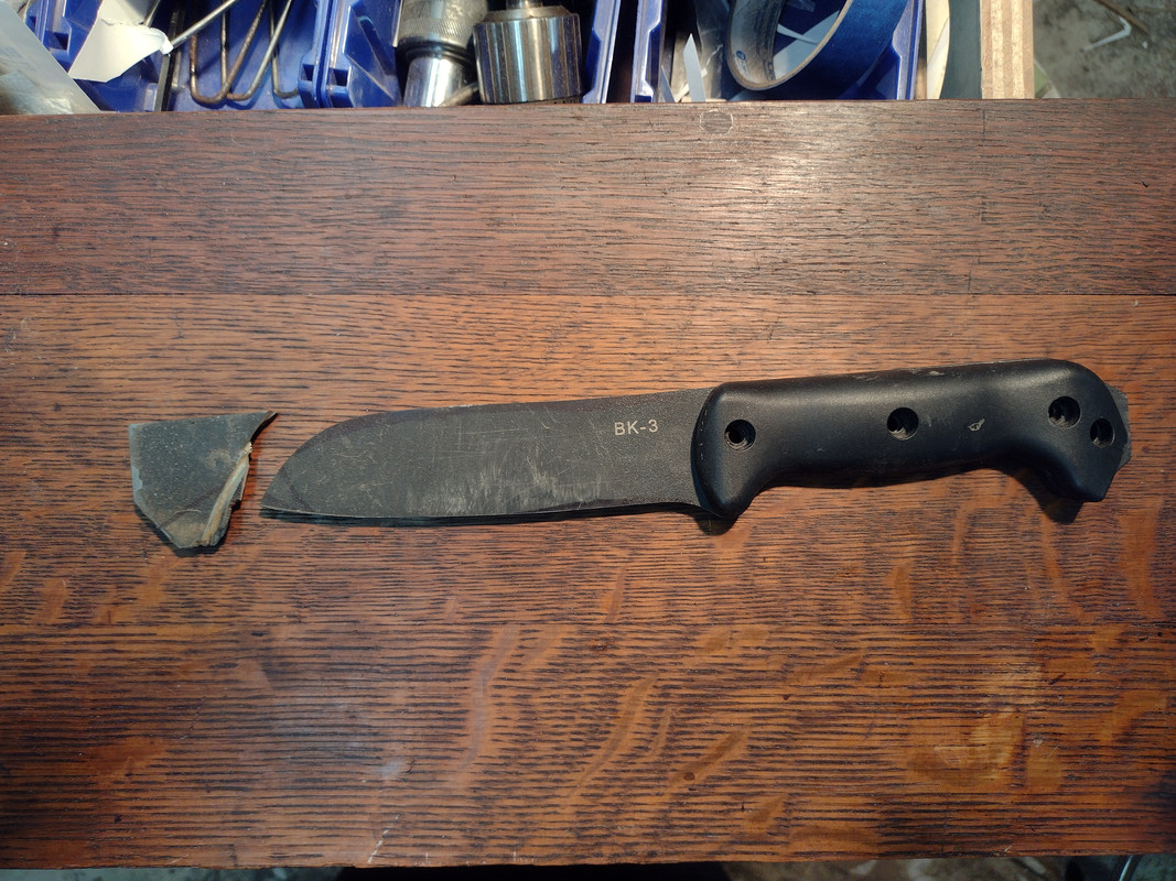

Been awhile since I played with any Actual Beckers.... This one always bugged me, idk what it's Supposed to be? So I gave it more identity.
Since I don't otherwise have anything 1/4" thick, and I've been jonesing for them to come out with a new design using the original scales ......

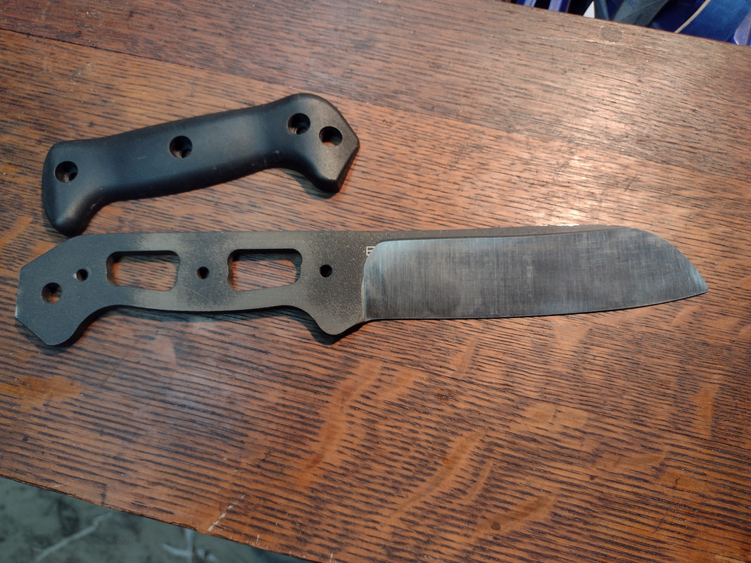

How about a modified sheepsfoot?
Yes, I'm keeping chisel.

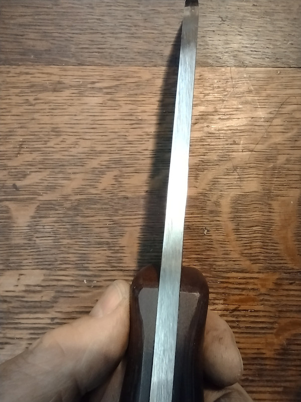

Lately my personal EDC is a chisel grind, and I kinda like it. Might be Fun for a good Beater knife...... I'm calling it a "Hacking Knife". Like they use in the trades.....
Update: 3:00pm
I’m pretty sure that not a BK62, that’s a daizee daizee custom that uses official scales.
P Plainsman
That's correct.
I drill a 1/4" (or is it 3/16?) hole through the tang between the butt and the rear-most bolt-hole. Then I drill a 1/4" hole directly into the butt-end of the scales, about 3/8"-1/2" deep, centered on the seam between the scales (bolted together in a drill vise - tricky operation!).
Then you can put in a lanyard with the scales off and bolt them on top of it, with each end coming out through the slot in each scale.
FWIW, you could do this with a production BK-62 by softening the butt with a torch so you can drill the hole. But dear FSM, please make sure you don't helicopter a sharp knife at your hands while doing that. (dull and/or tape the edge, use a stop on the table, clamp if you can, and drill with the LEFT side up so IF it breaks free it will spin spine-first)

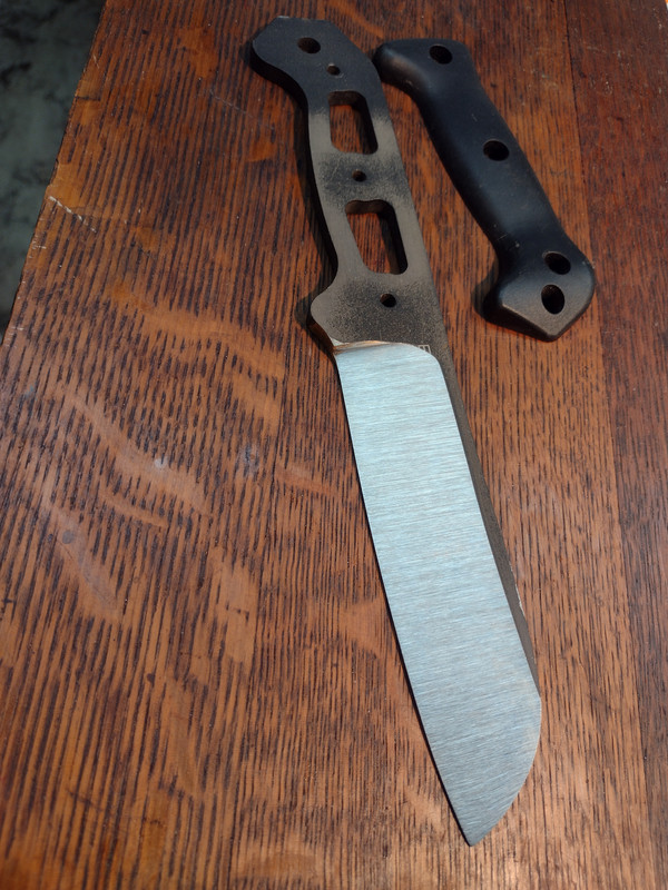

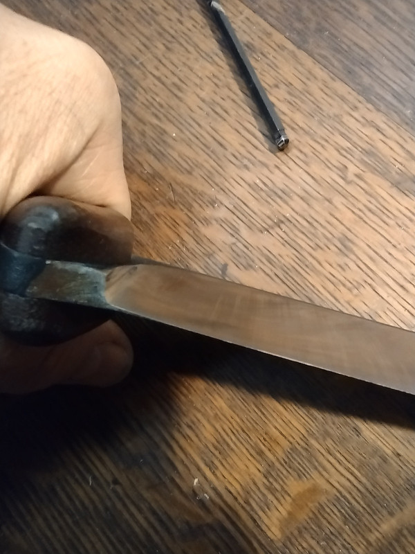

Not quite done yet.....
Still need to clean up my bevel (one bevel) and finish my edge, but it's just too Fun not to play with it early....
Ballance and weight feel so right.
This Should be a Thing.

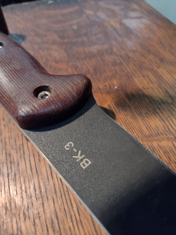

I am planning to customize my unstripped BK16 blade by having a professional laser etch a few small symbols for me. I have this question about the factory logo and model number laser etching. When these are etched, is the spot left completely vulnerable to water and rusting? Or does it have a protective light patina right from the factory? I’m wondering if I need to take extra steps to seal the new etchings or if they will be fine as is.
Apply paste wax over the laser etching and it'll resist tarnishing better
Clear nail polish and super glue work, too, but if you're going to use the knife for food prep I don't suggest using them

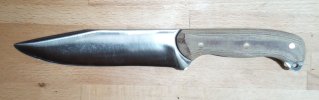

Bro thats your blade shape, I just had an idea once, you made it happen. I appreciate the credit but its all you man, you made the thing work and happen. Love that knife though. You make it so so good.
Team effort deserves team credit. :)
I still use a version of that original PDF you sent me, though in the near future I'm likely to adjust the handle shape on that and one more blade pattern "permanently", vs. a one-off. I'd like to get it a bit more here (tho this one's a bit overly thick, IMO):
