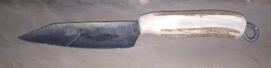

lit the forge around 11:30 this morning, gifted the below around 4:30.
started with a 1/2" thick x 1.5" diameter puck of 1084.
5 "+ blade, 4.5" axis antler handle, 1/8" at the spine, tapered tang. didn't see the scratch until the flash went off. :(
the pic is horrible - i left the as quenched finish because it's almost royal/carribean blue.

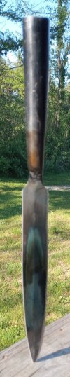

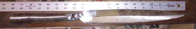

Mid process of a new spearhead - from the male end of a scrap of 3/4" sucker rod
Finished forging just after supper.
Almost done with cleanup grinding.
Tomorrow is scotch Brite belts, HT, and putting the secondary bevels on it
Spine is .28" for the first 8", then it tapers to not much. 1.5" wide at the base and almost a foot of blade. Unsharpened it punched through 1/2" piece of plywood with not a lot of effort.
Agree, cool looking piece.
Are you going to mount it on a shaft ?
It'll be fun throwing it :D

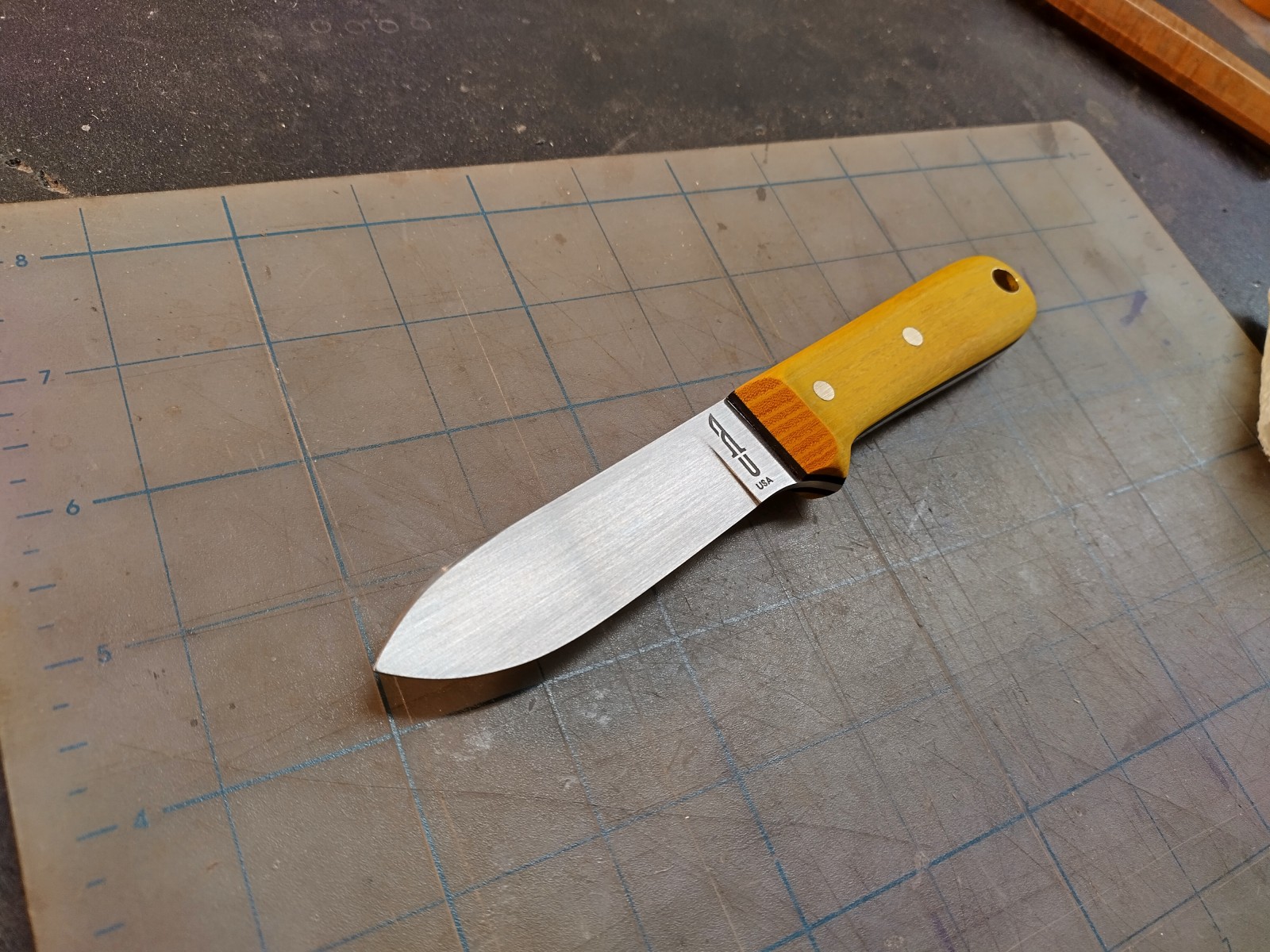

Nothing new recently, but I did just order some of Larrin's new formula: Pop's Procut
Should be a fun alternative to 1084. I got it in sizes for Kepharts and Leukus.
I grabbed 4 bars too....a bunch of kitchen stuff, some daggers, and a couple field knives, plus a few more

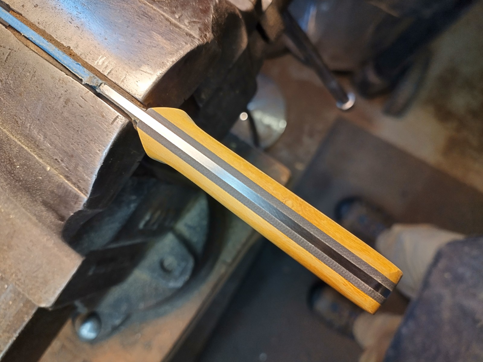

A couple nearly-done pix before the final ones.
The guys who own the outfitters at the bottom of my hill had to cut down a small stand of Osage Orange on their family property nearby. Osage doesn't really grow here in RI, so this is unusual stuff. They milled much of into boards, but gave me a stump! This piece is K&G stabilized - rugged stuff! It's for one of the two brothers, to match his larger AuK4.5. They consign for me and host me for artist days sometimes. Waiting for a request from the other brother. :)
https://www.bladeforums.com/threads/auk-3-5-kephart-in-cpm154-and-osage-orange.2041396/
